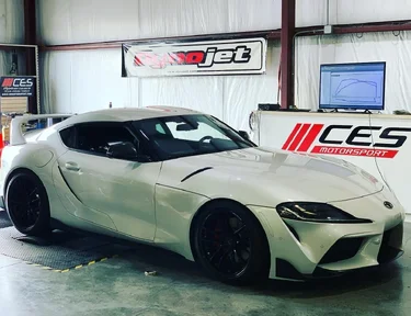

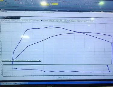

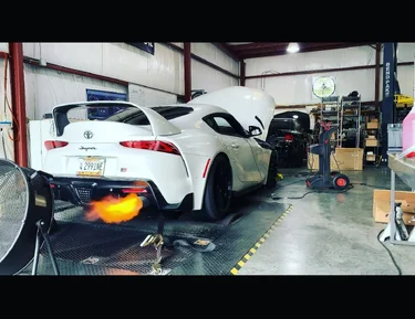

The numbers are in, sorry I'm a bit late to the game. My car made 500whp and 580wtq in ambient temps of about 100 degrees... I'm thinking that once it cools down a bit here where I live in the south, the car should stabilize around 510whp and 590wtq.

Good numbers :thumbsup: Im sure its a beast with that tq. very nice for 93 oct.

great numbers!!!!!!!!!!!!!!!!

Over 500wtq at ~2700 RPM, and stays over 500 for almost 3000 RPM - that's a serious powerband.
