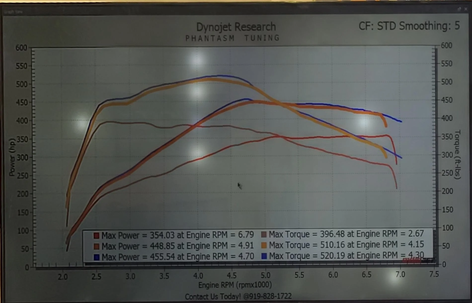

Just had my car tuned on Ecutek running 93 pump gas. I was running stage 2 OTS BM3. I don't have any baseline pulls on BM3 as I flashed the car to stock before it was put on the dyno. I'm impressed with the way the car feels now. The power delivery is extremely refined compared to BM3. The car was tuned by Mike Botti and he was awesome all the way through the process, really down to earth and friendly guy. My mod list is Titan Motorsports catless downpipe, MST Instake, and Boost Logic non valved system.
