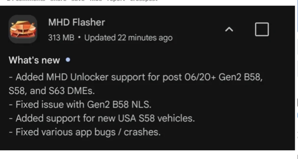

Can’t seem to find this update in apple ios apps…. but support for post 2020+ dmes?!

Anyone know what exactly was fixed with NLS? I am having an intermittent issue with getting torque limit 262144 exactly after using NLS.

Saw on a FB post people complaining about laggy throttle, where it continues to accelerate after letting off. MHD said they fixed that.

Basically NLS was activating when you let off without shifting. So it was like unintended acceleration.
