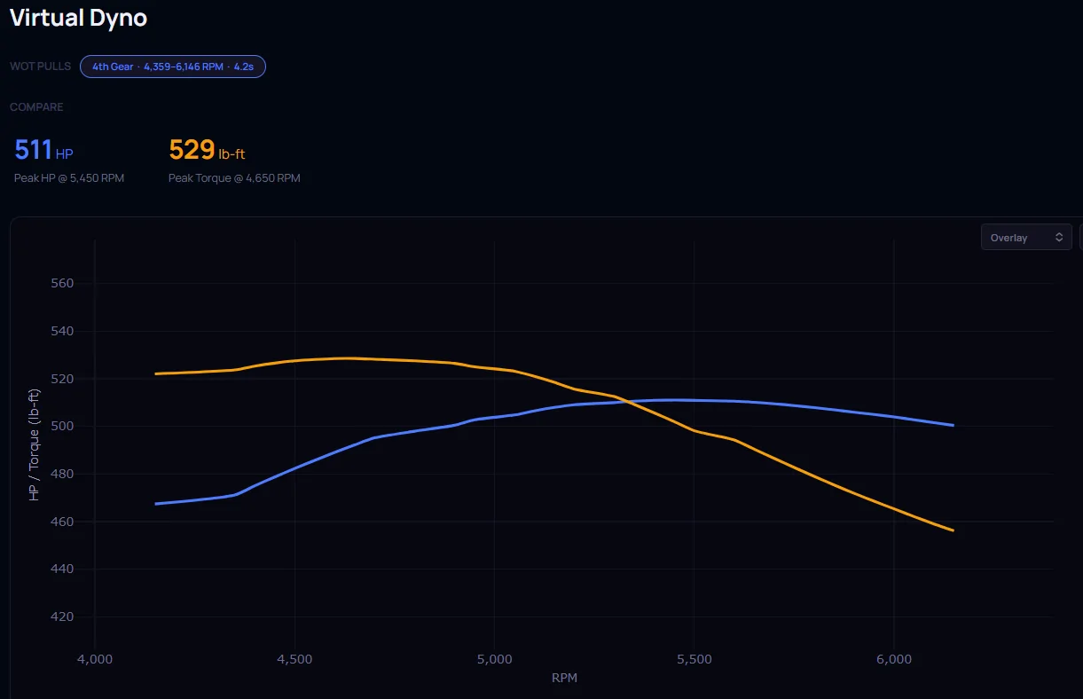

Just unlocked and flashed MHD OTS E40 Stage 2, would anyone more knowledgeable than me be able to check this log and let me know if it looks alright? Car felt very smooth without dropping boost and I wasn't noticing any weird behaviors or getting any codes while driving. I just wanna make sure I'm not missing something alarming. Thanks! (Hopefully this is the right thread for this, I didn't see any MHD/non-JB4 log review threads.)
https://datazap.me/u/jmikes99/logs/cmt236ya10010l406ecduqwpq
Notes: Ambient temp 90 degrees and high humidity. Logged using JB4 (disabled / map 0) + traction control all the way on because I wasn't going to chance it on public roads. Also did a couple of brief pulls where I was messing with anti-lag (I know MHD Anti-lag isn't great and don't plan on really using it much, just wanted to try it for the fun of it)
I will also say that after only 30 minutes of driving with MHD, you guys really weren't kidding, MHD is WAY better than JB4 and it isn't even close.
Log it with the actual MHD app. Can't see anything from trash JB4 logging items and data rate of every other month.
For best logs, you want a clean pull: 100% throttle, from about 2500rpm to red line. Should be about 25~mph up to 100~ in 4th gear. Traction control should be off, you might break traction a bit, but you should be able to keep it straight. Try at night on some back roads. Some place where you can pull off, spin around, and do it again.
Like razorlab said, use MHD's logging. Make sure you don't have any Bluetooth or WiFi connections up aside from MHDs.
Looks good but please log with MHD😂
Looks like you are actually over e40 too. High trims, hpfp drop.
Reset jb4 to default settings(ff/duty all 50) or remove it, looks like its still pulling some wastegate out

Yeah JB4's logging isn't great, I started a log mid-drive with JB4 re-connected on map 0 just to get a general idea of if it's running okay. I'll run a proper MHD log this weekend probably just to double check!
Aye, same process as when I worked with Jesse on my JB4 map; it was just a "oh hey I should log" moment mid-drive with JB4 still plugged in on map 0, I'll log properly next time!
Oh interesting, I knew those settings persisted across maps but I didn't know it affected map 0 too.
I'll run an MHD log next I get the chance, doing a JB4 log was just an in the moment thing once the initial excitement passed haha
