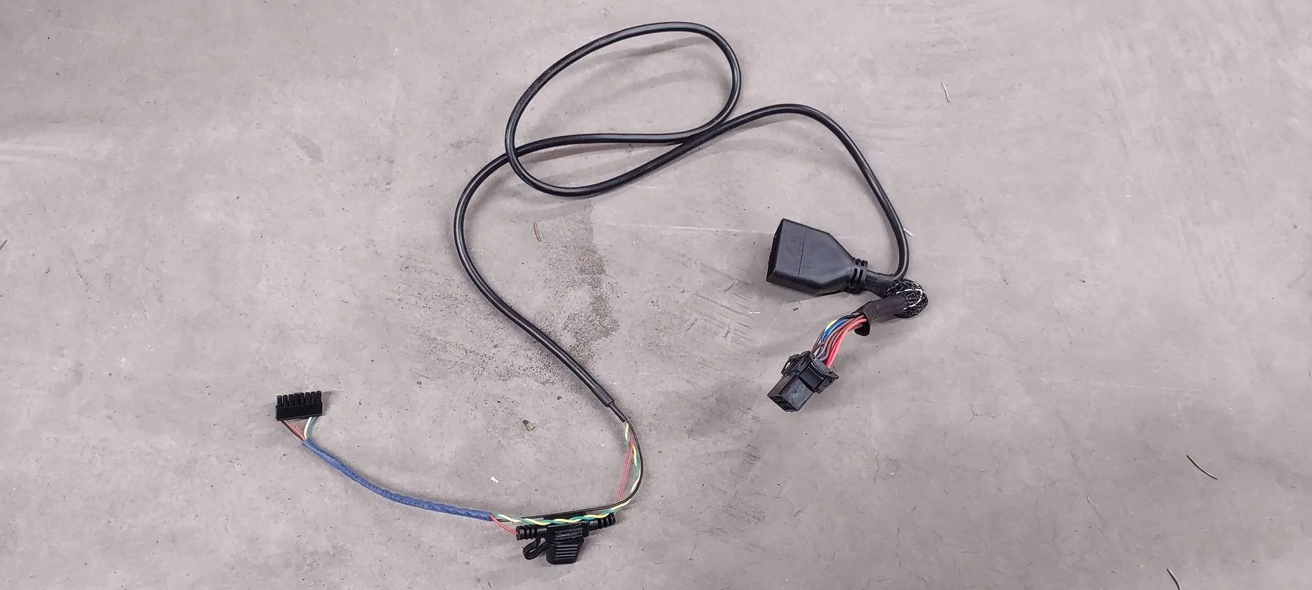

Heres pictures of mine I found today, directly plugged into the OBD Port. It’s the same exact cable from the video that was posted earlier. I’m definitely going to have to remove the panel to get it off. I’m so fucking annoyed.

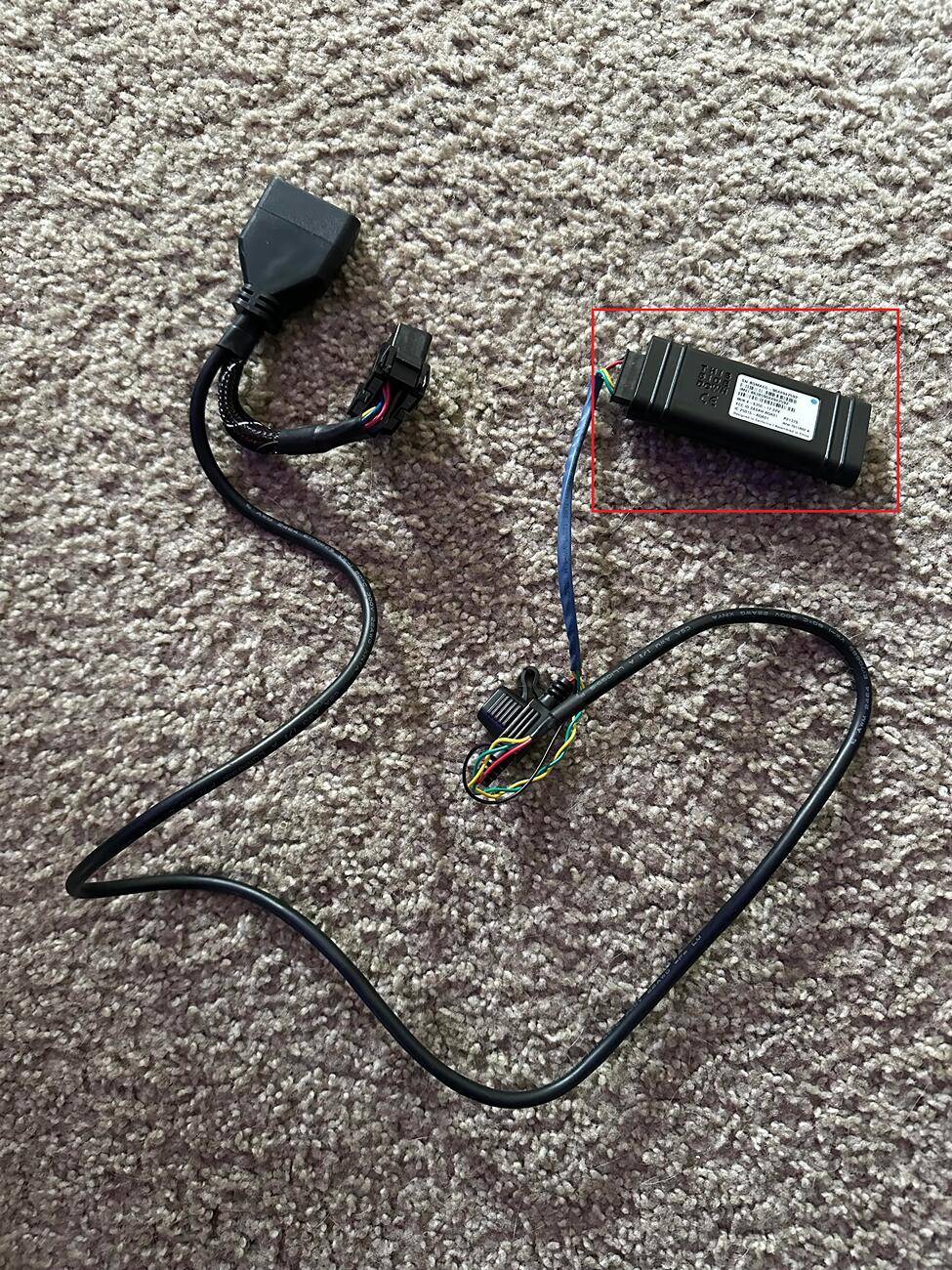

I looked at my OBD port today and noticed there was already something plugged into it! I took off the plastic panel above the pedals and was able to remove what I think is a cable for a GPS tracker:
...but as you can see, I wasn't able to reach far enough up into the dash to remove the plastic box that houses the tracker, as seen in this picture (highlighted in red):

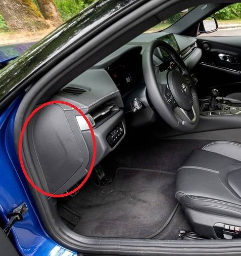

I thought my best option was to remove the dashboard side panel (circled in red) or unscrew the airbag in the driver's footwell. I may just leave the tracker box up in the dash unless it starts rattling. Does anyone have other suggestions on the best way to be able to reach up into the dash?
