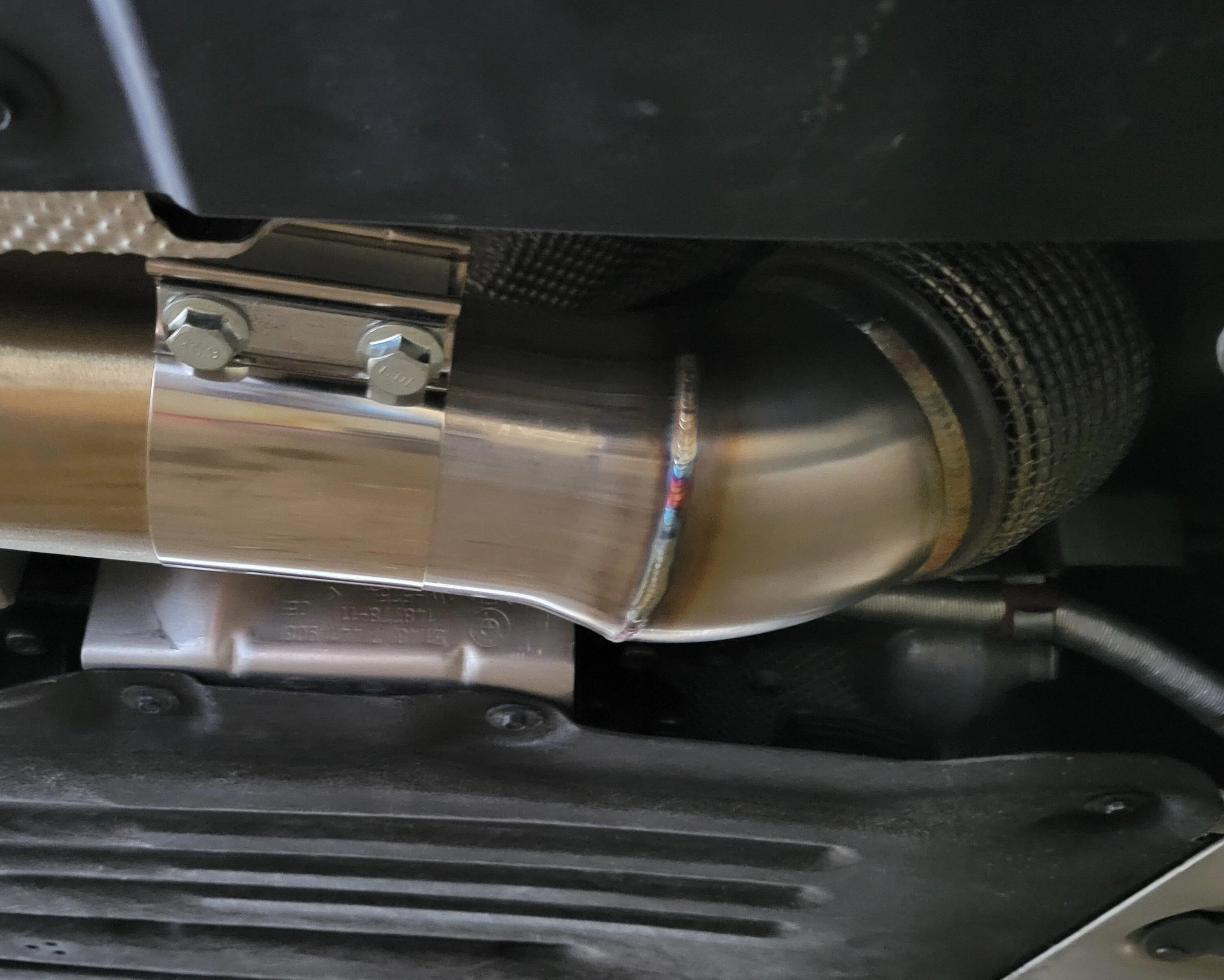

¹Well, just installed DAWs 3.5" exit DP. Overall I'm very happy with it and the exhaust. Very easy to join exhaust to DP. Just cut the injen exhaust's inlet where the 3.5" piping starts. There was about a 1.5" gap from it and DAWs DP, so a 3" long 3.5" exhaust clamp did the trick. Slightly lower tone over 3.15"DP. EGTs are 100+ degrees cooler and 60-130 is .3 second faster over stock exhaust and 3.15" 200 cell DP.
