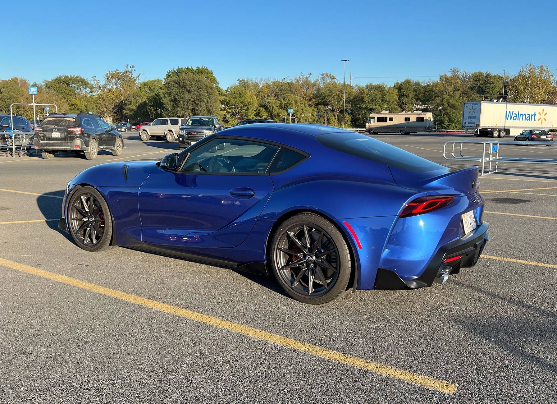

Just installed these on my 2023 MT. Ride height is perfect and there’s no noticeable change in ride quality.
Also for anyone wondering, quickjacks still fit under the car just fine. I was slightly worried about that before installing the springs.
About 7" clearance from the bottom of the front bumper and 4.5" from the bottom of the side skirts

Looks amazing like this!
Did you order the same part number: E10-20-046-02-22? (since you have a MT)
Also, did you cut your bump stops?
@Andrew4Supra thanks for sharing this info!!
