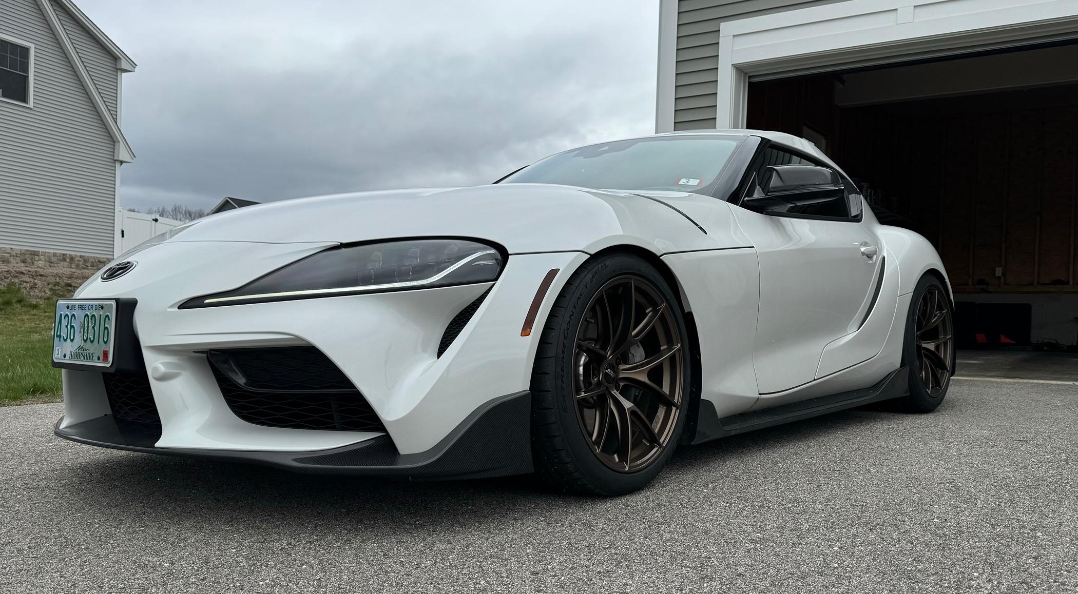

Installed the Eibach Euro springs on my 23 MT as well! Love the ride and a great OEM+ moderate drop.
I recently did whiteline springs on my 2023. While I swapped wheels as well, I feel like the stance is close between the two. Have my best comparison photo here.
Timmy_Jones
Tim
Jan 8, 2023
64
1,418
1,614
NH
23’ 3.0 Base
Very similar! What lip kit is this?
Agreed! I was torn between the two kits and seems you can’t go wrong!
Cheap eBay CF kit. Was like $190 shipped. Best fitment I’ve seen. I must have lucked out. :)

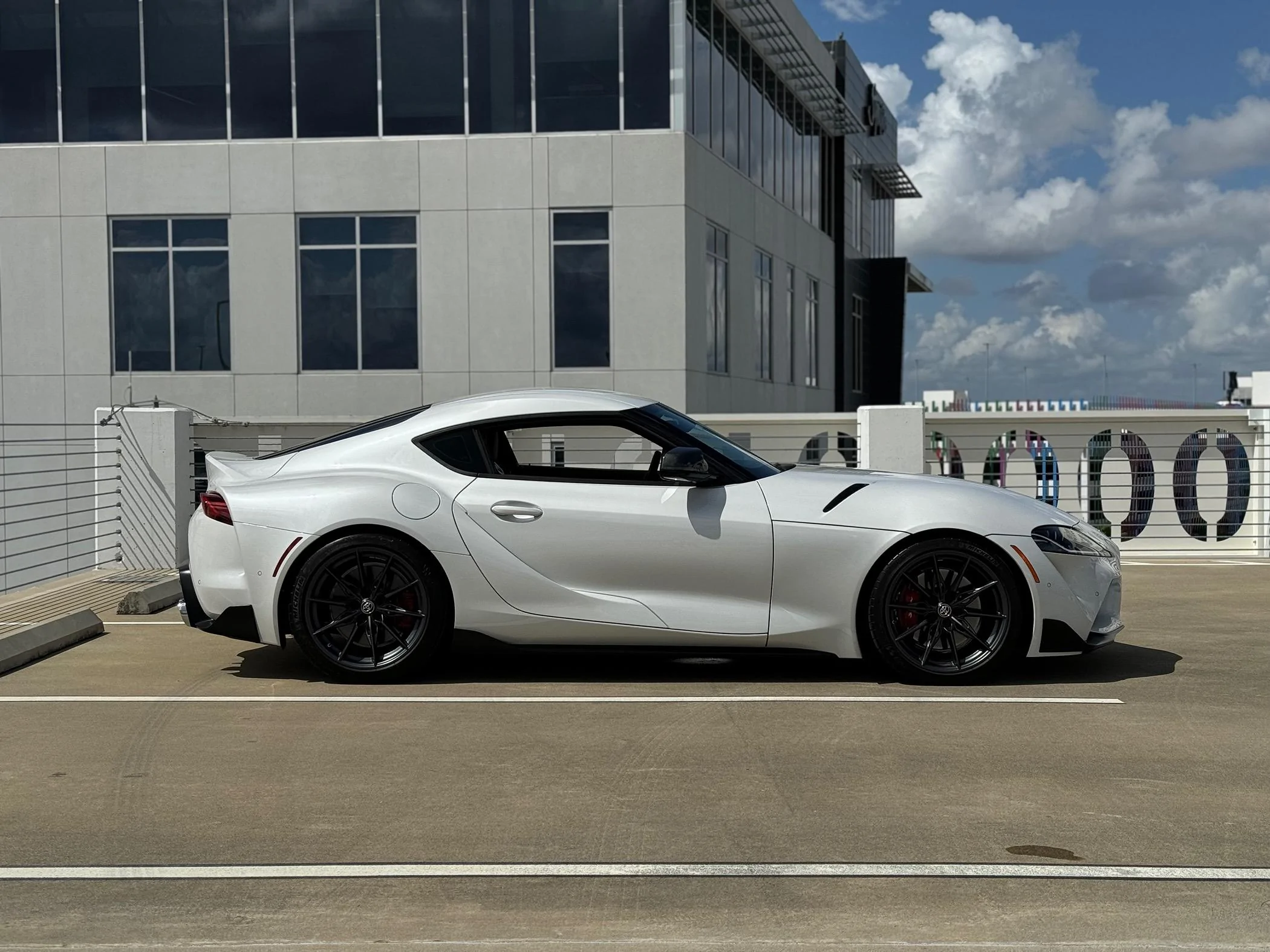

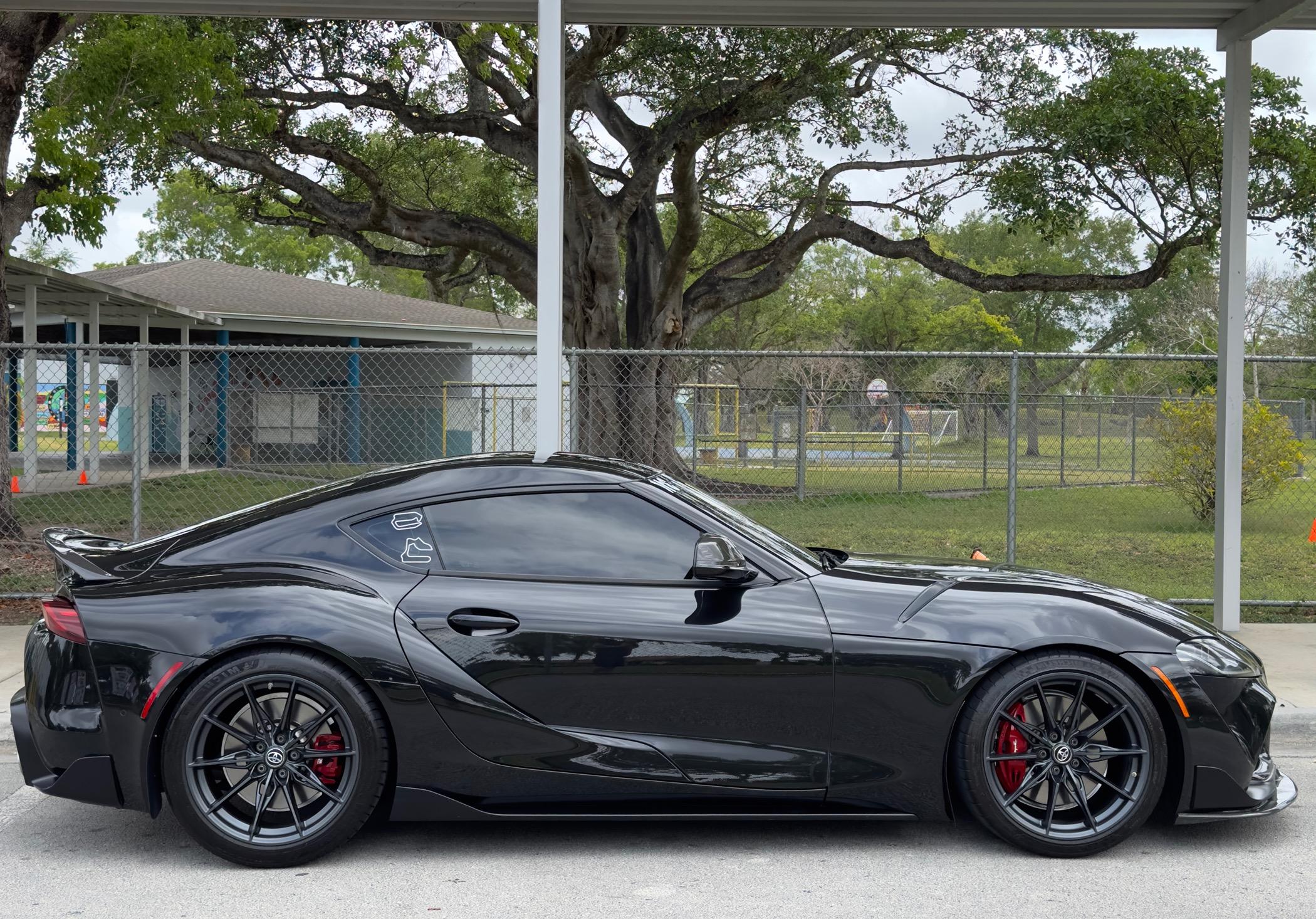

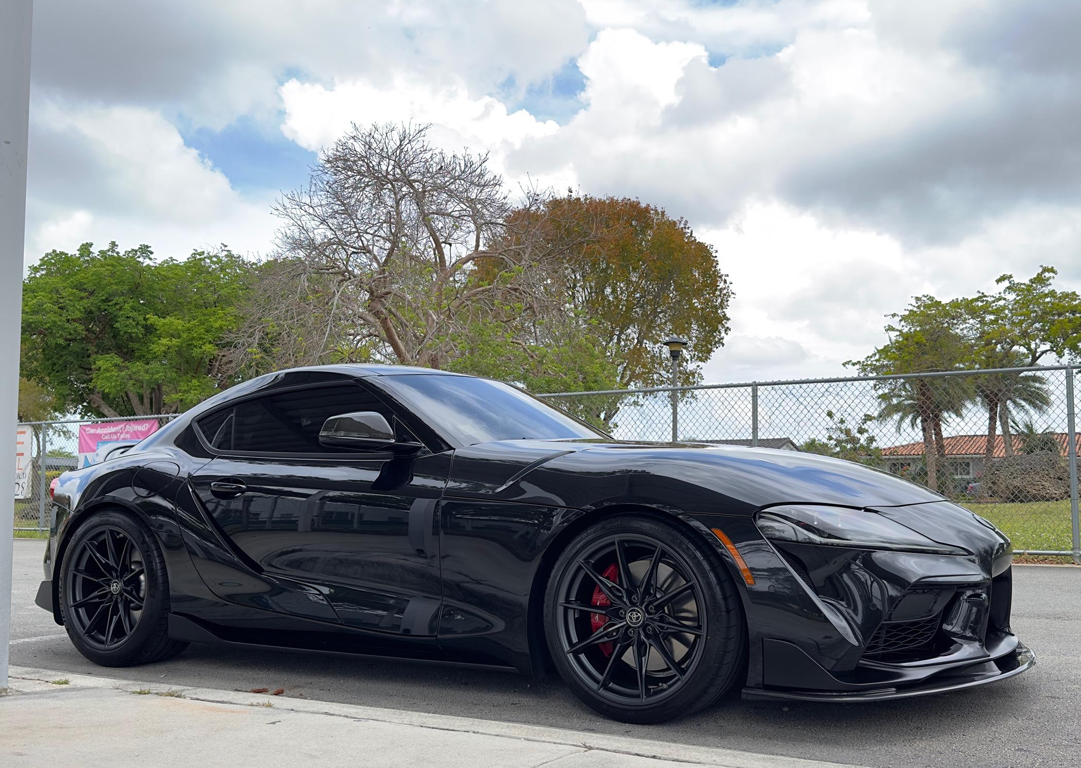

is this after settling? i always love comparisons for the sake of science. the ATs drop lower than the MTs. lil comparison (first pic is mirrored):
Looks great! And yep this is about a month after the install. They definitely settled after a couple weeks. Agreed on the AT and MT differences. Took me a while of browsing here to decide the route I wanted to go. Looks like ours ended up looking pretty similar after all.

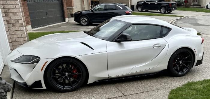

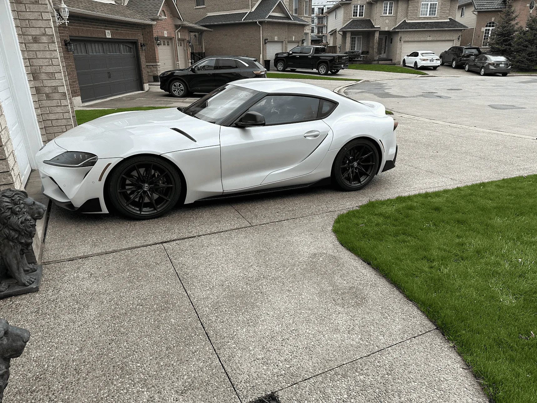

Interesting, the Z4 Euro springs looks like they now offer a similar drop to what the USDM springs offer for the MT cars.
I installed the US Springs on my car a bit over a week ago, probably done about ~300km since
Andrew4Supra
Andrew4Supra
Andrew
Jan 20, 2021
100
2,015
3,567
Powell, Ohio
I installed the US Springs on my car a bit over a week ago.
~ Your car looks lower than those with the actual Euro Eibach Z4 Springs imo.
