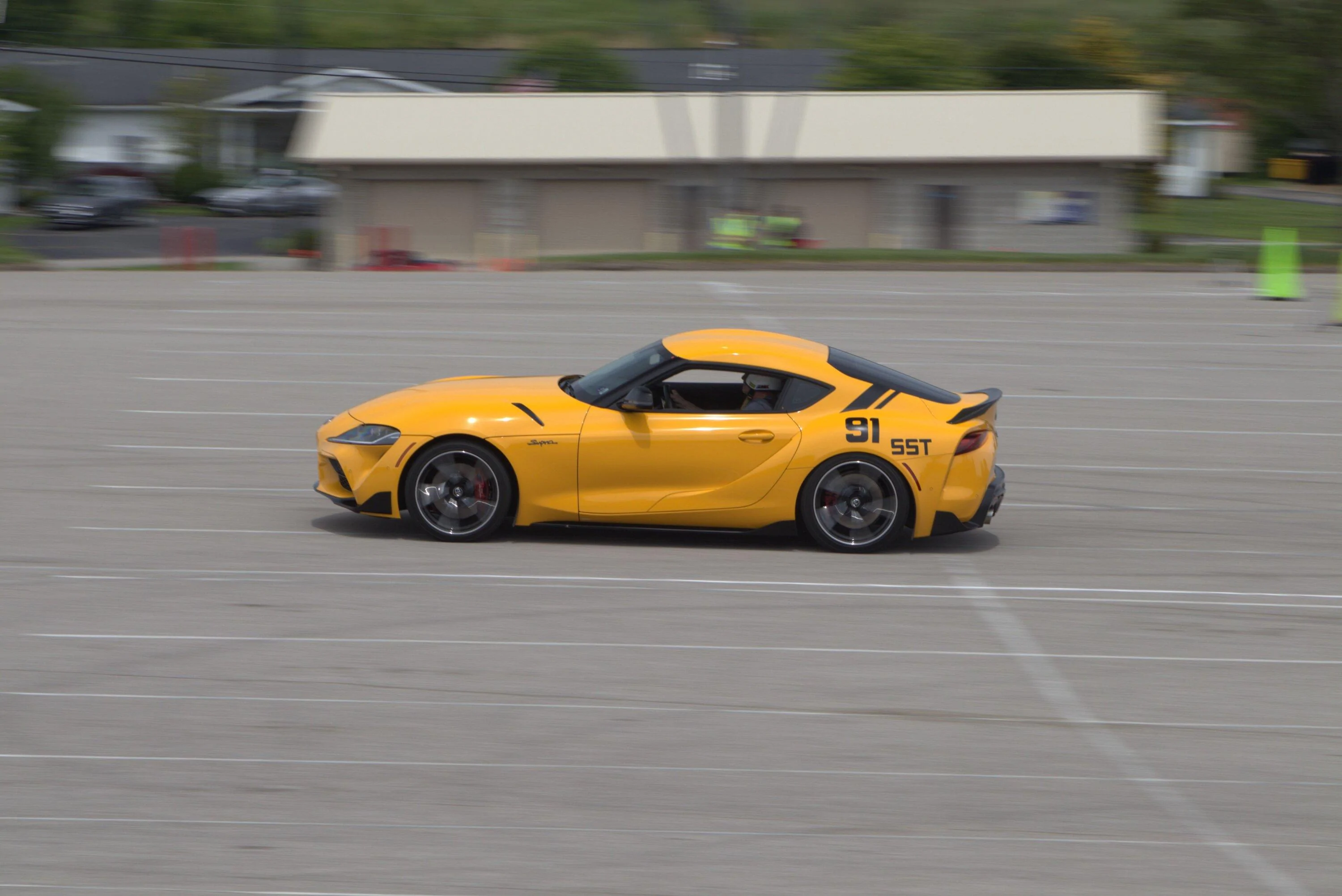

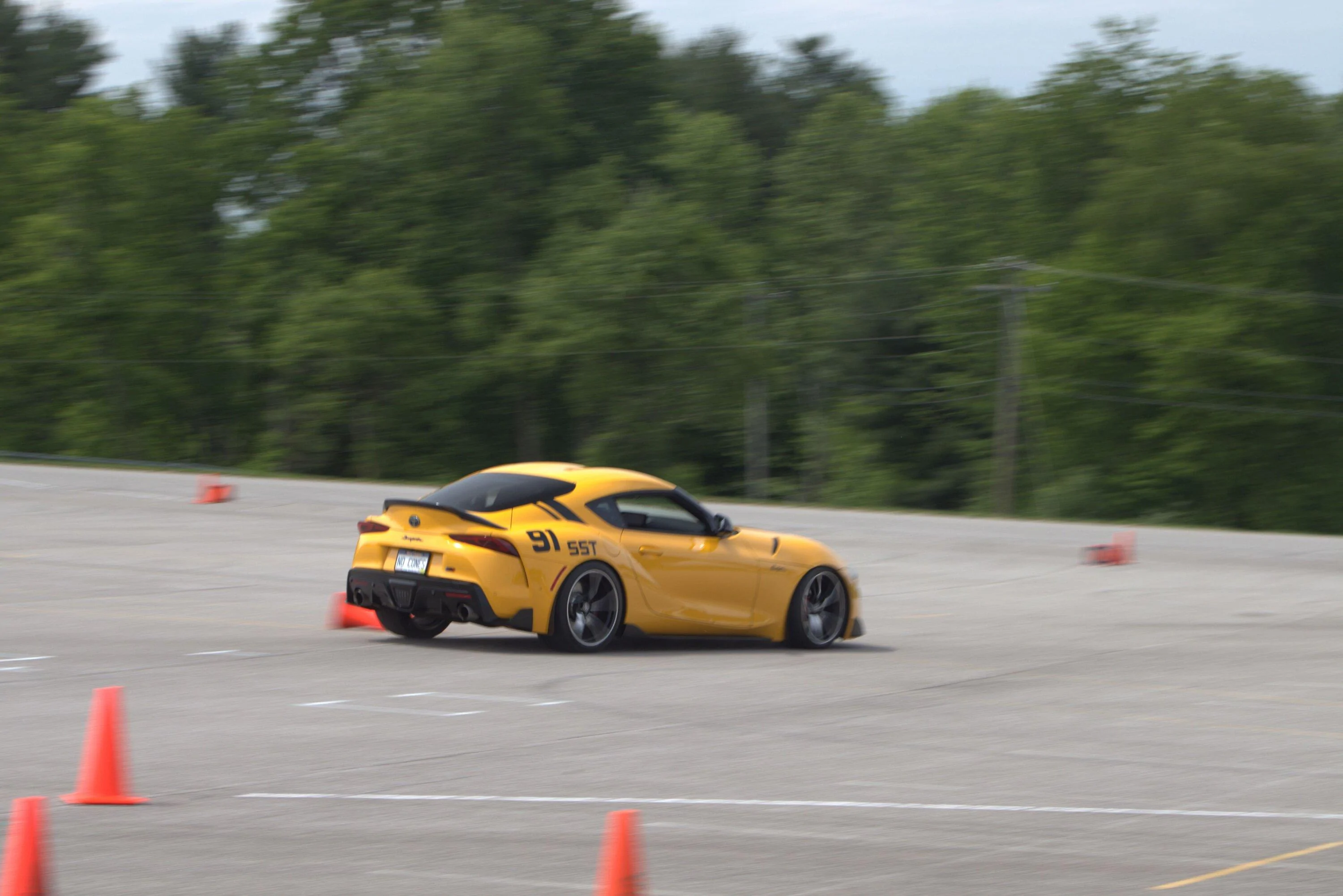

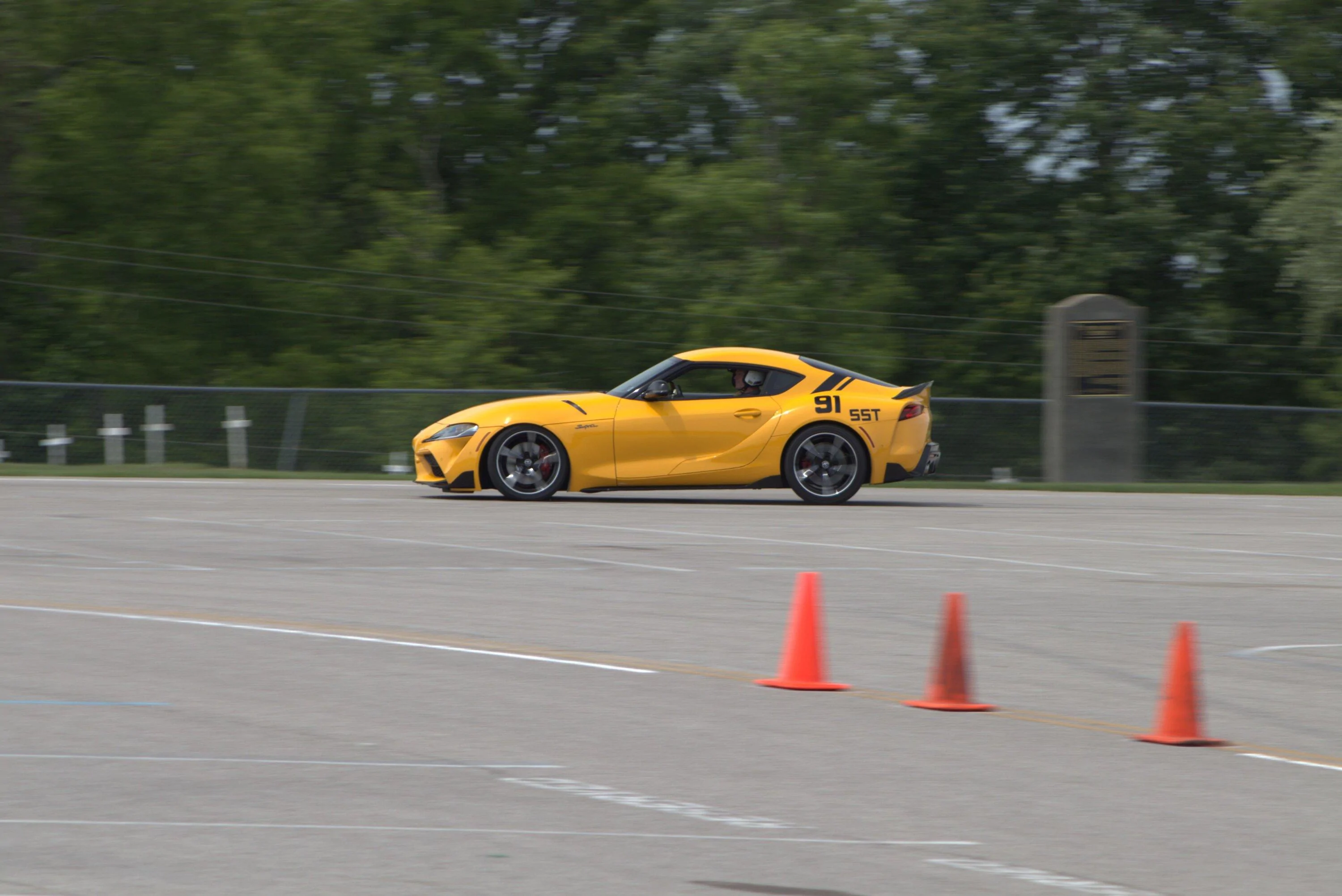

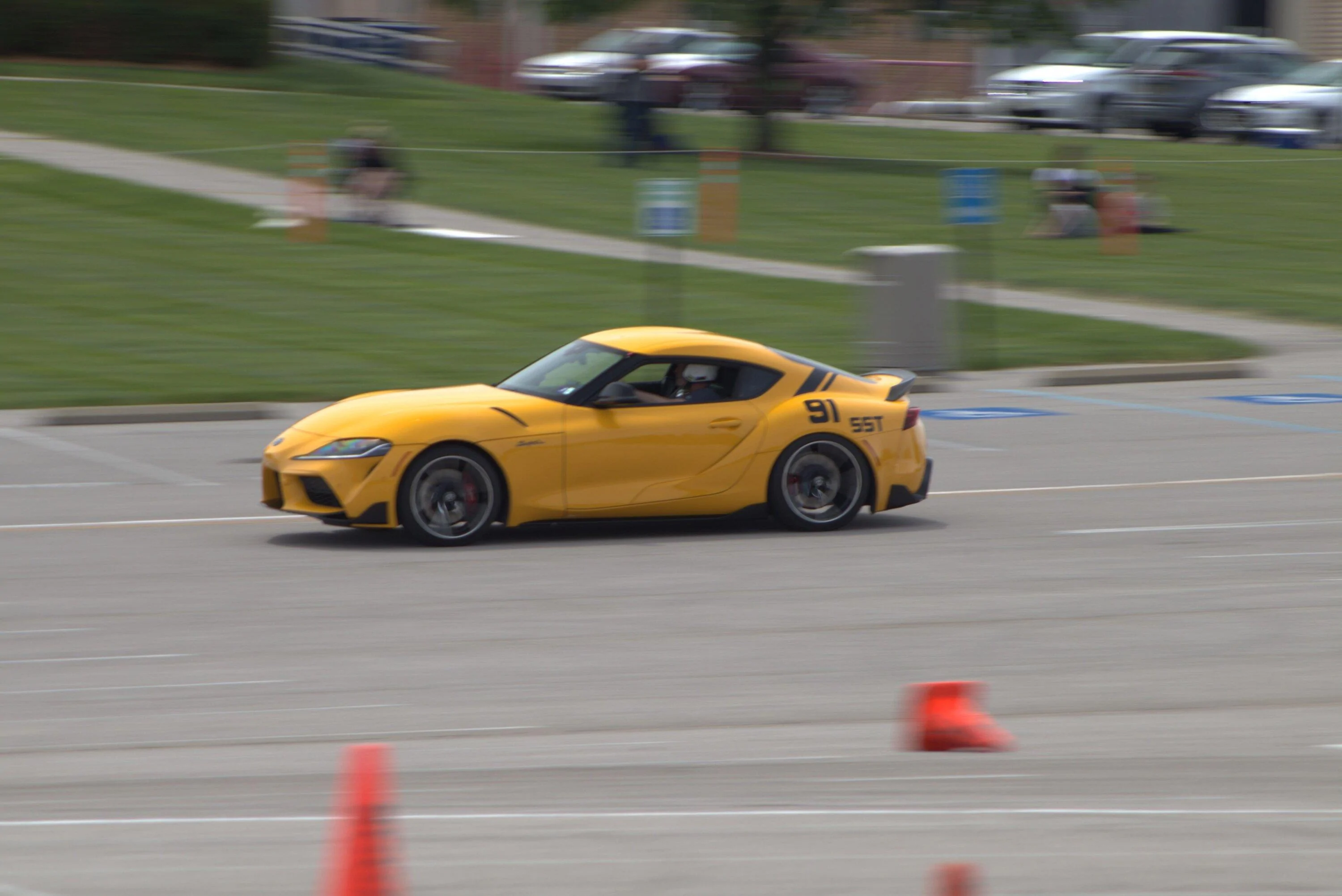

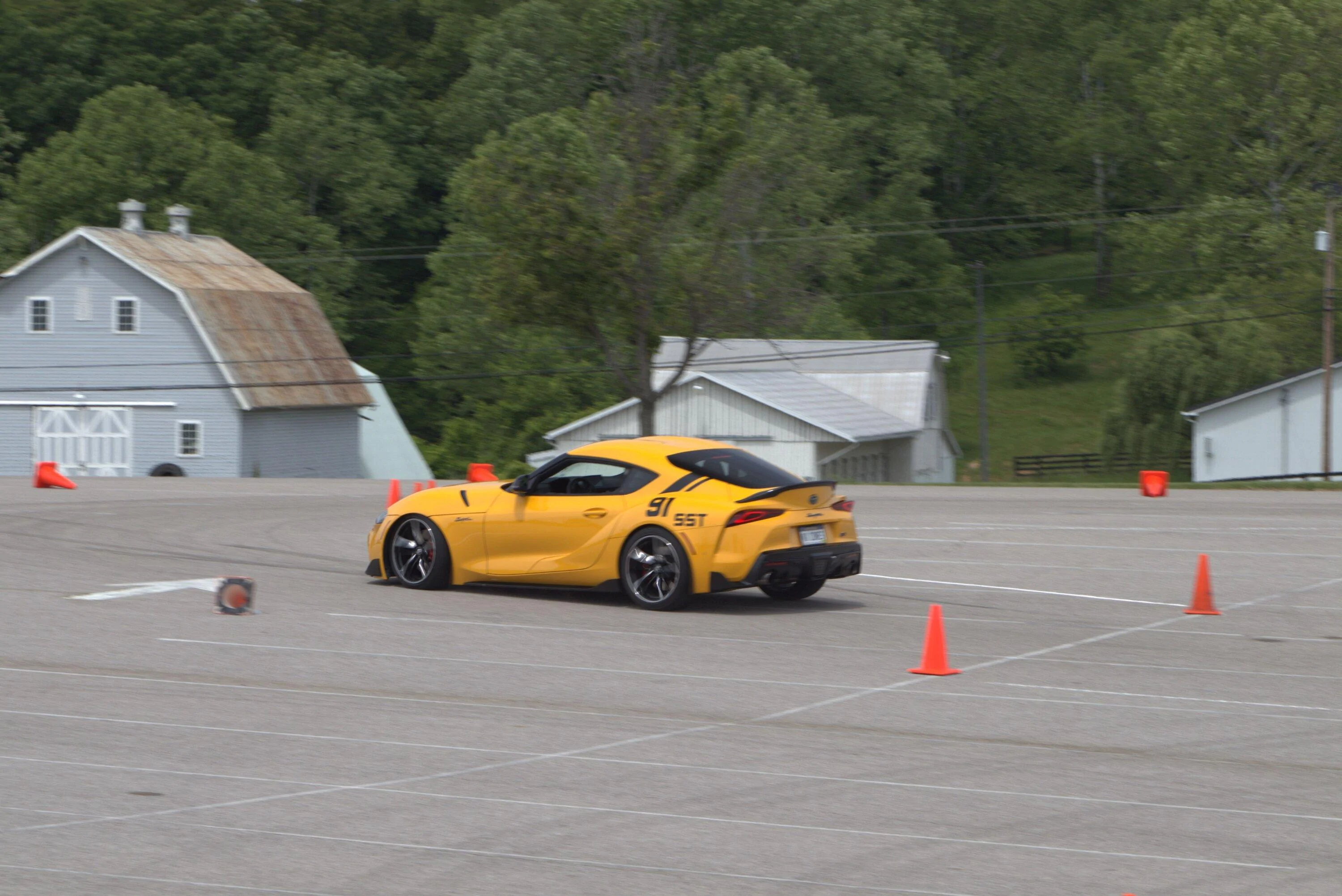

For those still wondering, I can report the Euro spec springs do NOT rub in an autocross setting in the following configuration.
-Factory wheels
-255/35 front, 275/35 rear RE-71RS
-10mm front/13mm rear spacers
-Verus camber plates with 3 degrees front camber
-Eibach front sway bar in softest position
-Factory wheels

Just wondering if you needed any aftermarket front or rear control arms and/or end links (eg. SPL etc) to achieve this setup?
Planning to do a very similar setups as yours. Looking good and thanks for sharing the info!

Nope. My only suspension mods are what's listed.

I’d probably try this setup first without the lower arms. But I do have the US spec Eibach ProKits and Eibach front/rear sway bars. I’ll be running on 18s also. I’m worried about suspension travel on track days but it will only be quite occasional. Thanks again!
I didn’t have problems until I was driving over 100 mph consistently at turn one at Homestead. I really doubt autocross will cause the same problem. The area to check is the outer fender of your hood. Look for any tire marks. The plastic started to wear as well. That is what I should have done (looked for) and I would have figured out my problem way sooner.
Edit: I have a friend with the same problem, totally different setup/brand/on coilovers. Showed him the wear on his hood fender and his plastic guard is starting to wear as well. The front end of this Supra doesn’t need to be lowered as much as the other cars I’ve owned. If anyone is tracking. Food for thought
-Factory wheels

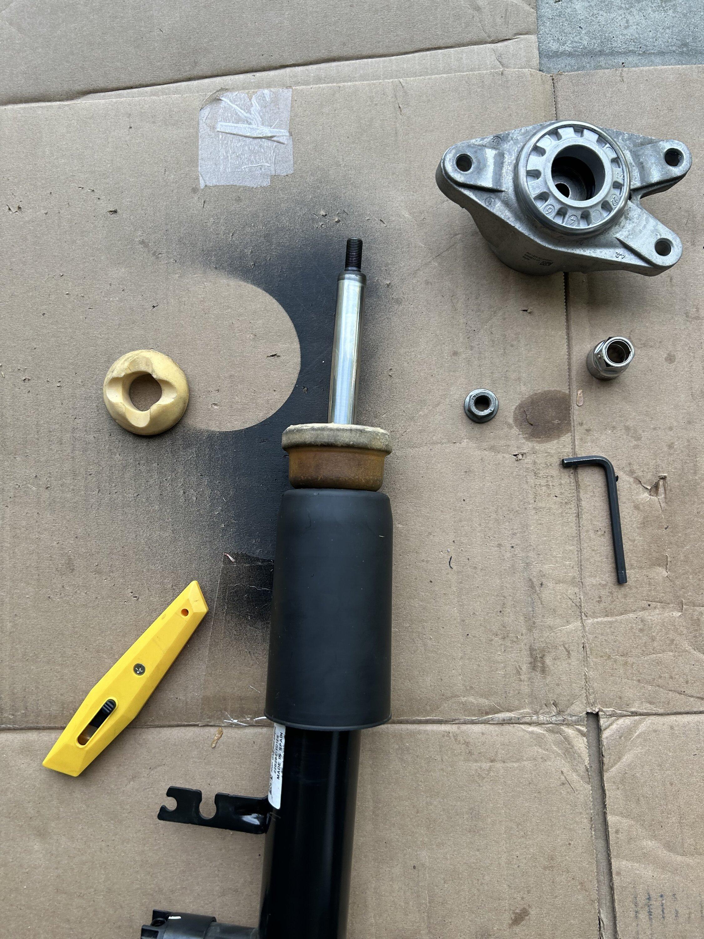

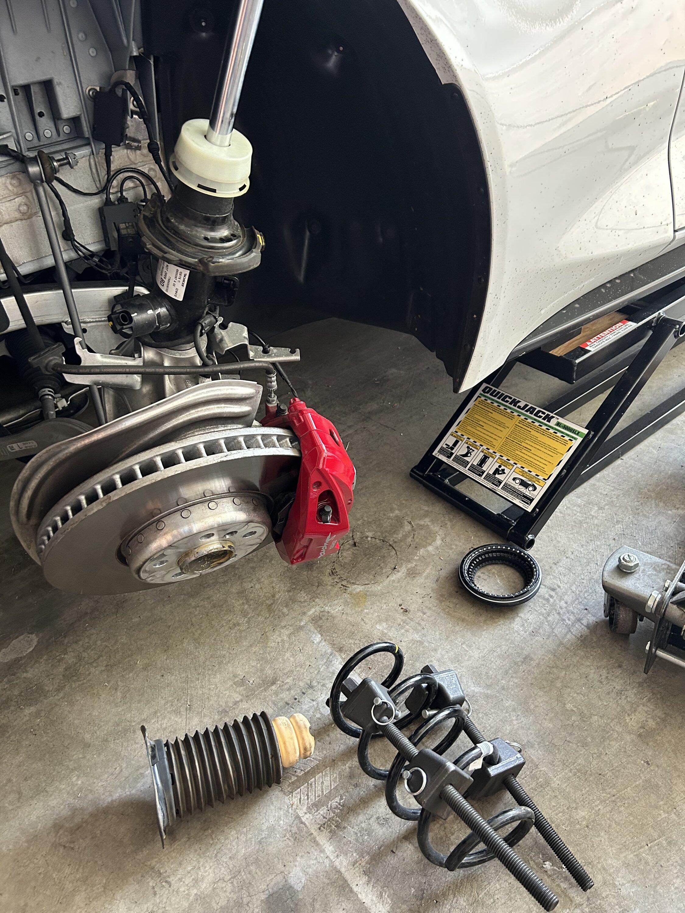

Ordered a set from Tunershop on Sunday arrived at my door on Wednesday, $285 shipped, with 5% off promo they had, just checked now and they’re on backorder, box does say Supra though, will update once installed
M3P-A90
May 2, 2023
PNW
23 Supra
Installed the springs, pretty straightforward with the right tools, be sure to have pass through socket set, etorx socket set for the rear and spring compressors, waiting for springs to settle then off to alignment. Both front and rear bump stops were cut one donut.

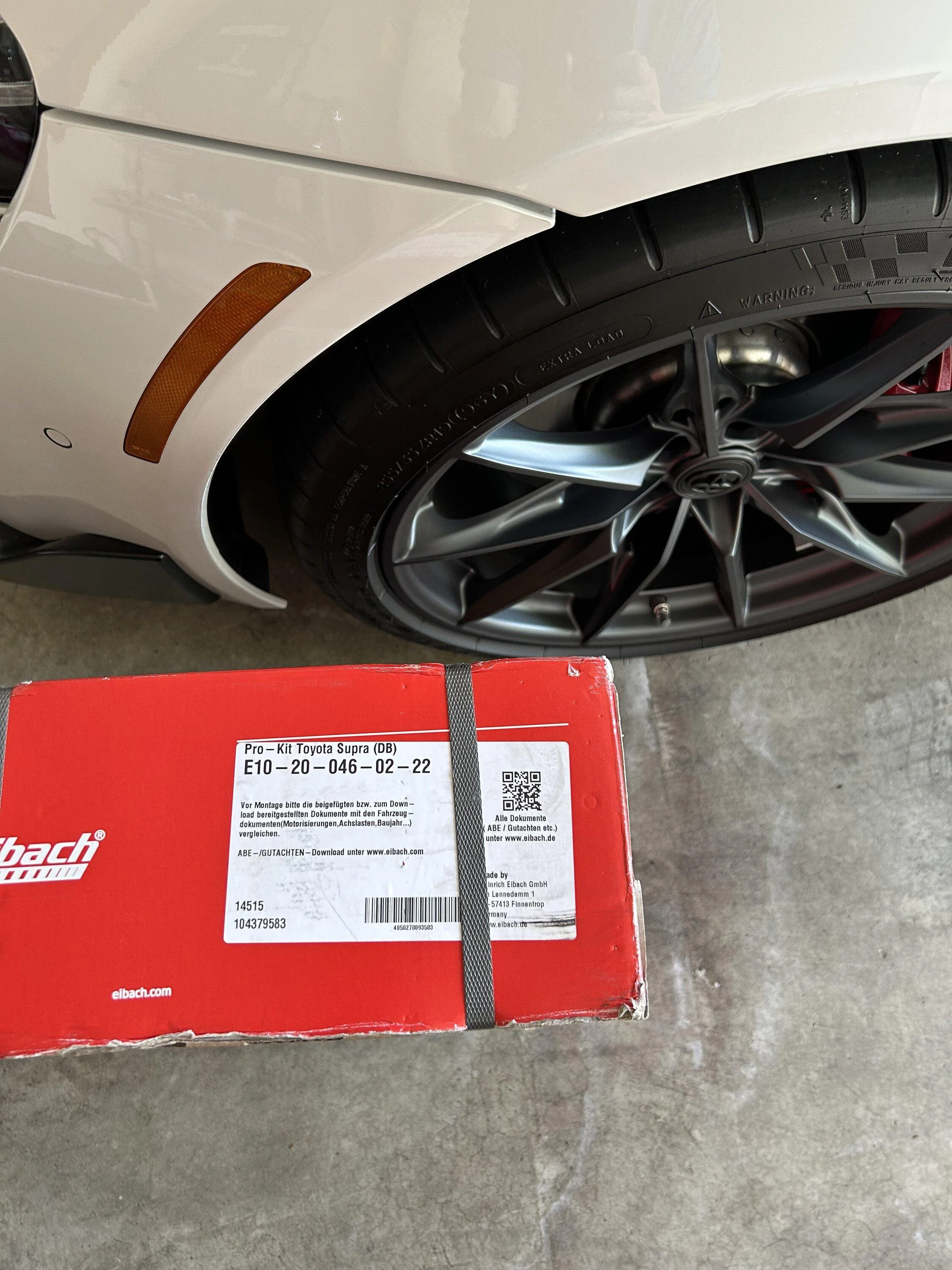

Has anyone been able to confirm with Eibach if the US Springs now match the Euro Z4 ones? or if they changed the US ones at all?
On their website now if you search by Manual Supra, it shows that the springs are 0.9" Front and 0.8" Rear drop, but for the Auto it's 1.3" Front and 1.0" Rear.
The part numbers however, are exactly the same between Auto and Manual: E10-82-089-01-22
Is the difference in drop just due to the slightly different curb weights? Being in NA, I'd rather order directly from them if the springs are basically the same as the Euro ones now, but if not then I'll just bite the bullet and order the Euro Z4 ones off Ebay
