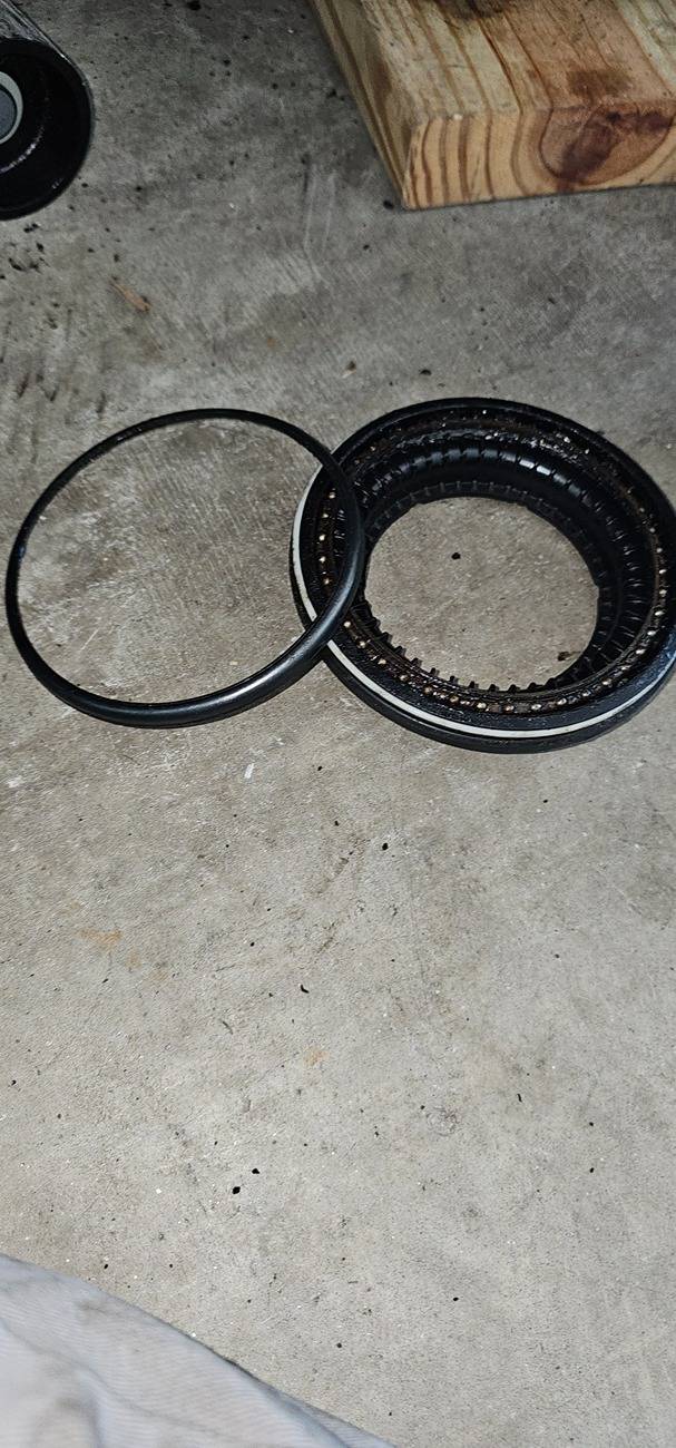

I went to do this install yesterday. Finished the front passenger side no problem. Lowered the driver side strut and the strut mount bearing fell out in pieces..

Had that happen to me on my drivers side front. Thankfully I was able to find all the bearings/clean it all up and re-pack it with grease but if you do need to get a new part, you don't need to buy the whole top hat
You can get just that Sub assembly with the Torrington bearings.
https://www.ebay.com/itm/286054406690

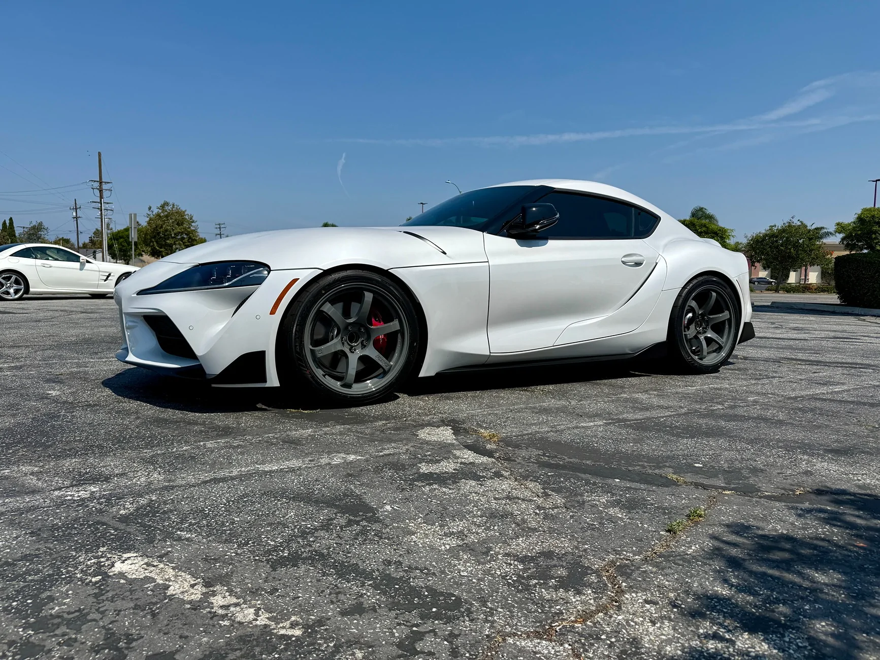

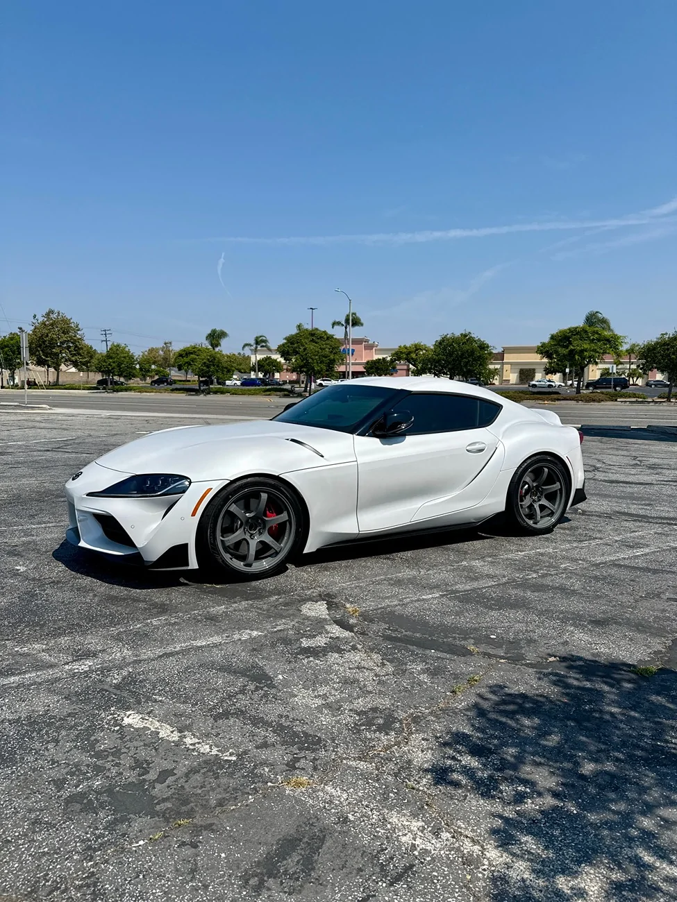

boosted180sx
Jun 4, 2019
Torrance, CA
2026 Supra
Installed the Z4 springs yesterday. Install was very easy.
Typical Supra spec 57DRs with 265/35 front and 305/30 rears.
Very subtle drop and rides just like stock. I was a little worried it might be too high for me but I think this height is fine once i get some kind of a front lip on the car.
Rears could have used just a bit more drop since the 305/30s are slightly smaller diameter than the stock 275/35s but i'll see how it settles over the next few miles.

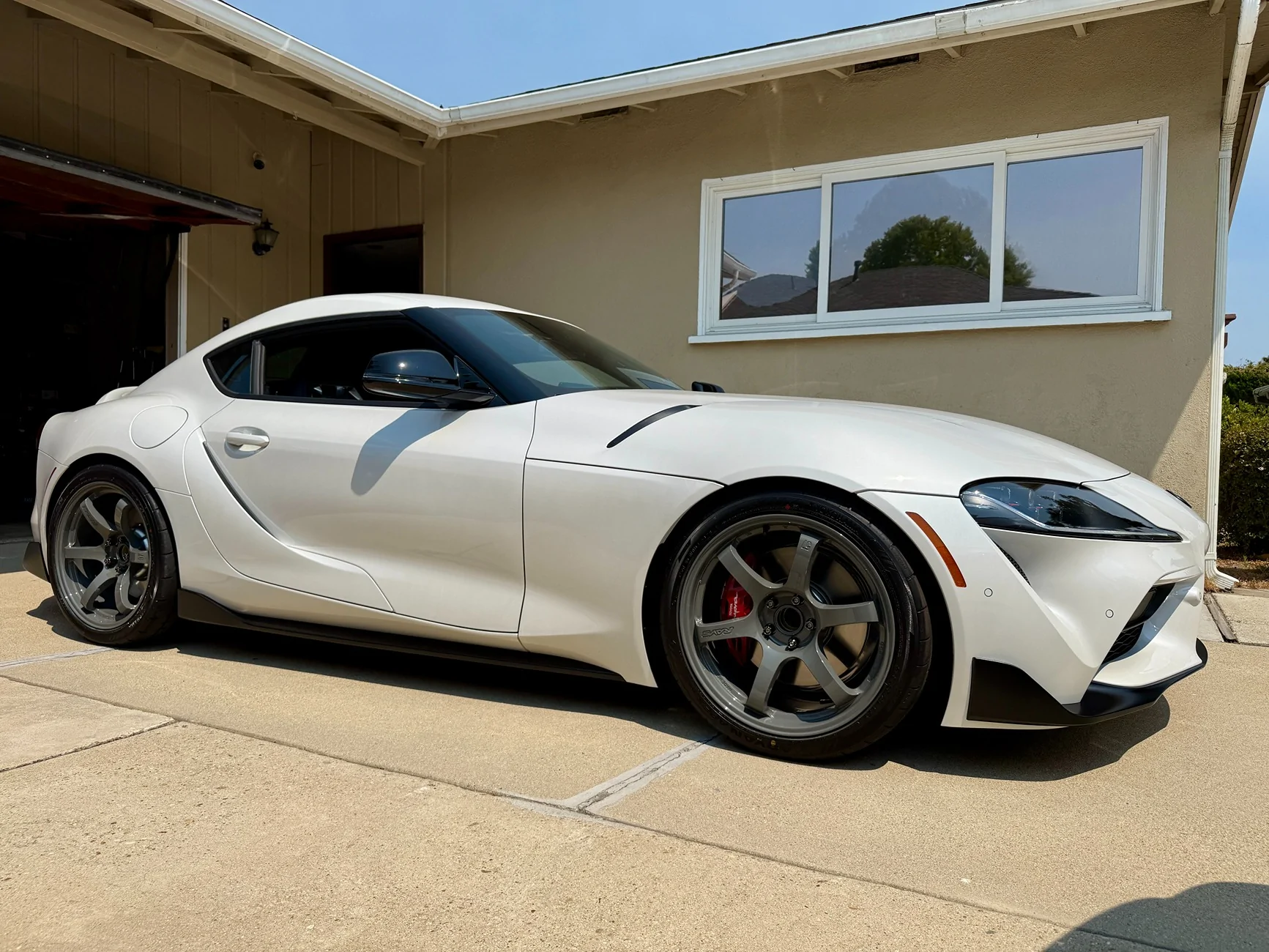

concept
Dave
Sep 1, 2023
32
1,160
814
Southern CA
I didn't install spacers, but I noticed that cars with spacers look lower than those that don't. That appears to be because of the curvature of the outer diameter of the tire.
