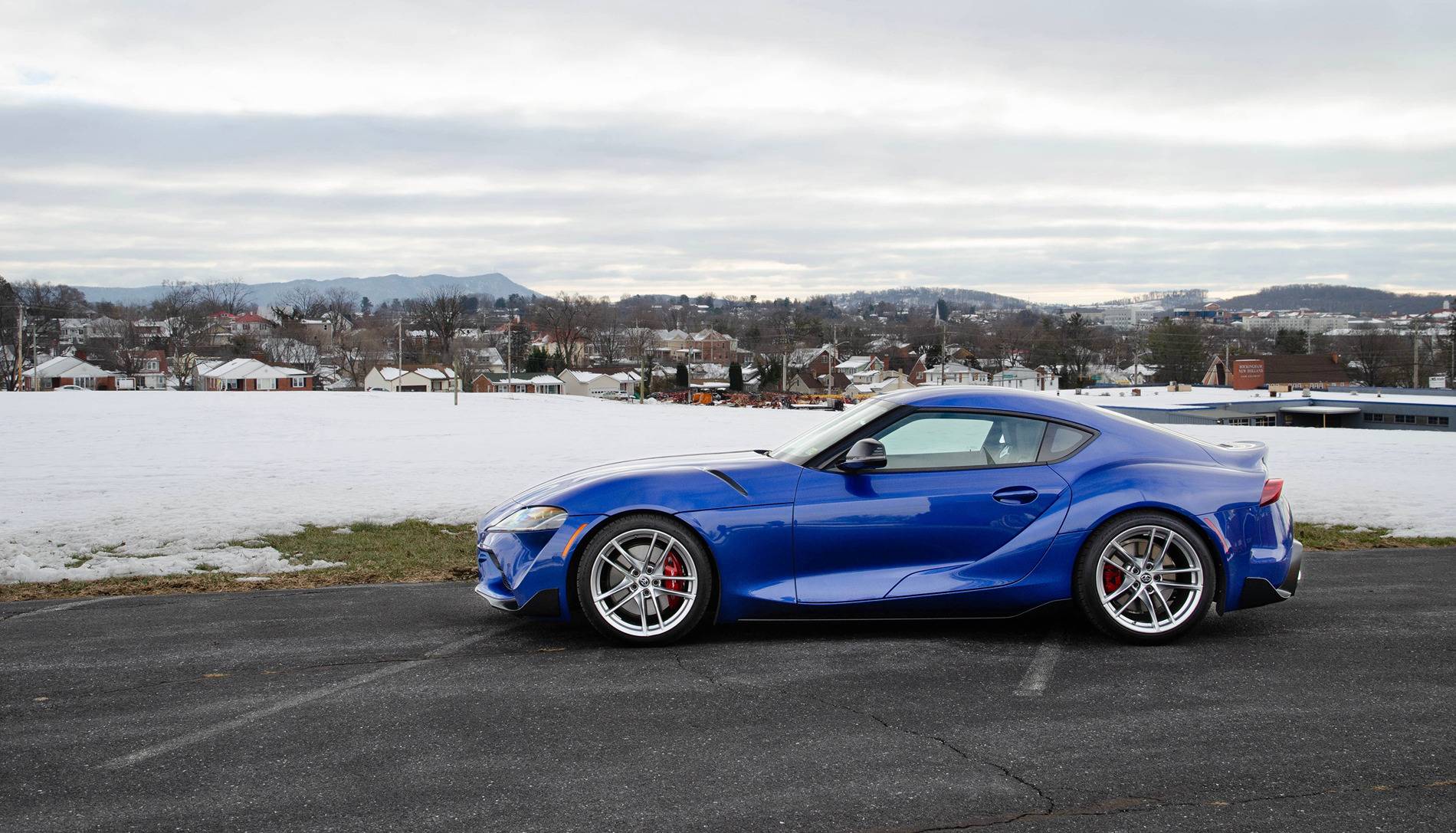

Agreed! I was torn between the two kits and seems you can’t go wrong!
Cheap eBay CF kit. Was like $190 shipped. Best fitment I’ve seen. I must have lucked out. :)

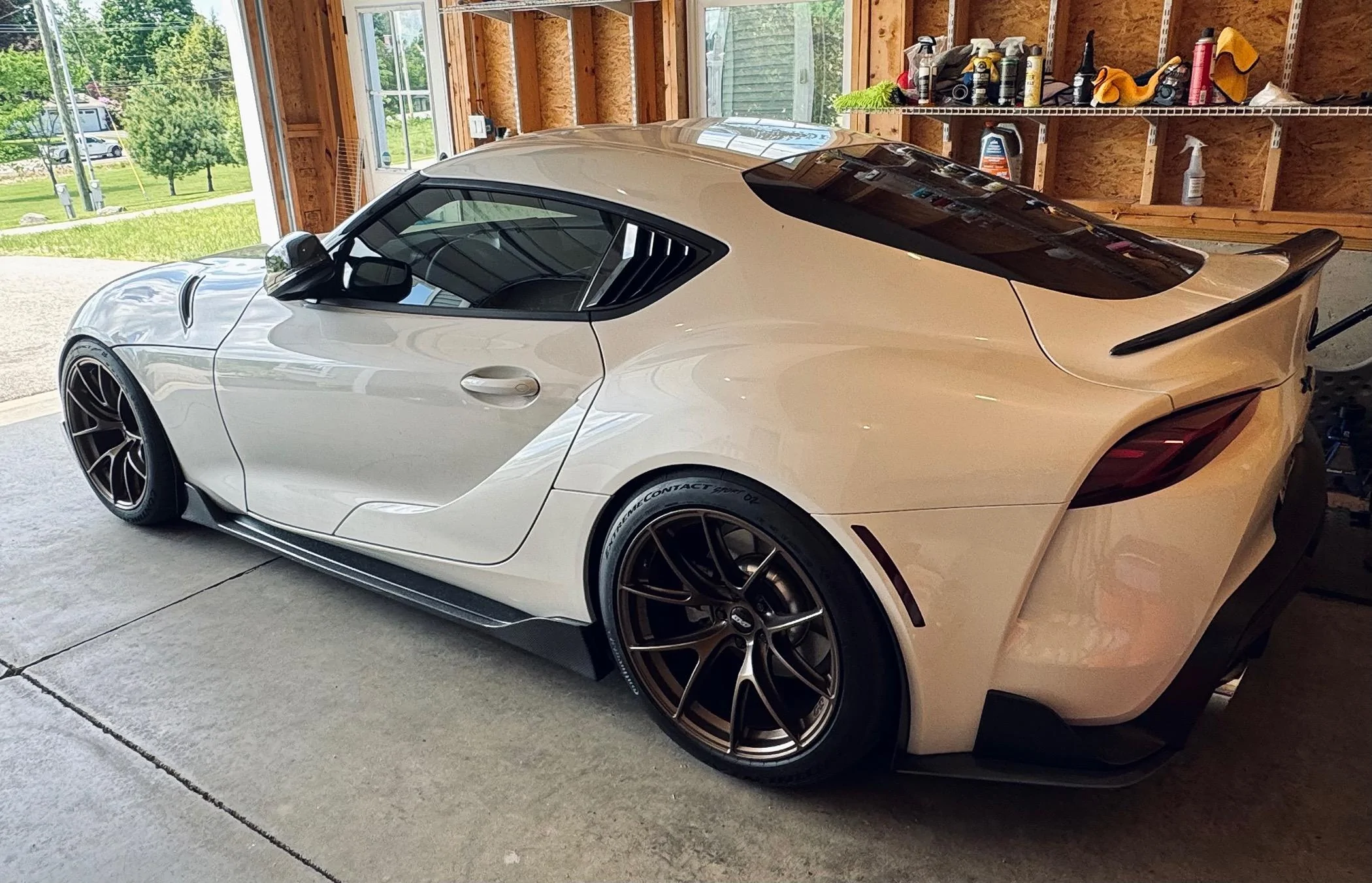

Just realized you are on Apex wheels with some Continentals! I have been thinking of doing a similar setup. Mind sharing your tire specs and maybe more pictures? Thanks!
Sure thing! I was gonna do some pictures and walk around video at some point with the springs / spacers. Car is so filthy from pollen. May take me a day or two to find the right spot / clean the damn car :)
Will tag you if I post here! Just in the garage now

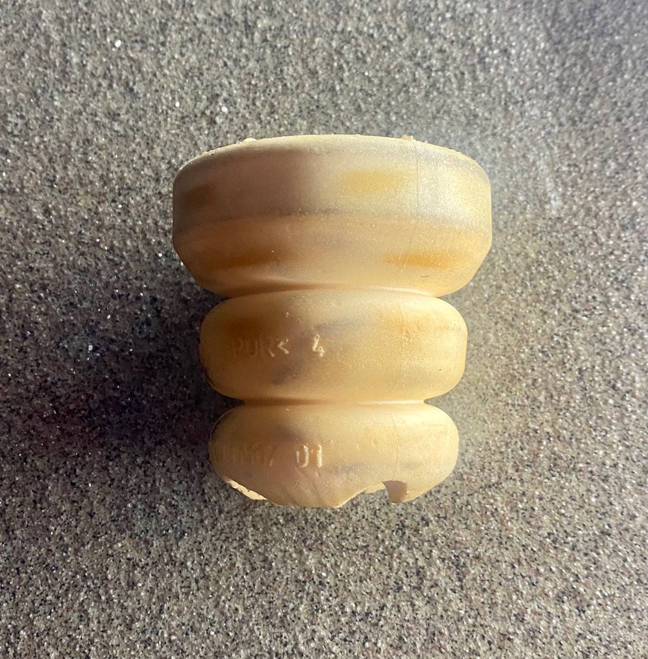

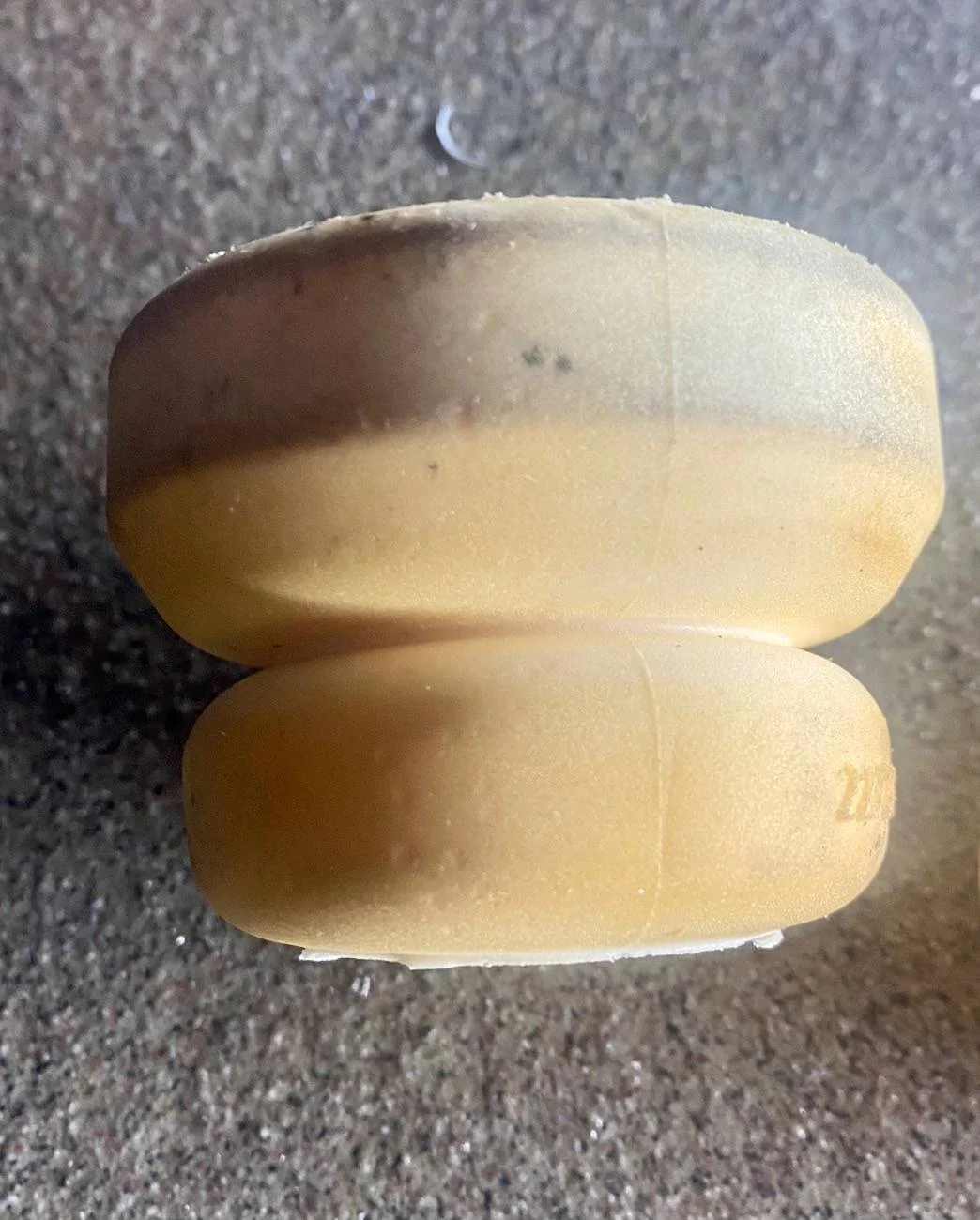

Did you guys have to cut the bumpstops to install the springs?
