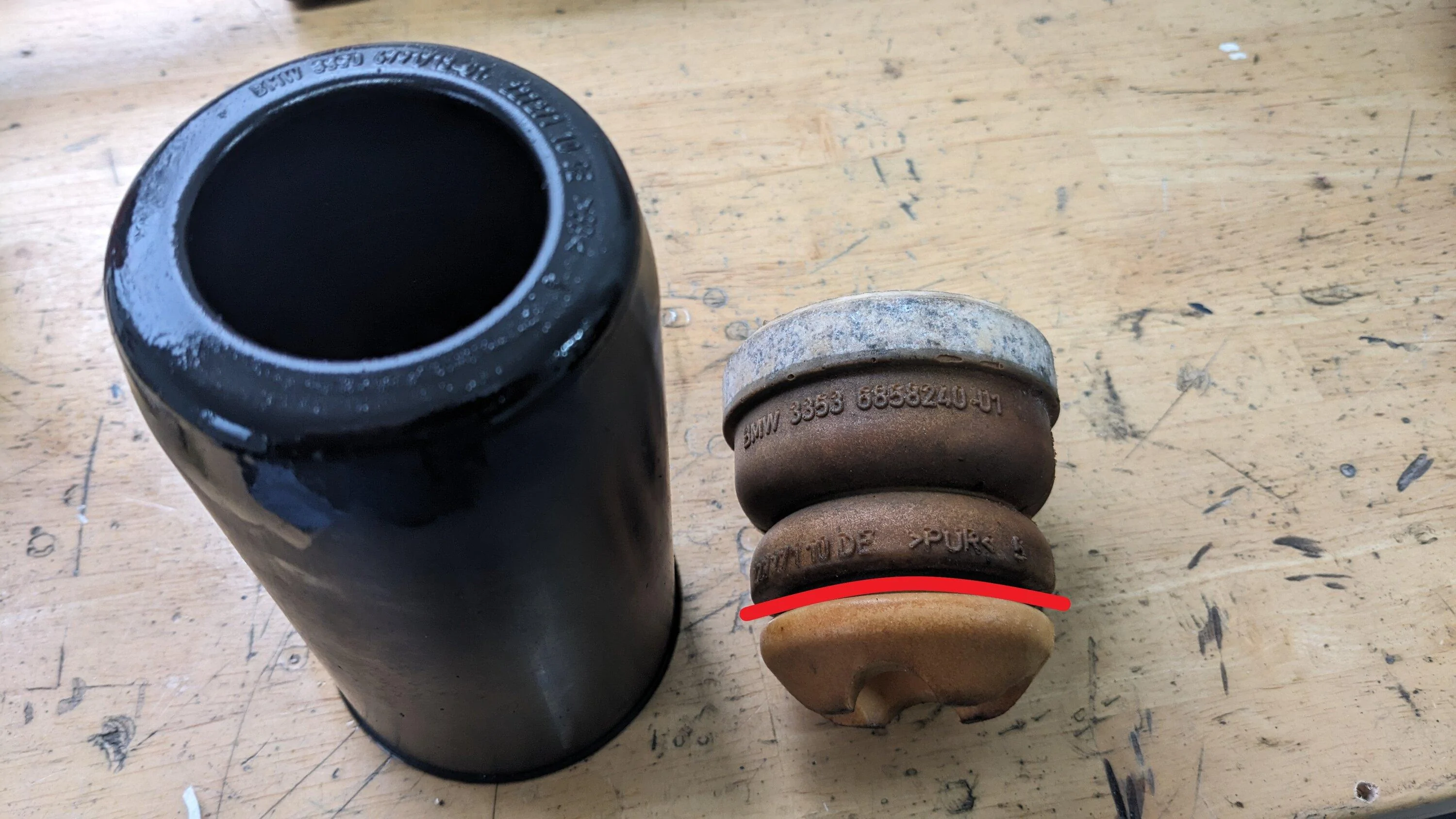

As for the rears, can anyone confirm it's here I cut the rear bump stop right?

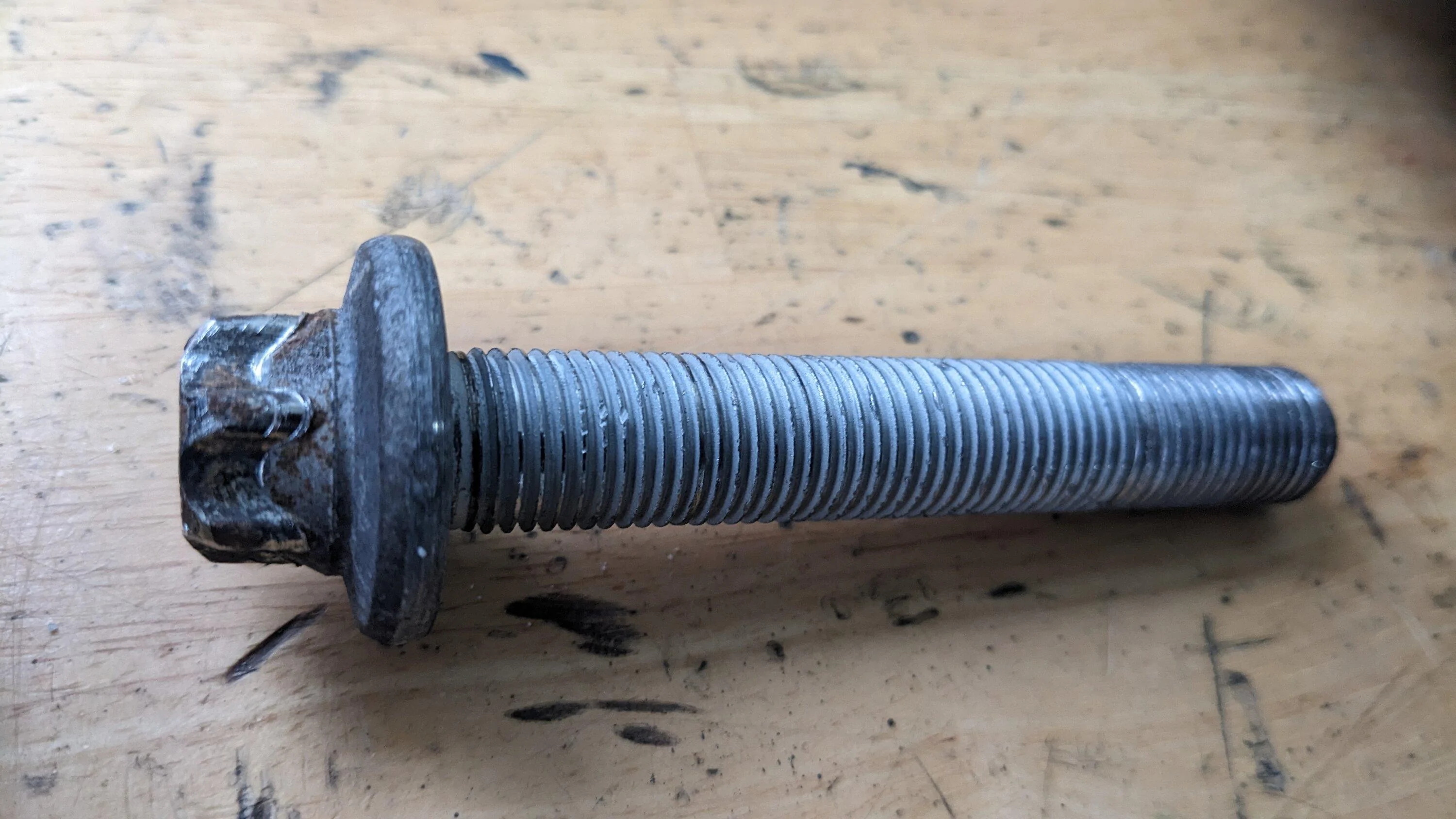

Also, what a nightmare getting the lower arm bolt out, dreading putting it all back together based on comments here. Going to order another as the impact gun made a bit of a mess of it. Anyone know the part number?
Edited - I think it's 90118-WA291

Yes on the cut. Also not as bad as it sounds lining the rears up to reinstall the bolt. I just used a long screwdriver. Line it up best you can then put the screwdriver in and use it to line it up further. Bolts went right in. There’s also a specific tool you can buy for this purpose but a plain old screwdriver works just as well.

Thanks for the advice. Did you reinstall the bolt before or after reattaching the shock absorber? Not sure what order is easier.

Did the instal a while ago so my memory is a little hazy but I’m thinking those bolts were last.
