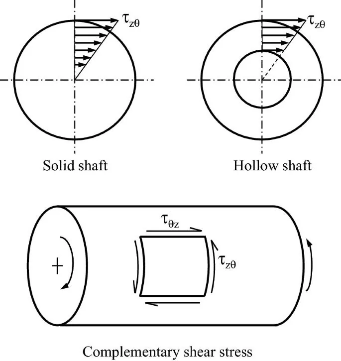

So I realize that most of us here are engineers, but for the ones that aren't, keep in mind that the center of a shaft in torsion carries the least amount of load. You're better taking off that freeloading lazy bit of material in the center and putting it to work on the outside
