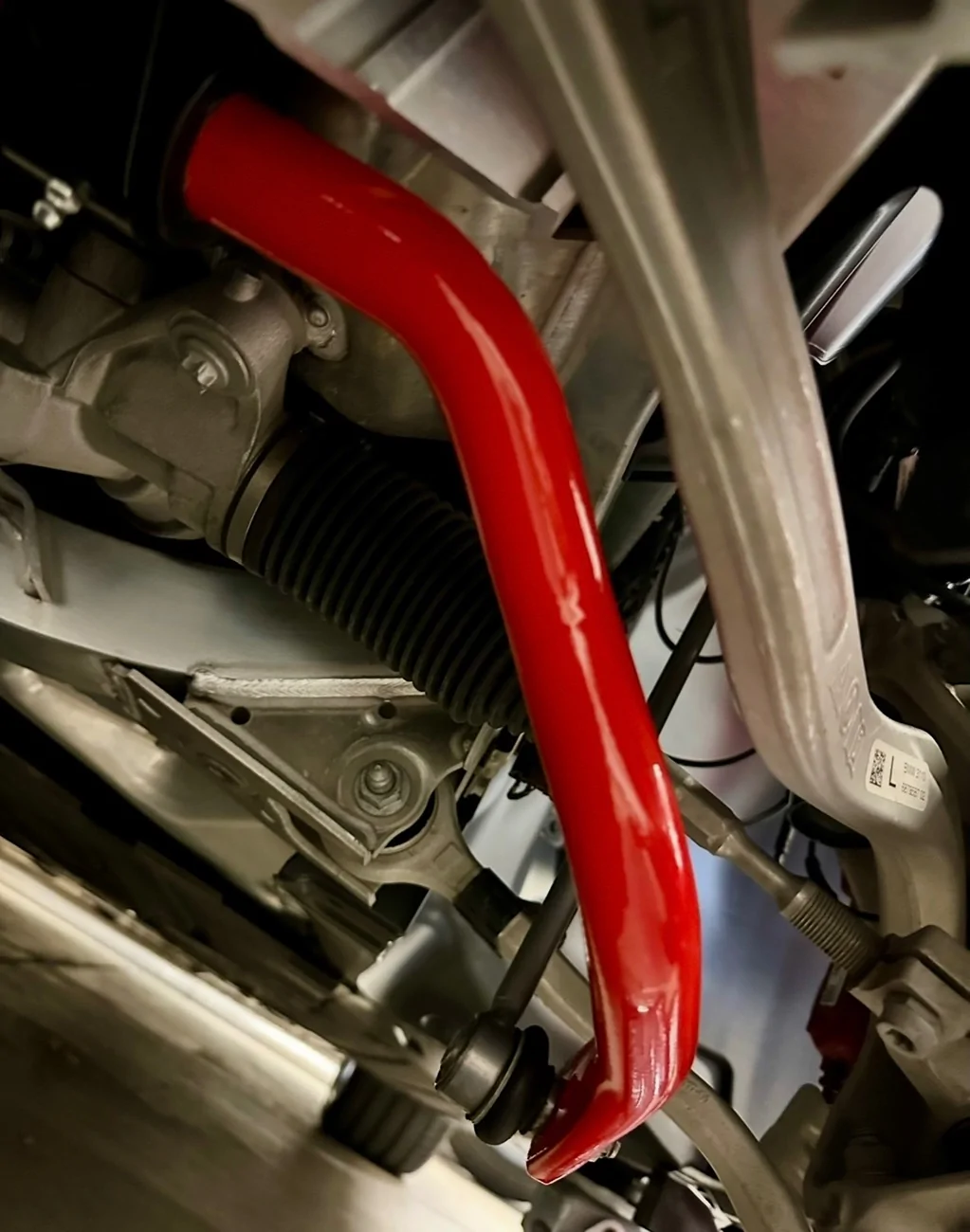

sorry I may have missed.. did you also had to purchase endlinks? Thanks
~ I just use the stock links… but I’m on the softest setting (creating the least binding on the end links).

Thanks to @Andrew4Supra im gonna pull the trigger on eibach. I will get verkline endlinks and be on the stiffest setting. Il also do the 1” drop later down the road.

H&R springs here with the Eibach front sway on stiff and oem endlinks. Zero issues. No rubbing, no binding, nothing. Just dont be in a rush and after 15 years of working on cars install the sway bar upside-down. It's an expensive mistake. Other than that, it's great!

that’s the exact set up I’m going to have plus the camber plates. This is good to know thanks!

I keep tossing around the thought of Verus camber plates before my next alignment. Is that what you're going with and if so you think the camber plates are worth it? Im currently at -2.2 up front which isnt bad for not having any adjustment.

I have H&R springs and can get -3.4 with verus camber plates.
