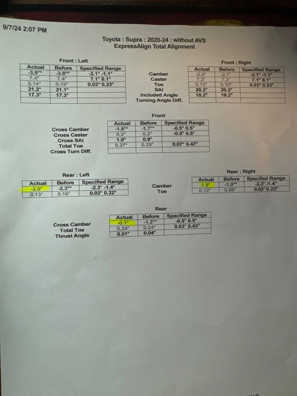

Just a thought too, I know that some shops may struggle with lowered cars due to the small tire to fender gap. When they place the sensor on the wheel the arms can’t touch the fender. Some equipment (like hunter alignment machines, which are a very popular brand) require special adapters for the sensor arms to fit. Without them, if the arm bumps a fender it can throw the spec off by a small amount. I’ve seen specs like these on my own car, but then within tolerance with the right adapters. Hopefully the shop you find specializes in this stuff, as others have mentioned, and this won’t be an issue.

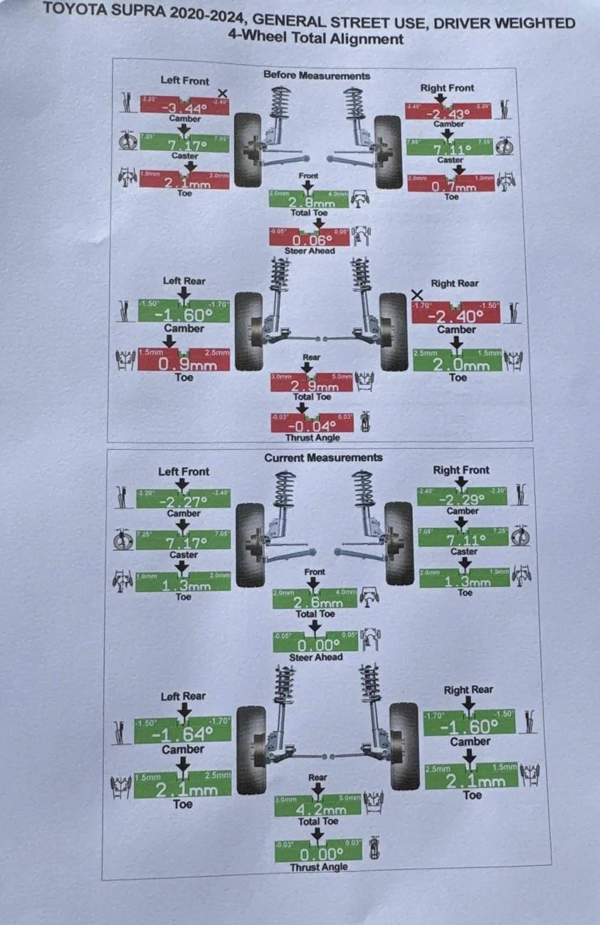

Was able to get find a performance place and they did it for 300$ as it was expensive they did a good job so I don’t mind Atleast it’s not 800 my area stuff is pretty expensive if anyone else lives in Washington it was a place called tru-line
Hasan
Hasan
Aug 25, 2023
351
183
United Arab Emirates
Too many to list
Thats a lot of toe, but it should feel pretty good.
