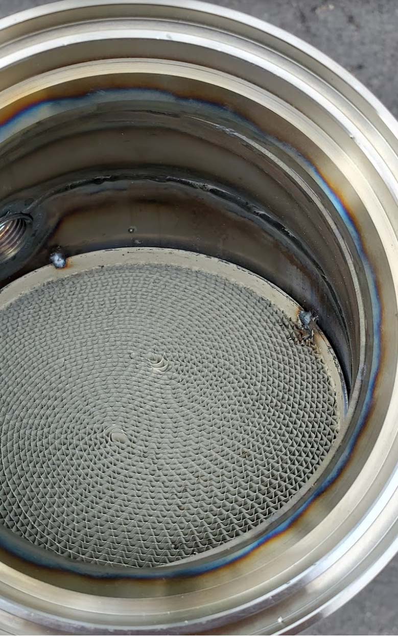

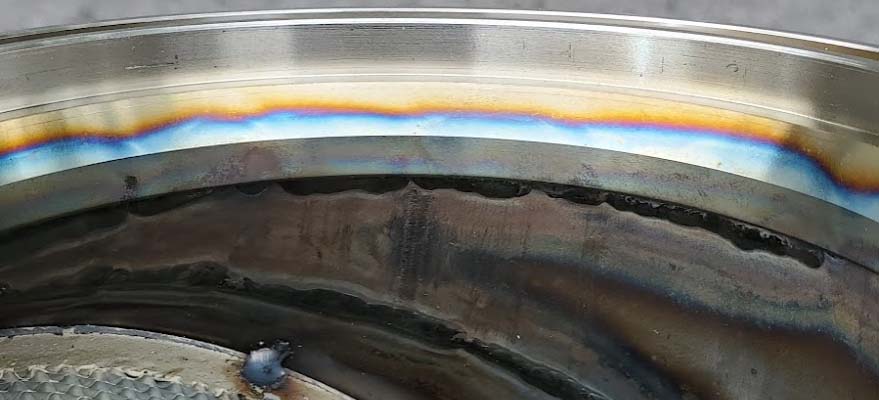

I just received a DS-1 downpipe, and the flange is welded about a millimeter off center. Is this a functional problem or simply a cosmetic level issue?
Obviously I wish it was welded up perfectly rather than looking like someone was in a rush, but I don't care if it's not going to be a potential performance or longevity problem.
Right side where the flange is shifted right:
left side where you can see the weld filling in the gap:

As long as there are no leaks, this is only a cosmetic issue.

I am not a welder, so maybe someone who knows more can provide input, but I would think with a bunch of (high temp) heat cycles, this is going to be a problem.
