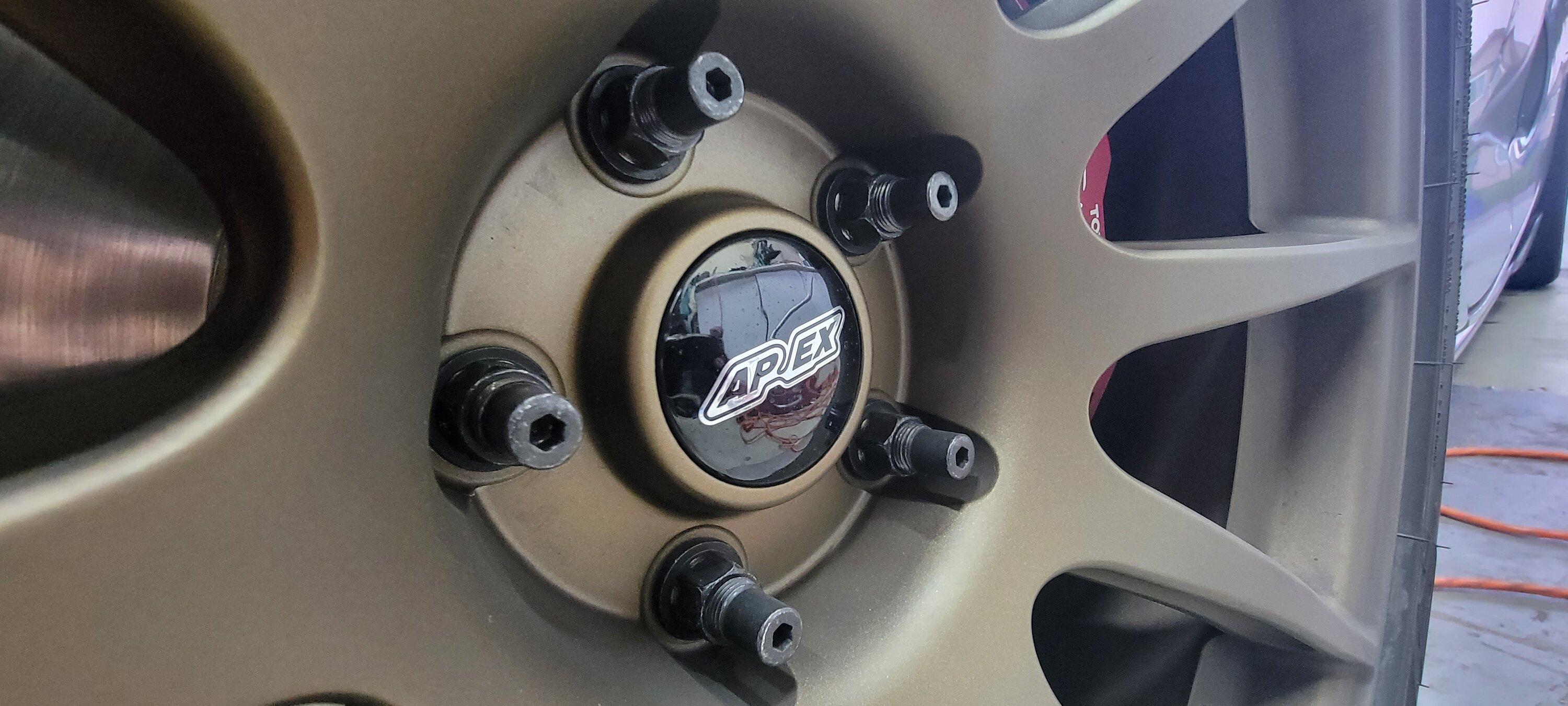

18x11s ET40 all the way around on 315-30-18 Falken RT660s. 3mm spacers at all 4 corners too. Also now on coilovers.

Hey, Sean! I just caught this thread (...you know why...). Did you go with longer bolts with the spacers? Also, which spacers? I'm having a hard time finding a 3mm spacer of decent quality. Hubcentric?
TNZupra
Jun 27, 2020
51
65
Tennessee, USA
2020 Supra, 2020 Tundra TRD Pro, 2007 S2000.
Any spacer below 5mm isn’t going to be hub centric, as there should be enough hub for the wheel to grab on to.
You will need longer bolts so you have proper thread engagement with the hub.
Dinah has high quality spacers for our car in various sizes, and the correct length bolts for each application.
I run studs instead of the stupid factory bolts. So no worries with running spacers. These are the studs I got.
https://www.apexraceparts.com/store...x-m14x1-25mm-a90-gr-supra-5-lug-stud-kit.html
As for the spacers, I just got them off Ebay. They are hubcentric ones. Quality seems to be pretty good for how cheap they are.
https://www.ebay.com/itm/222113549770

Awesome, thanks! I'm being lazy here: do the hubs need to come out to install studs? I'm not a bolt fan.
