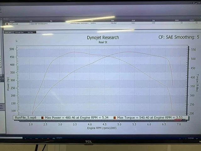

500+ whp/tq can be done on stock turbo w/catless dp. With a catted dp and e50 I made 480hp/540tq on e50 with Mikey Botti tuning. I could go 500hp and more tq switching to catless but the car plenty fast for me.
