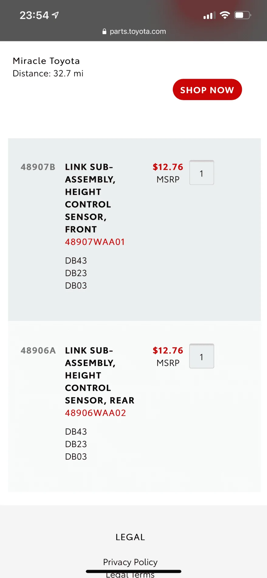

Okay I installed H&R springs and absolutely love the ride height. I have been getting chassis error warnings. Every time I drive it comes on. Sometimes it comes on quick sometimes not so quick but every time I drive it it never fails to come on. I had Toyota look at it when they were doing an oil change and they said they werenā€™t sure what it could be. Even when I told them I thought it was a leveling sensor of some sort . Iā€™ve seen both headlight sensor or ride height sensors about this topic. Are they the same? Not sure which one. Iā€™ve call the parts department and they canā€™t find anything like either of those. Toyota finally told me to call bmw. When I did bmw didnā€™t want any part of looking at it or servicing it. They told me to take it to Toyota ? anybody know the actual name of the part or have a part number for replacement. Iā€™ve been told there is one on the front driverside and one on the back driverside. Short of taking it off and taking it to the parts department Iā€™m at a loss. Thatā€™s if I even know what it looks like. Any help would be greatly appreciated. Thank you.

that was my issue, both of them were broken for me. I had them swapped and itā€™s perfect!
Goodluck.
If youā€™re not tuned, Iā€™d just take it Toyota and have them warranty it.

They wonā€™t because Iā€™m lowered. Already tried. Cheap try to fix. Iā€™ll give it a go. Thanks man. ??

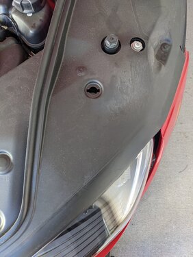

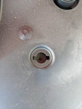

There's usually a cap over it but I just left it off. Behind both headlights you'll see a cap that looks like it can be turned with a coin (but it can't). You turn it and pop it off with a flathead screw driver and it'll reveal the vertical adjustment screw for the headlight.
Awesome thank you man.
