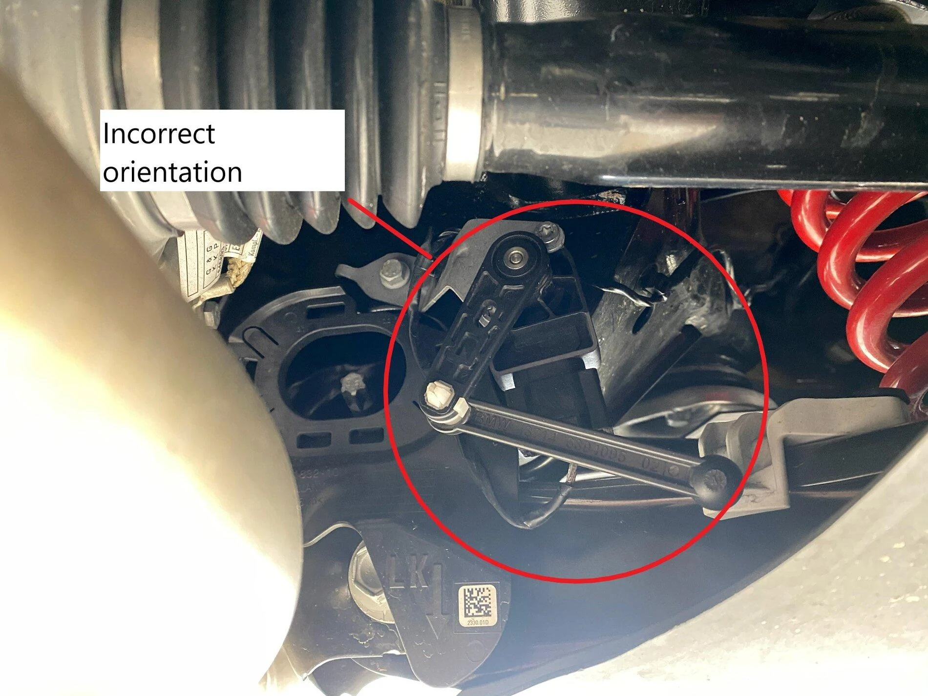

My issue was from the rear ride height sensor being in the wrong orientation for the shop that did the install.
Also if that plastic bracket gets warped, broken, or not set back properly that can also be an issue.
Visconti sells a billet aluminum replacement.
https://www.viscontituning.com/coll...suspension-ride-height-sensor-bracket-upgrade
I also used BimmerLink to clear out the ride height error.
