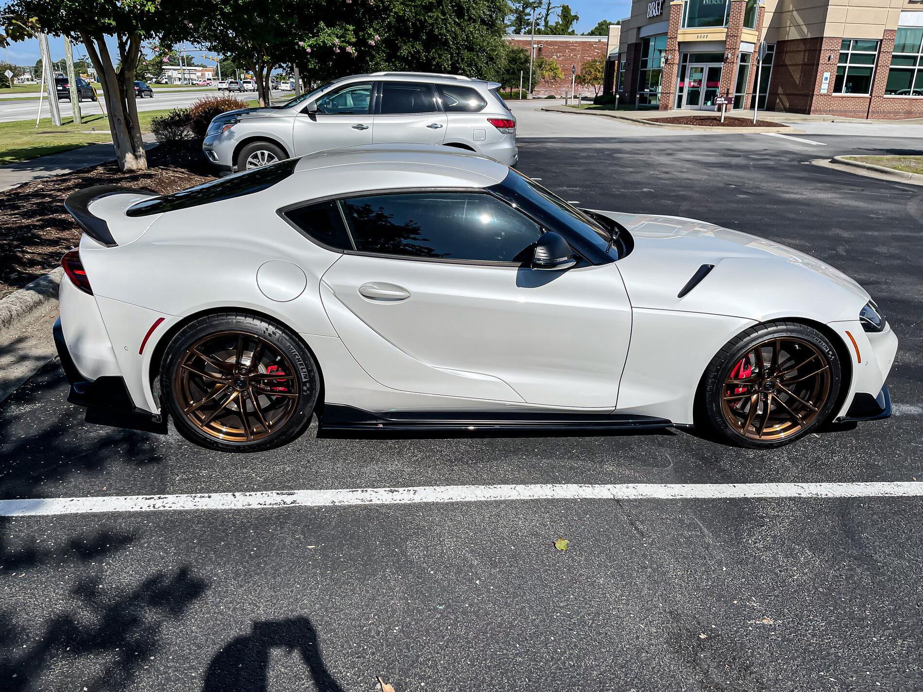

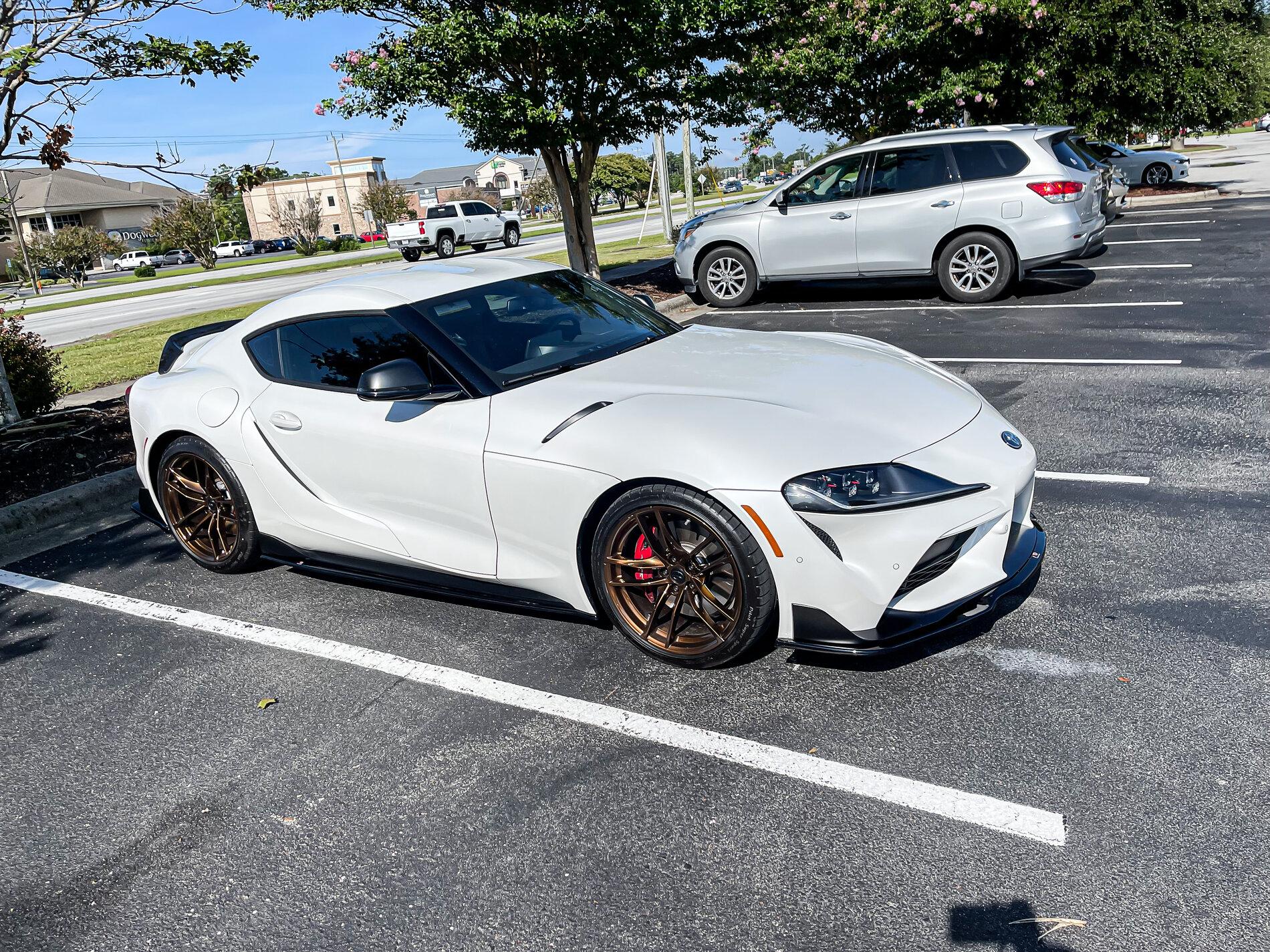

Looks great. I have the V.3 sitting in my garage. Did you have a body shop install it or DIY? Seems really straightforward--I just don't have the equipment handy to do it.

Didnt have time to do myself. Paid the $100 to have someone do it

If you have ramps or jack stands, you're set. The only drilling required is on the lip itself. It uses the existing pop-clips and screws that are already on the car as well as the ones they supply you for a more secure fit.

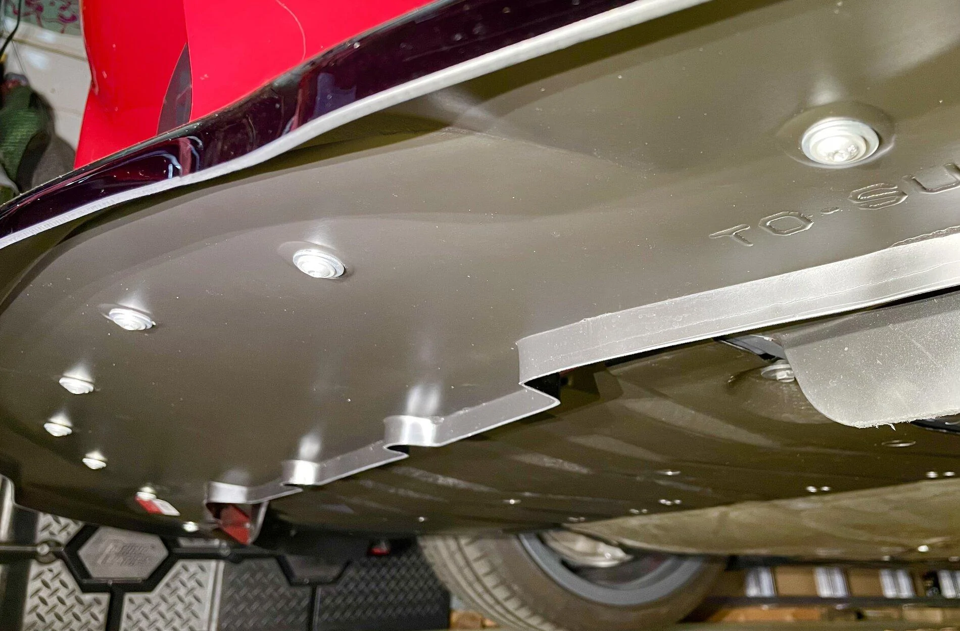

How did you guys manage the nylon lock nuts behind the stock splitter. Mine were a pain in the ass! I used an open ended wrench wrapped in electrical tape to hold the nut. Then a small mirror and a flash light to line it with the stock holes.
I used all new hardware with it, see pic. Those pop clips don’t do much at 135+ mph.

Kit looks real clean ?? Love the color on the rims too.
