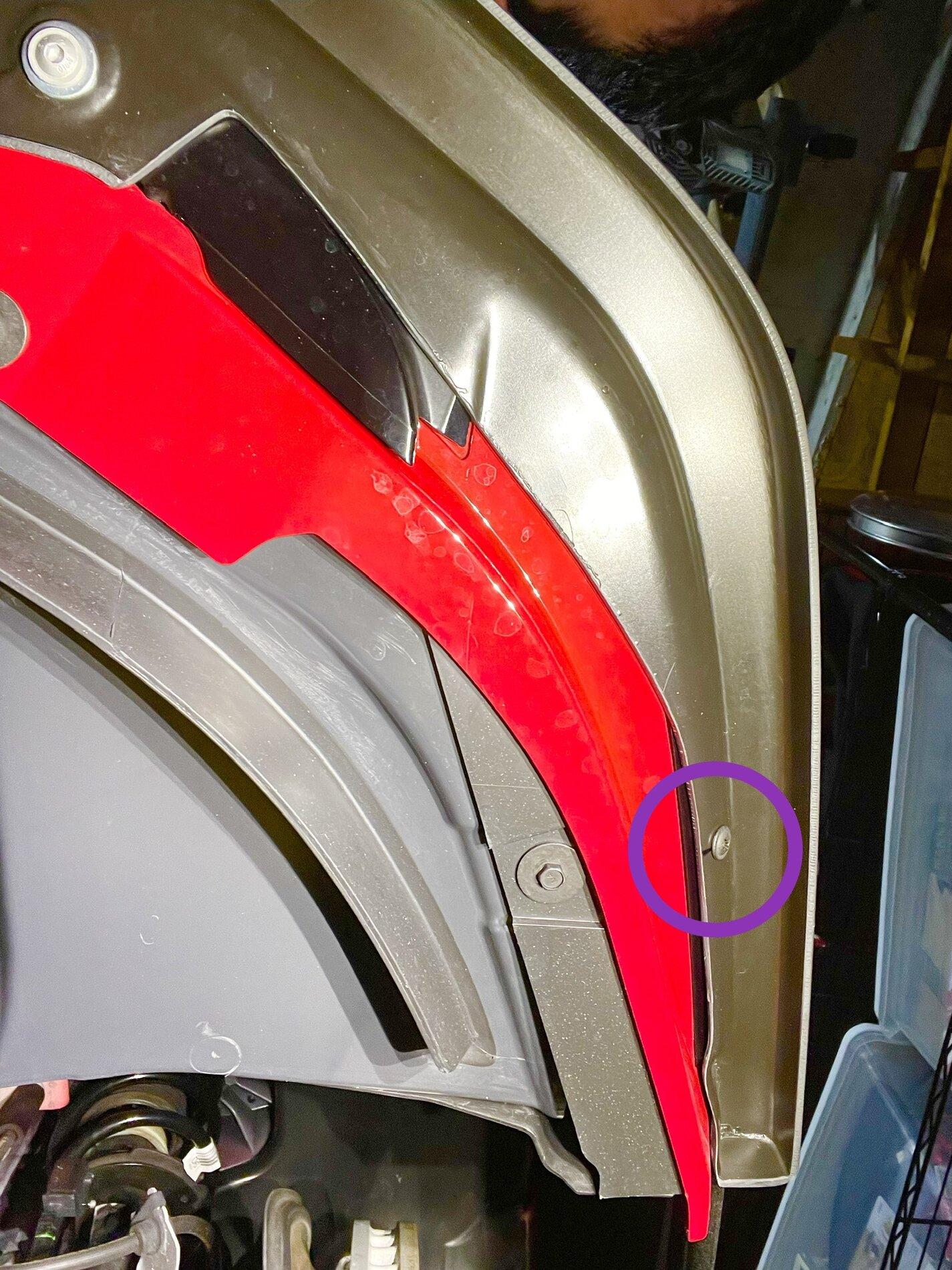

So I dropped my car off at a body shop to have them install my maxton kit with V2 lip. I got the car back today and the Side Skirts and Spats are perfect, but I think something is up with the lip. It has gaps on the outer edges of the front bumper and its sitting up above the bottom of the bumper, like so.....
And this is what it looks like from the front.
This doesn't look right to me, I feel like the front is fitting correctly but something went wrong mounting the sides. I feel for sure the guy did something wrong on the lip? Skirts and Spats are perfect though.
I tried 3M tape on mine but it separates over time. These isn’t enough surface area to hold it in place and hide the tape.
Here is what I did on mine. I drilled a small pilot hole into the splitter and the side molding then installed a short trim screw.
The side molding for the front splitter is only $37 so no worries about installing a screw into it.
-RJM
-RJM
Thank you for this pic!
