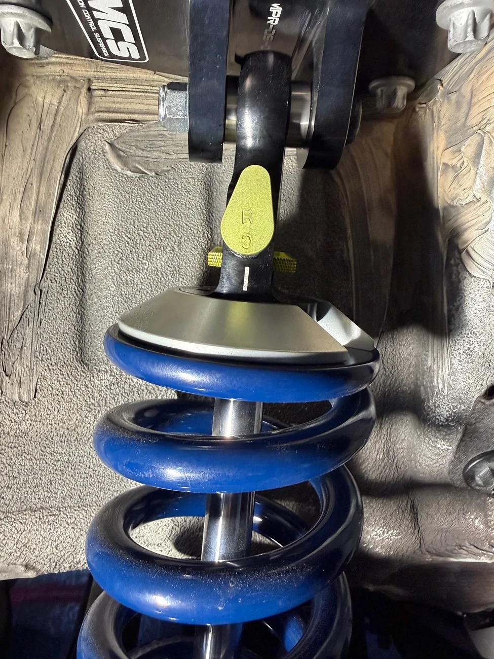

Installed the coilovers and fixed a couple of issues with a broken sensor.
as per manufacturer check HERE the initial adjustment is
Compression: 4/8
Rebound: 8/18
which is straightforward in the front. But in the rear (see pic) the orientation is confusing:
The adjuster is at the top of the strut. I think the adjuster on the pic is in Compression, as marked by the “C” on the line. But watch how the “C” is backwards.
the instructions call for the adjuster to be set to 0 by turning it clockwise and then turn counterclockwise to 8.
but because the adjuster is backwards the direction of the turn MUST be the opposite. Right? So in my case will be turn counterclockwise to 0 and then start counting to the desired setting by turning clockwise.
I hope I’m making my question clear.

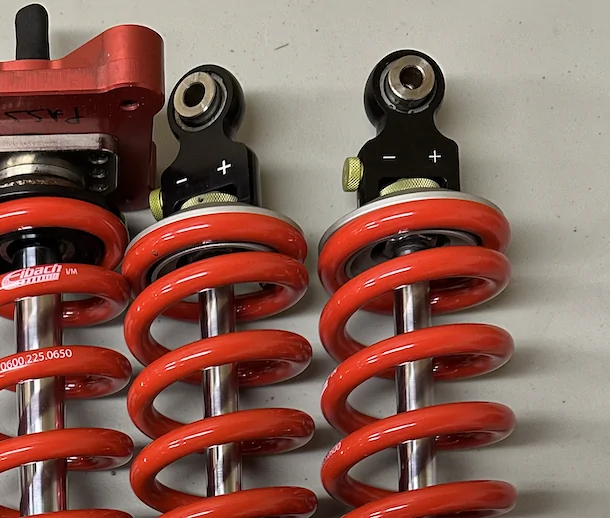

Turning the circle clockwise is minus, turning it counter clockwise is plus. There should be - and + markings on the side (see photo below)
The selection is currently on compression in that photo. When you flip it so the R by the line it's rebound. Looks like they changed that adjuster a bit. Mine is a circle. (see photo below)
The knob adjusts both Compression and Rebound, depending on how you have the lever set.
Compression has 14 clicks of adjustment
Rebound has 18 clicks of adjustment

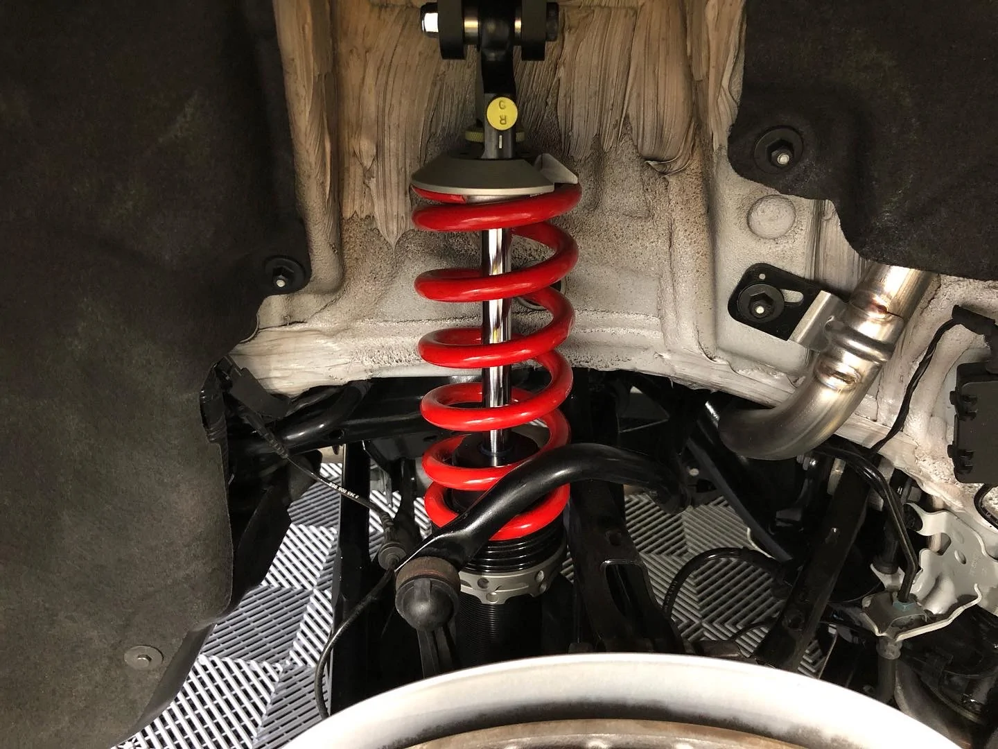

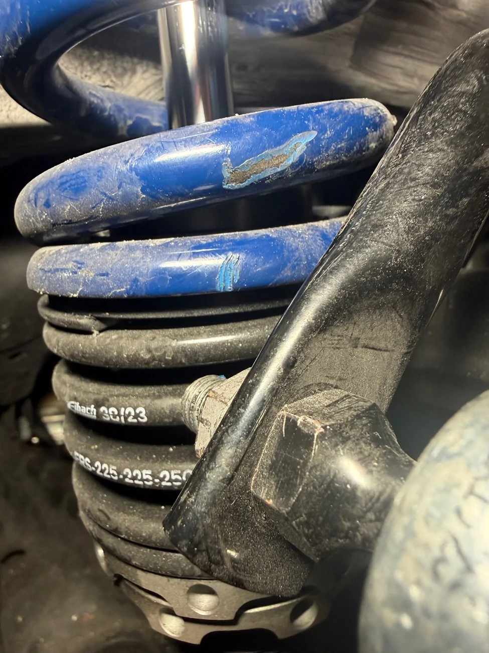

Small Update
Leaving things here for the collective knowledge base:
after installing the coilovers my
Rear right seemed rough with metallic noise on deep compression on the street, so just lifted up the car and found contact between the Verkline sway bar adjustable link upper screw and the spring, both rears.
will have to place some sort of spacer there I just need 2mm to clear it.
also need to put the dust boots on the links, I got the one tool that is needed. Will add yet another update to this thread.
8,807
17,280
Yup. You can cut the threads and that will help.
Mine self cleared over the years. Lol
