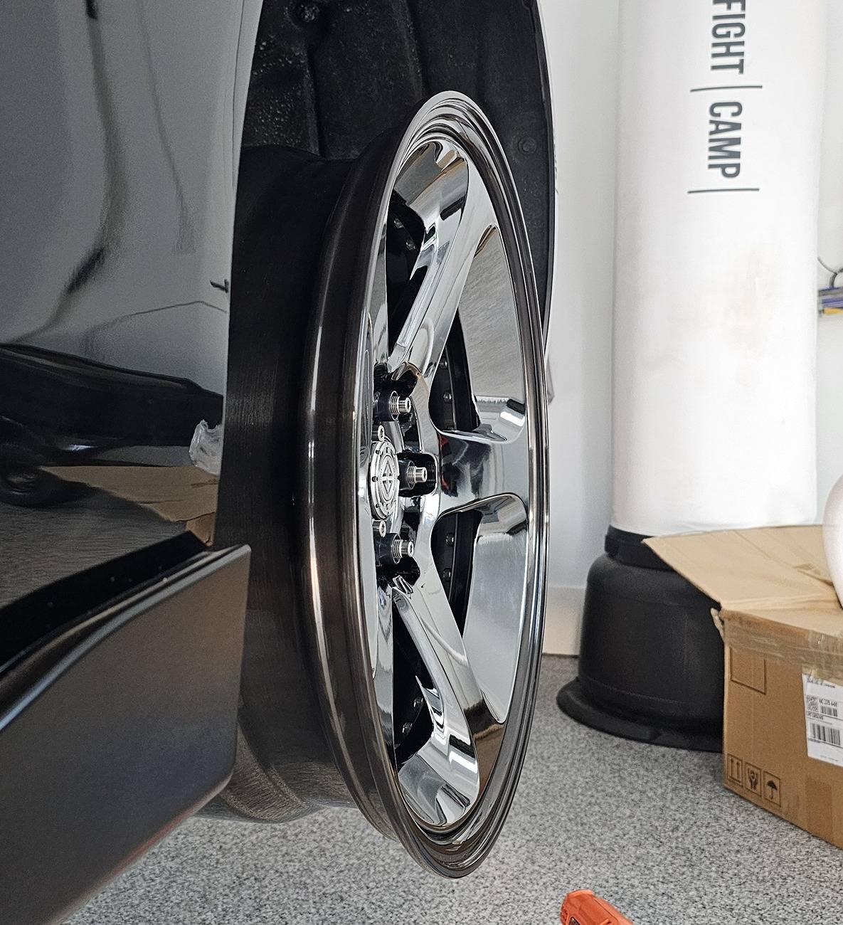

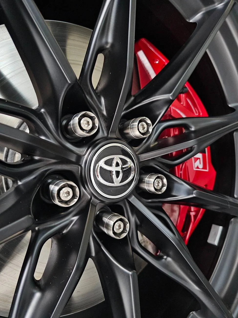

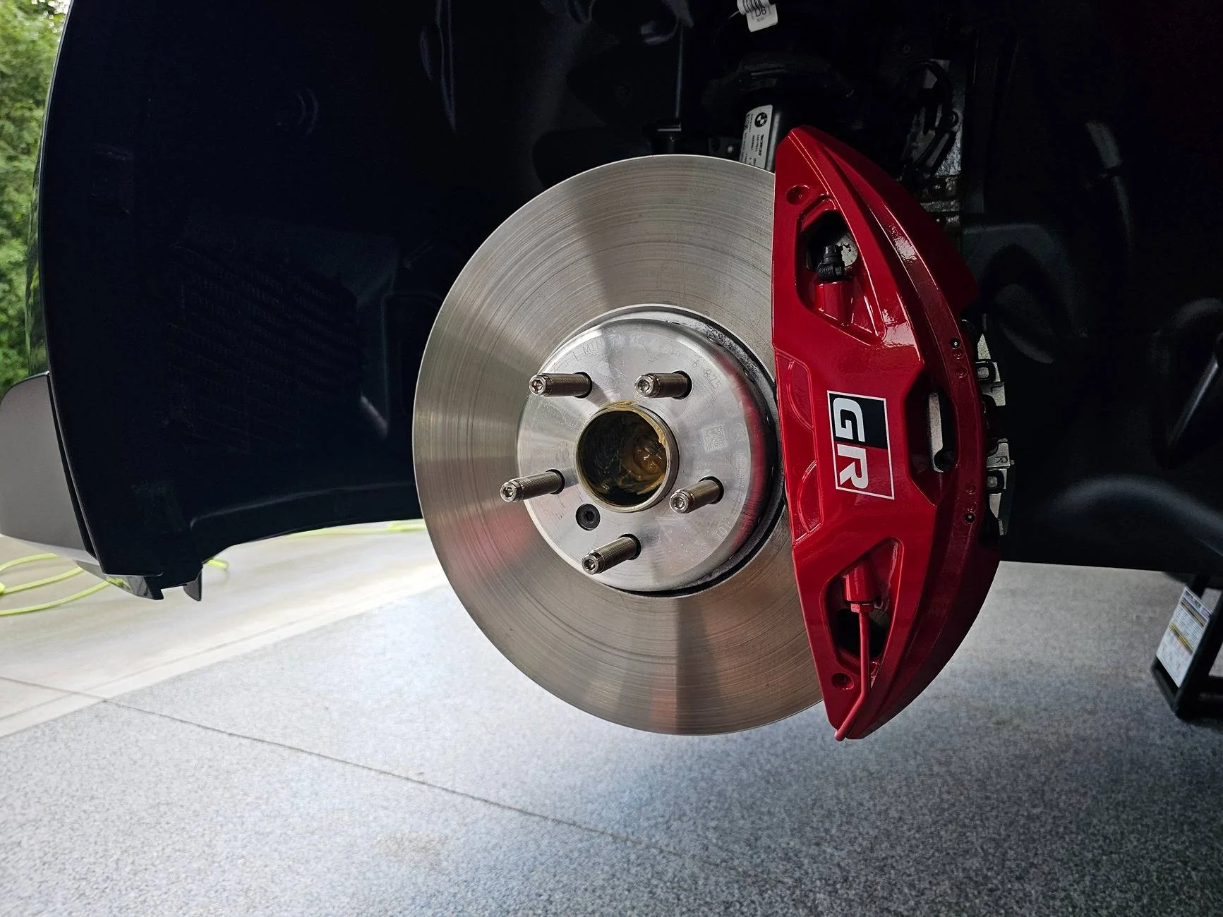

I guess these studs are my first modification to the car. I ordered 2 different set of nuts. I have one set in raw titanium and another set that's black. This way I'll have the option to swap them out whenever I want something different. I also test fitted my other set of wheels a few days ago to see if I got the fitment right. Looks good so far:
This took WAY longer than it should have to swap the studs in. The back tire got stuck on the lift... it was the last one left. Reinstalled the tires. Brought the car back down. Moved the lift. Lifted care back up. Took one tire off, then checked the problem tire to see if it was still stuck... and it was still stuck. Put the one tire back on. Lowered the car and it sat on top of one the the hydraulic hoses. I couldn't move the damn thing. Lifted it back up. Moved the hose. Tripped on the hose which caused the fitting at the base of the lift to come loose and start leaking fluid. Fixed that... Then after all that I was finally able to do the conversion.
I have a feeling everything I do with this car is going to be the same Looney Tunes bullshit.

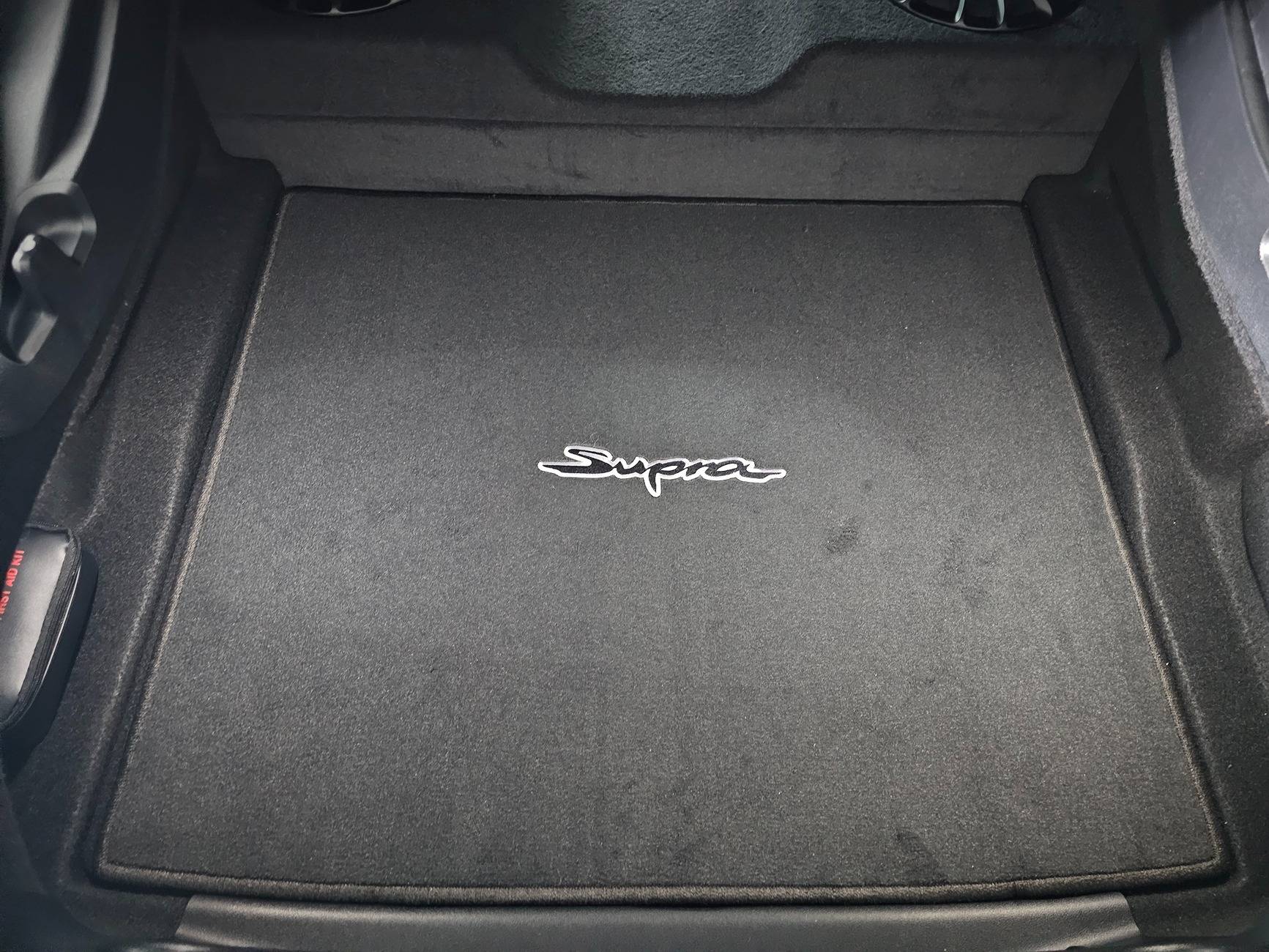

I also bought a trunk mat since this dumbass edition car didn't come with one for some reason. This took 2 hours to install as well.

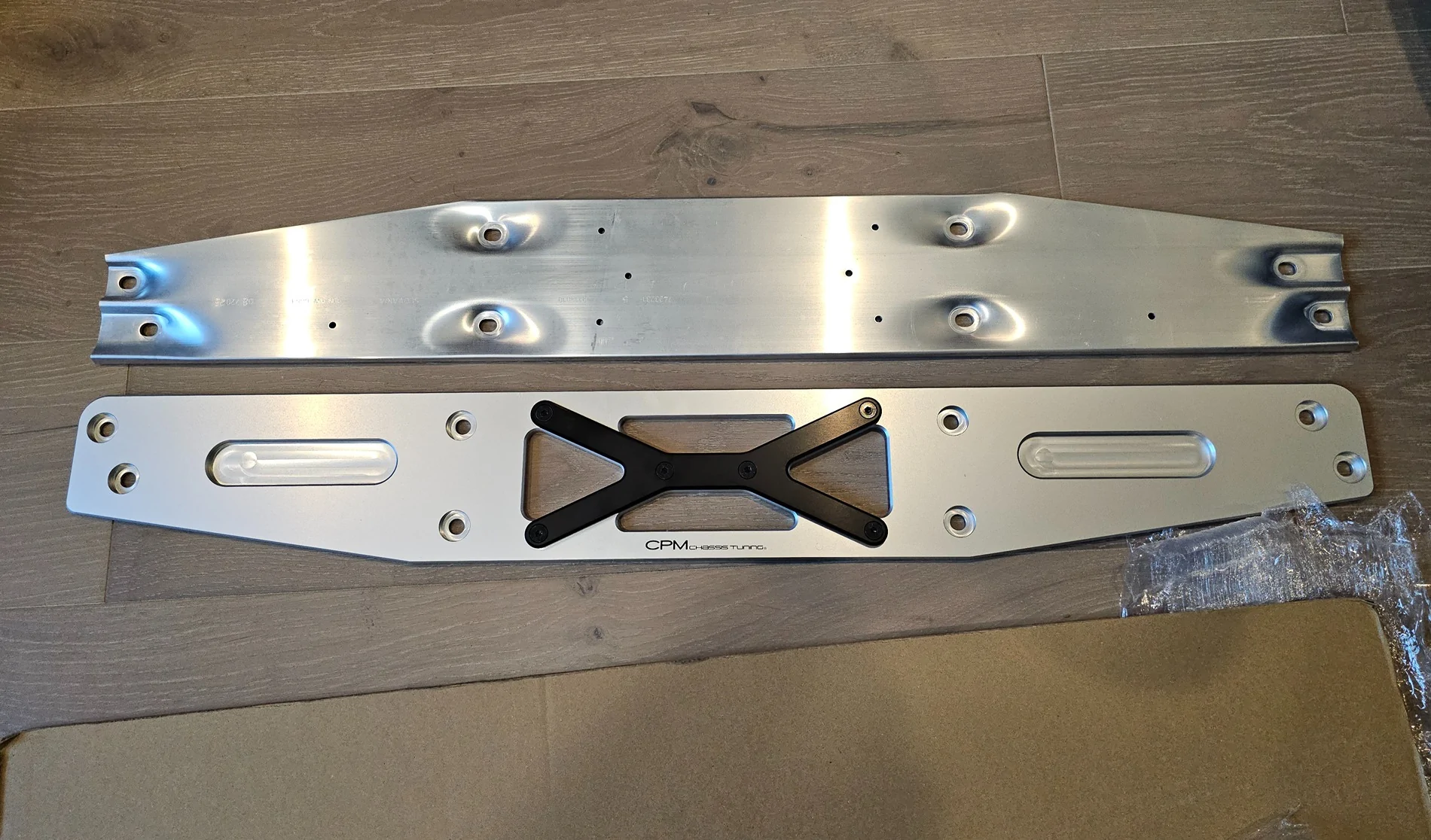

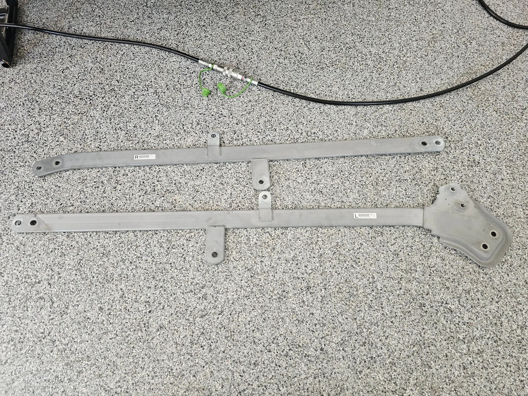

Pulled this stuff out today:

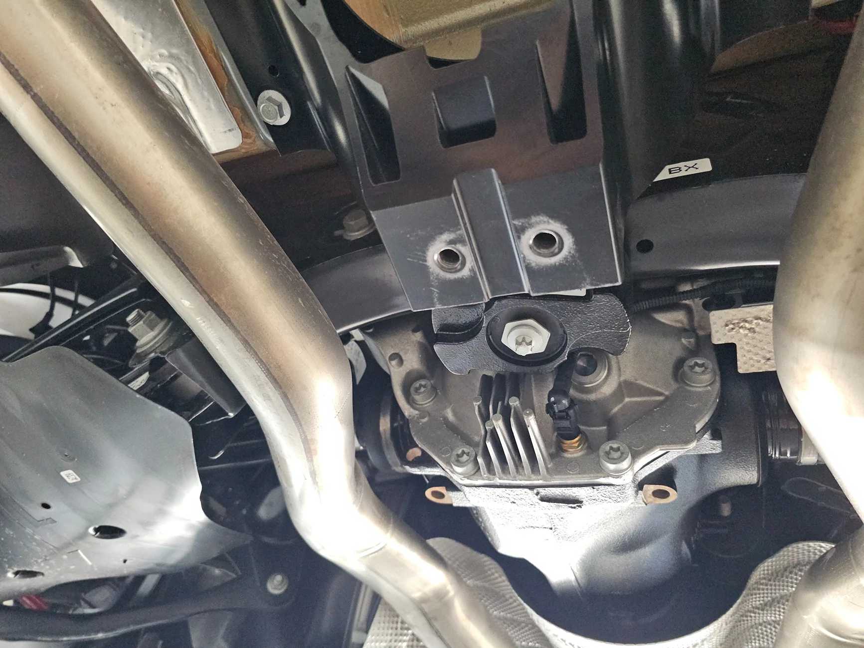

I'm guessing this is what the Z4's brace looks like since it wouldn't need the arms welded to it. I decided to go with the CPM brace since it doesn't come with the arms and looks really damn nice for something no one but the owner will ever see.
Took the bracing off in the very rear to get it powder coated in semi gloss or satin black to match the big ass mounting bracket. My wife was confused about this and asked me why I would get it painted if I won't ever see it. I responded with, "I've got problems."

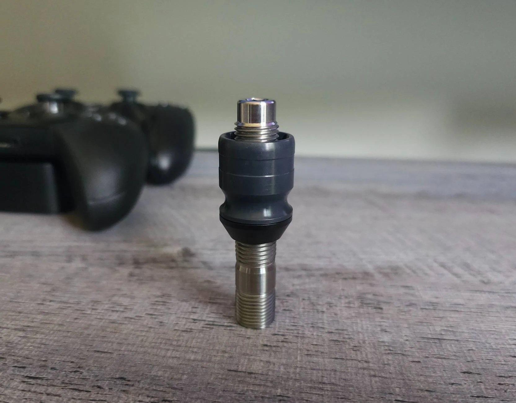

You mind posting your wheel stud setup/brand again? I think it was deleted when we had the update.

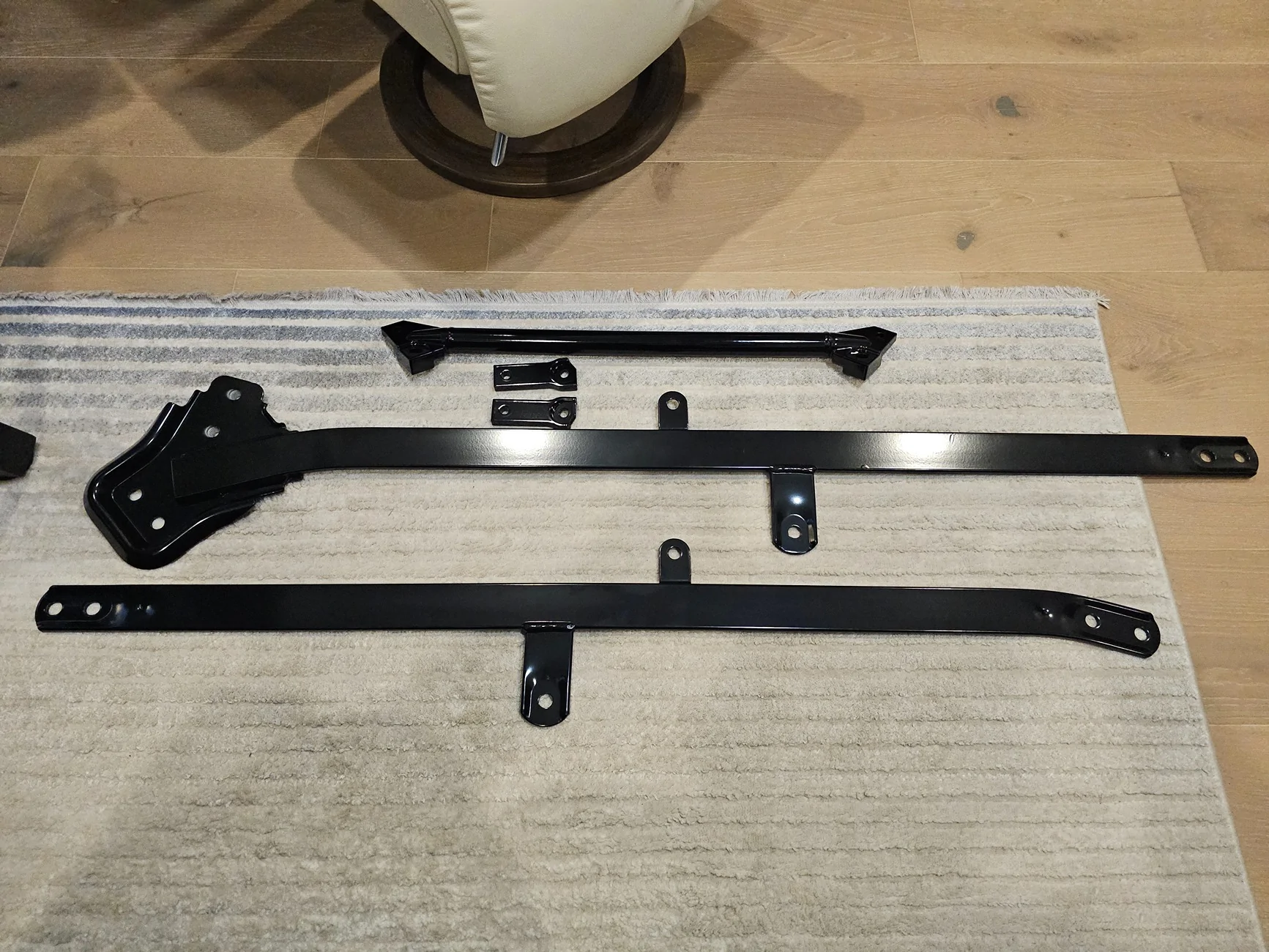

Got my the under brace and the strut damper pieces back from the powder coater today. One in high gloss and the other satin. I know the underbrace will never be seen by anyone, I just think it will match up nicely with the black mounting bracket instead of being raw metal. Also... the under bracing is super legit and have a bit of weight to them.
I've got some titanium hardware that should be here tomorrow that I'll be using to get the strut damper installed.
I got them from a machinist in Virginia. He also has an Ebay store called Zakgear.

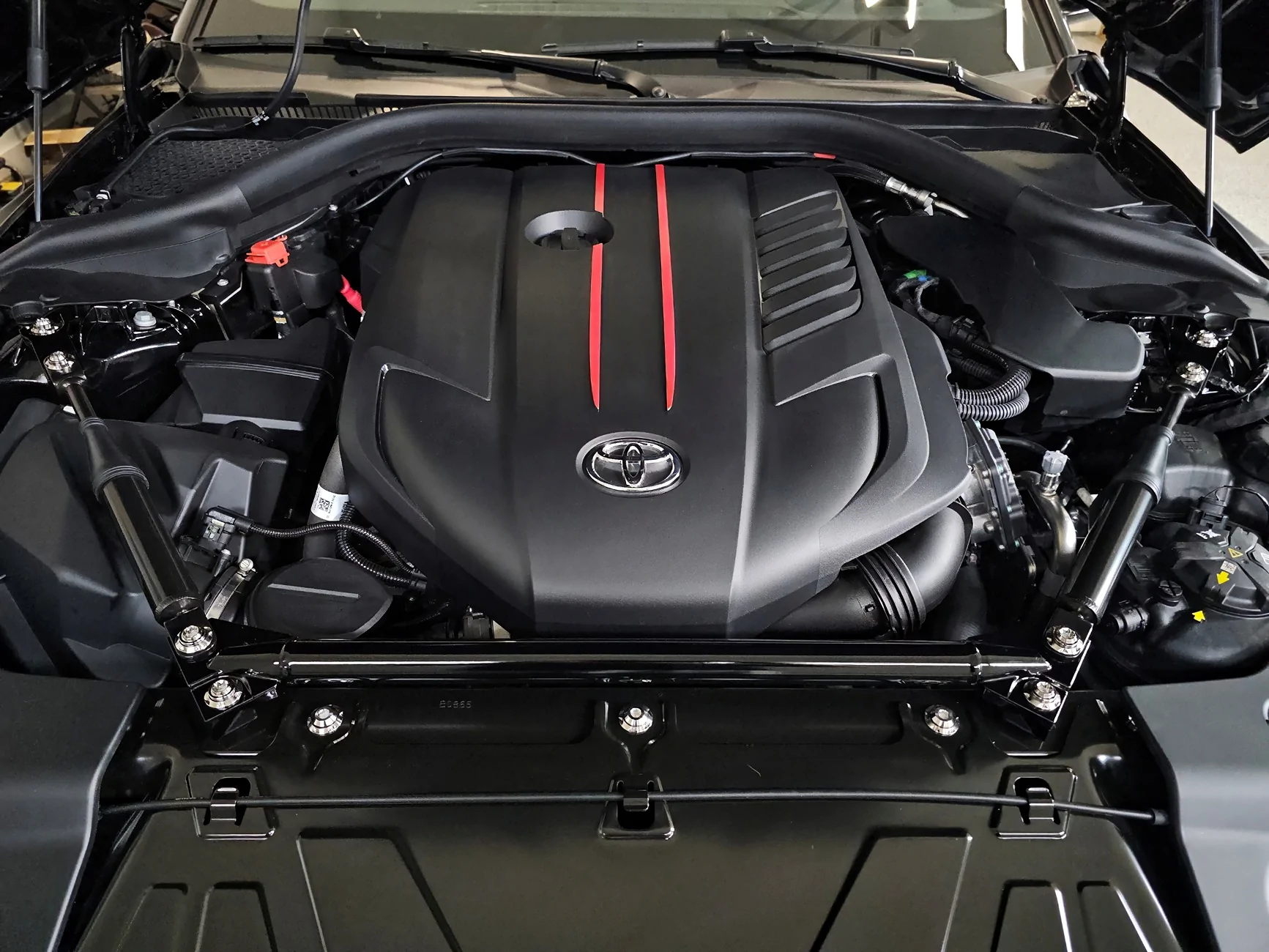

Got the strut brace installed today with the new hardware. I dropped one of the washers in the radiator bay somehow. Luckily I have to mount the bottom brace, so I'll try to find it while I'm under there. I wouldn't think anything of it if it wasn't overpriced titanium. Is additional time out of my life worth a $3.50 washer.... Yes.
