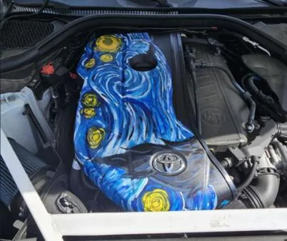

Saw this one on the gram. Reminded me of you previous build.
-RJM
I'm still not sure what I'm going to do with the engine bay. I'm thinking of staying away from carbon fiber this time, but I want to make it pop. I'll figure something out. As of right now I'm going with an EOS/CES bottom mount turbo, so that's not going to be seen.
