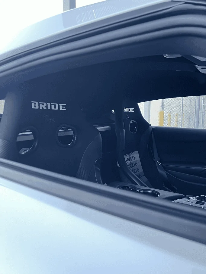

Installed some Bride Zieg IV Wides. I have the Cusco trunk harness bar but getting that powder coated soon since im not the biggest fan of the blue. Still have to order a set of 6 point harnesses (the seats came with the Takata drift style 4 point harness and was advised to get 6 for track).
Install wasn't bad just had to mess with seat belt receptacle and coding out the restraint errors. A buddy with protool coded everything out but still have the seatbelt light on the dash. Not sure if there is a way to get rid of that entirely.

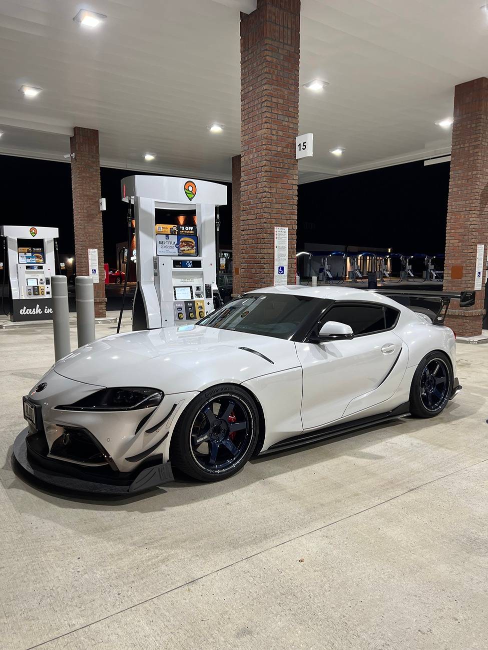

Upgraded from the Sayber front lip/splitter to the Verus high down force splitter. Needed something that wouldn't cause issues during HPDE events.
Install wasn't bad but realized that Sayber splitter caused the smaller crash bar to flex to where the Verus splitter didn't sit as flush. Ordered the Verus splitter support kit so that should fix the issue. Also installed the new vented end plates which won't necessarily help me on track but it looks good. :cool:
Nice to know they fit! I've been trying to find people running this in the A90. Is the shoulder bolster rubbing against the door card?
:thumbsup: Depending on how far back/angle you want the seat they do contact the door card but where I have it setup its barely touching it.
