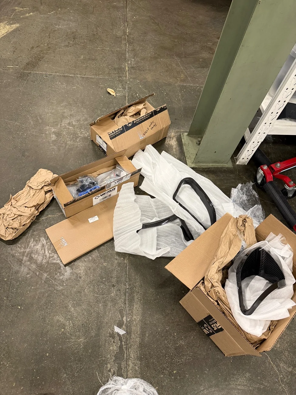

Bunch of Verus parts arrived as well as hood vent from @rwense
Going to get installed in early January with the rest of the aero

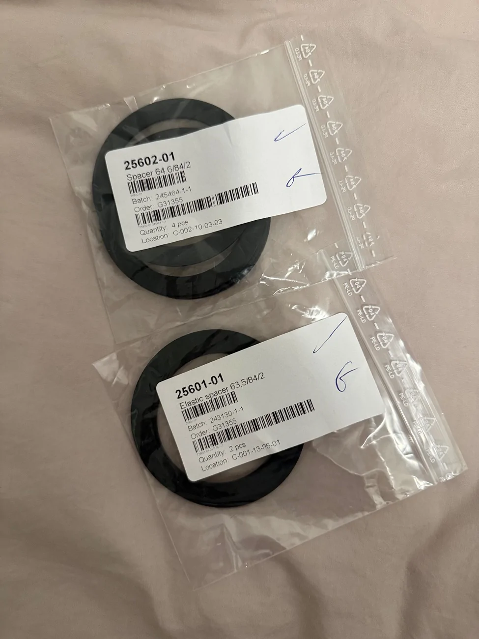

Also replacing the rubber spacers on the Ohlins in an attempt to solve grinding noise from the springs.
