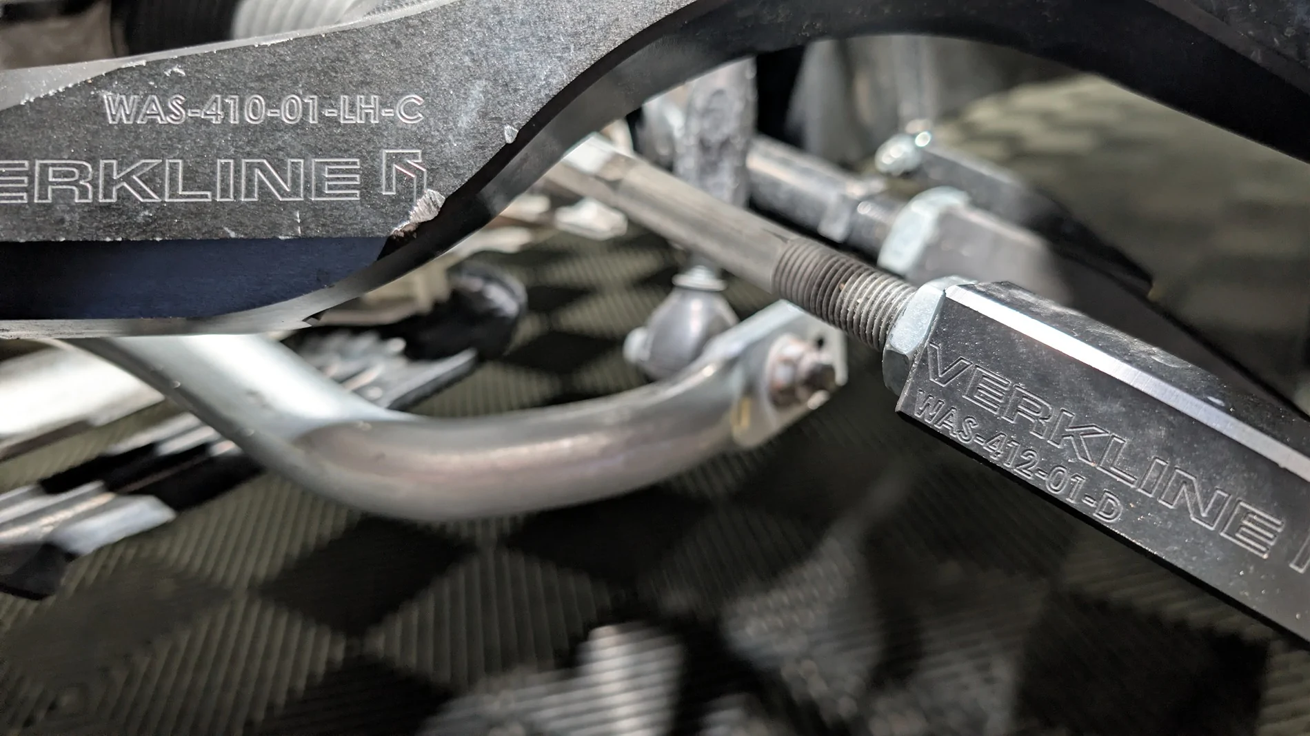

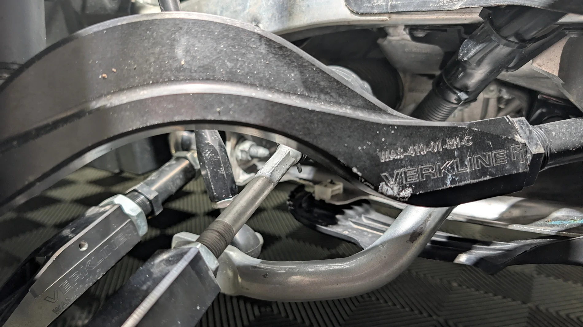

Got my car back after another 2 week delay and dug into it today. All I can say is what a fucking disaster. I cannot believe that a place that advertises itself as a race shop and specializing in setting up cars for track use can be this fucking bad. I don't feel like writing up a long post right now but here are my notes on what I've found so far. I still haven't touched the nuts on the front suspension knuckle, I'm sure they're fucked up too.
I'm going to miss another paid for track day on Oct 17th now. Already missed a paid for track weekend on Sept 19 over this shit. The whole point of this was to save myself the time of doing it myself to have it completed quicker. This entire experience is an exercise in why you do your own work. I have very low expectations any time a shop touches one of my cars but this... come the fuck on. Straight up put a completely unsafe car on the road TWICE.
After 6 weeks of being in the shop the car was returned to me with these issues. Car was not thoroughly inspected and was returned to the shop.
  • Car pulls hard right, does not drive straight at all
  • Lots of clunking from the suspension on all corners.
  • Drivers front flca subframe completely loose with nut about to fall off
  • Drivers front caster arm subframe completely loose with no torque on it
  • Asked for ride height to be adjusted as part of alignment in initial instructions. Was not done, had to go back.
  • Oil cooler had a slow leak
  • Asked for all bolts and arm adjustment nuts to be paint marked, not done
After 2 more weeks at the shop the car was returned to me. Some changes that the shop would not elaborate on were made to the rear. Car was corner balanced, ride height adjusted, and realigned.
Was given car back second time claiming right pull was fixed. Immediately noticed car pulls hard right pulling out of shop. Steering is off center. No way in hell is this going back.
  • Front and rear endlinks loose with only half its torque applied. Correct torque is 56nm
  • Passenger front flca subframe torqued to 90nm. Correct torque is 100nm + 90
  • Asked for all bolts and nuts be paint marked. Not done on first round. Asked for this to be done again, only some are marked.
  • Loctite not used at all, asked for loctite to be applied per instructions. Only applied to adjustment nuts on some arms. Do not trust it was used in all places and do not see evidence of it.
  • Front roll center spacer missing for both sides. One used in install. Front bump steer is using all spacers creating a 5mm mismatch between roll center and bump steer in the front.
  • Front drivers side caster arm to subframe bolt completely loose.
  • RLCA damper bolt torqued to only 60nm both sides. Correct torque is 100nm + 90
  • Rear traction links both sides to subframe bolt not torqued and completely loose. Correct torque is 100nm.
  • Rear lateral bent links to axle hub only at half torque spec both sides. Correct torque is 100nm + 90
  • Rear lateral bent links spare lock out plates are missing.
  • Rear lateral bent links to subframe loose, very little torque both sides. Correct torque is 100nm + 90
  • Second alignment rear camber was set to -2.5, requested -2.2.
  • Car has no rake when specific rake was asked for and measures 4 3/16 from the jacking points to the ground both front and rear
Car now needs all nuts/bolts fully replaced that were previously provided to shop since nothing was torqued correctly and there is no way of knowing whether they were torqued at one point to spec and then loosened with follow up changes.
The car will need the subframe and arms inspected where bolts were never torqued to see if the bearings and subframe bolt holes have been ovaled out.
The car will need full ride height adjustment, corner balancing, and another alignment assuming no damage.
Will have to contact verkline and hope they will sell me the missing parts.
The front bump steer and roll center spacers will have to be adjusted.
Essentially the entire verkline install, ride height adjustment, corner balancing, and alignment need to be fully redone. If damage is found then all damaged components will have to be replaced.
Fuck me.

First finding of the morning. The tie rods are set half an inch in length difference. This is causing the passenger side wheel to contact the caster arm quite badly. The driver side just barely kissed it once. I have steering rack limiters waiting to go in but it won't help with this difference in tie rod lengths. All of my brand new apex wheels are dinged up because of this and so is the caster arm. Lock to lock steering position is also noticeably more or less depending on which side and the tire is hitting the inner fender liner on the passenger side. Length of visible threads on the tie rods differs by 10mm from side to side. Morons.

Back on topic: I'd honestly be furious right now, if I were you. When I pay someone to do something, I expect them to know WTF they are doing. Saying that, I'm usually disappointed.
