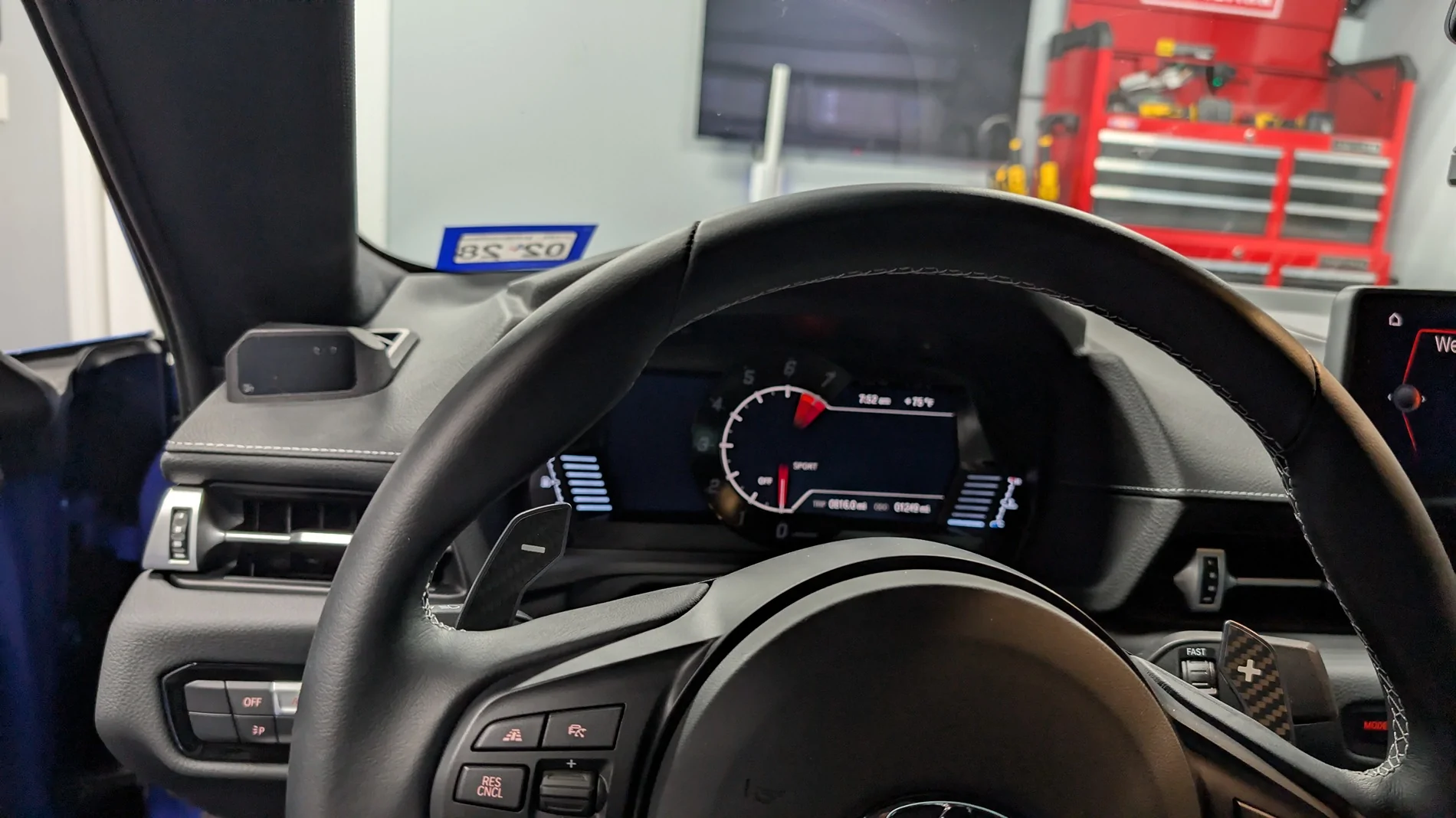

p3 gauge installed, might be the easiest install I've done yet.

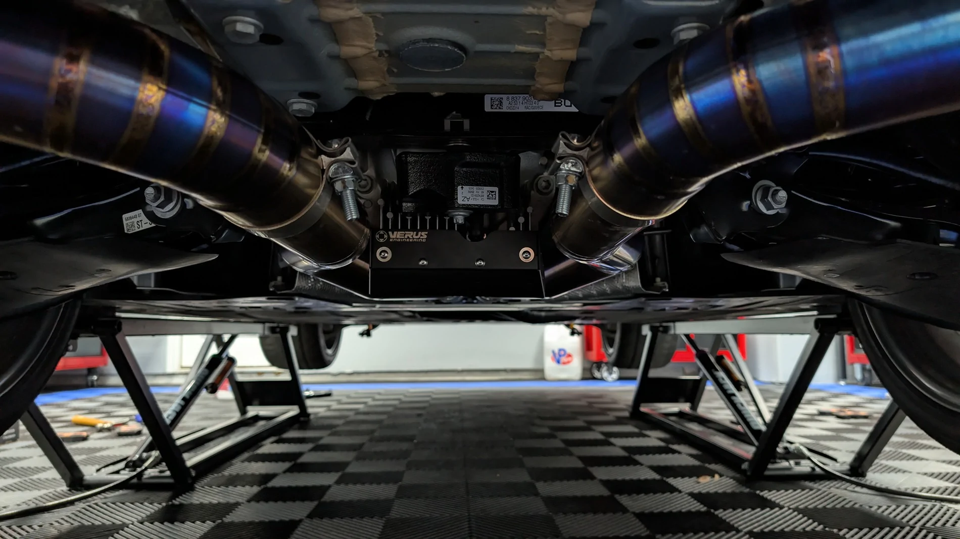

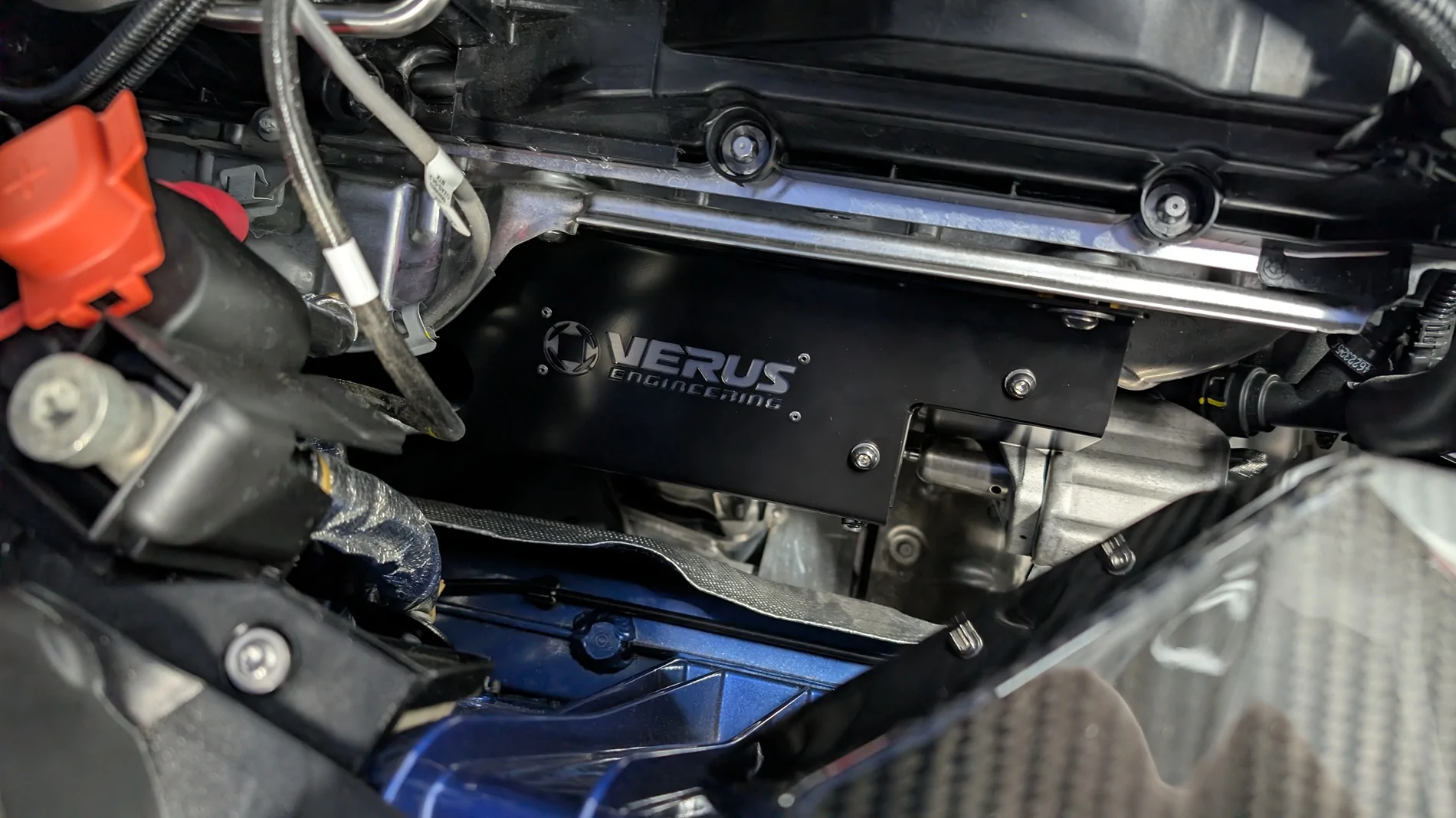

Diff cooling plate installed. Also had to adjust the exhaust again while I was in there. Not loving the fitment of this. May remove it entirely for a different system if it continues to give me problems with shifting after heat cycling.

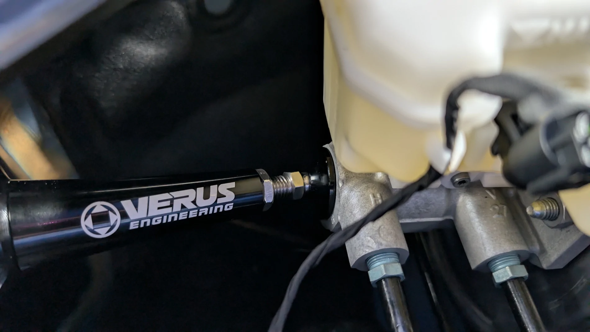

Master cylinder brace

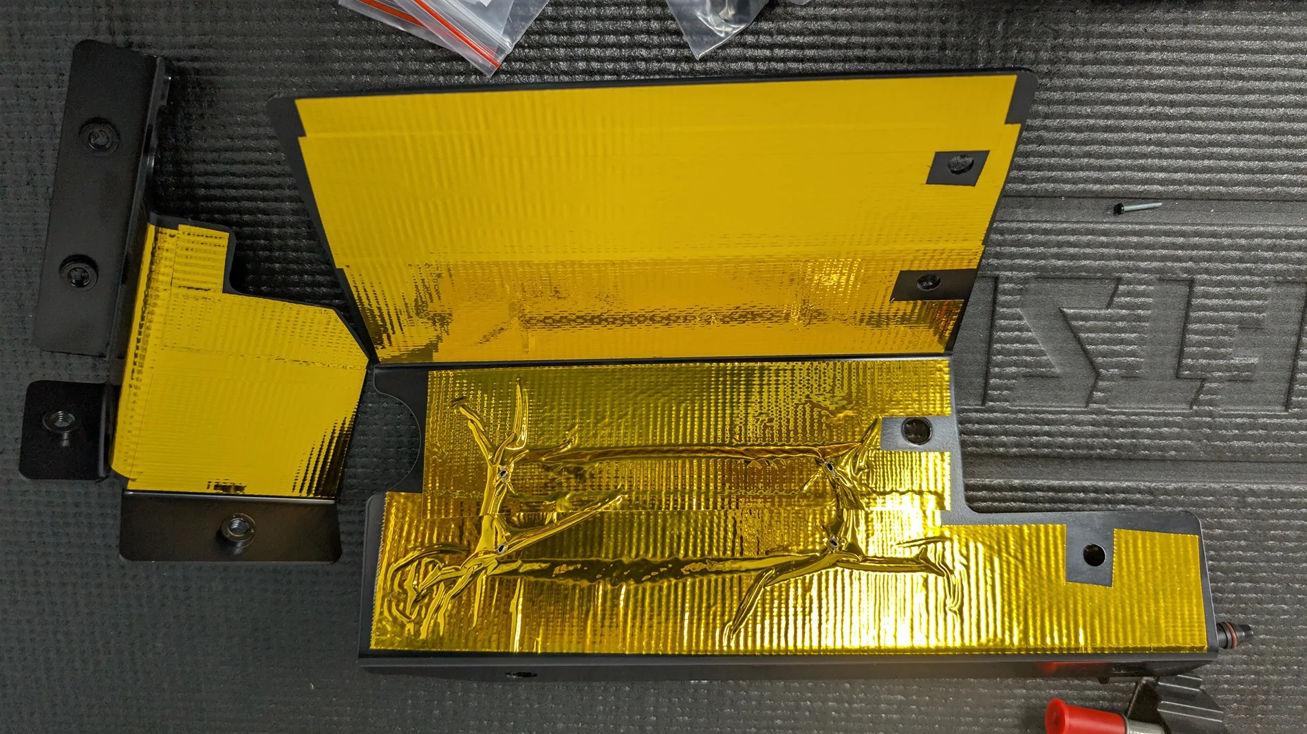

Turbo heat shield, lined it with gold reflective tape.

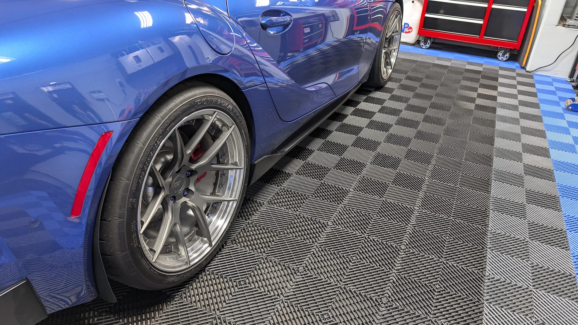

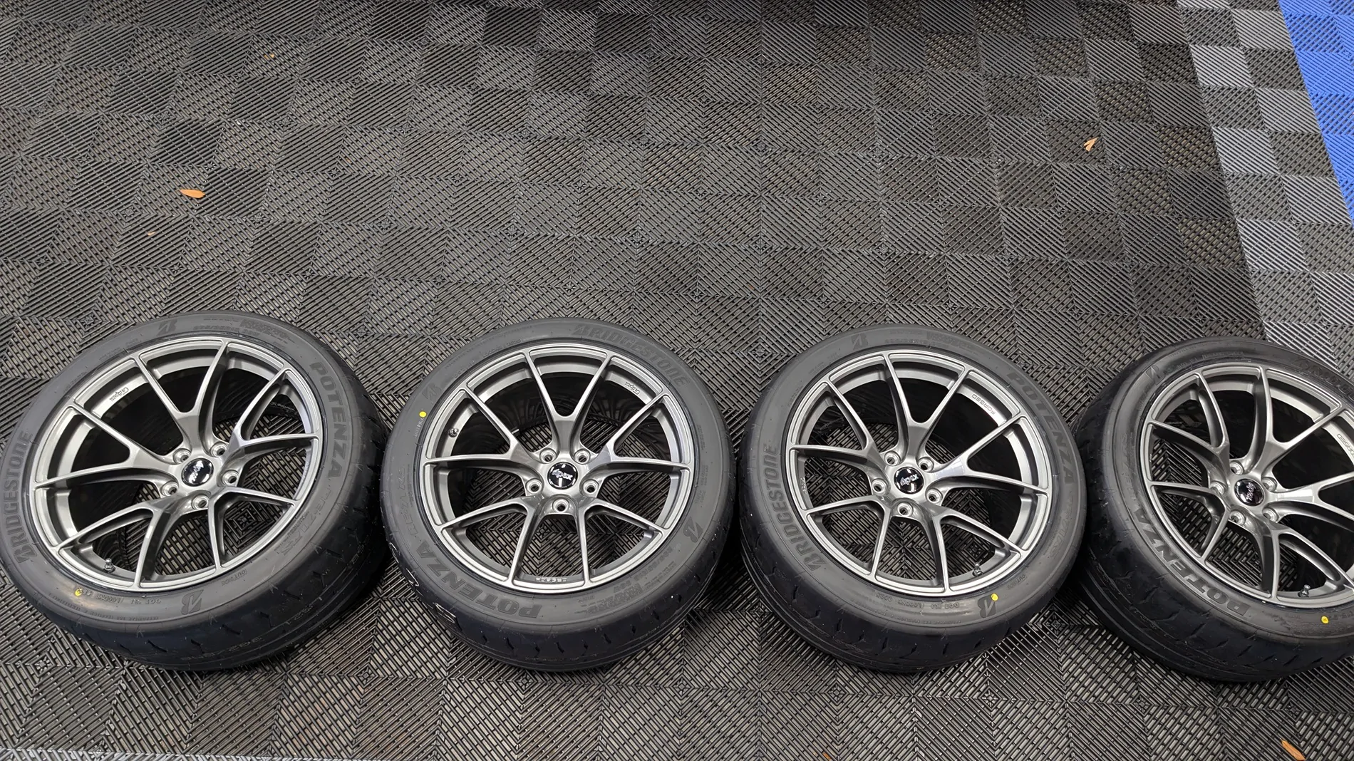

I also picked up a set of apex vs5rs 18x11 +40 square for my track day set during the recent sale. Won't be running these until the MCS coilovers go in this summer. Tires are 295/35 RE71rs. Will continue to buy these for as long as discount tire has stock. $340/each is a good price. Tempted to buy multiple sets while they still have stock but I want to confirm the 35 sidewall is a good fitment first.

Will be monitoring temps closely at the track this weekend on the p3 gauge in the absence of proper logging. I have the verus oil cooler on the parts list but don't care to buy it until its really needed. I think the June track event will probably tell me whether its needed since it'll be 95f+ and 80% humidity by then. After that its off season until october.
Those wheel and tire specs are exactly what I run. They fit with no issues.

Don't see a need for a rear diff brace at this point? Also, maybe I'm completely overthinking this, but did you find the angle needed from the mounting points for the master cylinder brace a bit extreme? I found if you actually pushed the brace against the strut tower so it couldn't possibly shift, the "foot" would barely be able to even touch the MS. I made a super crude drawing lol, the yellow marks the back of the brace. Seems like they should have designed the base to angle more inward from the get go.
Cool, I'll get some extra sets in that case. Not looking forward to paying around $500/tire for the rz.
Only if I can get the diff brace without the logo...
I think the master cylinder brace is fine with the angle.

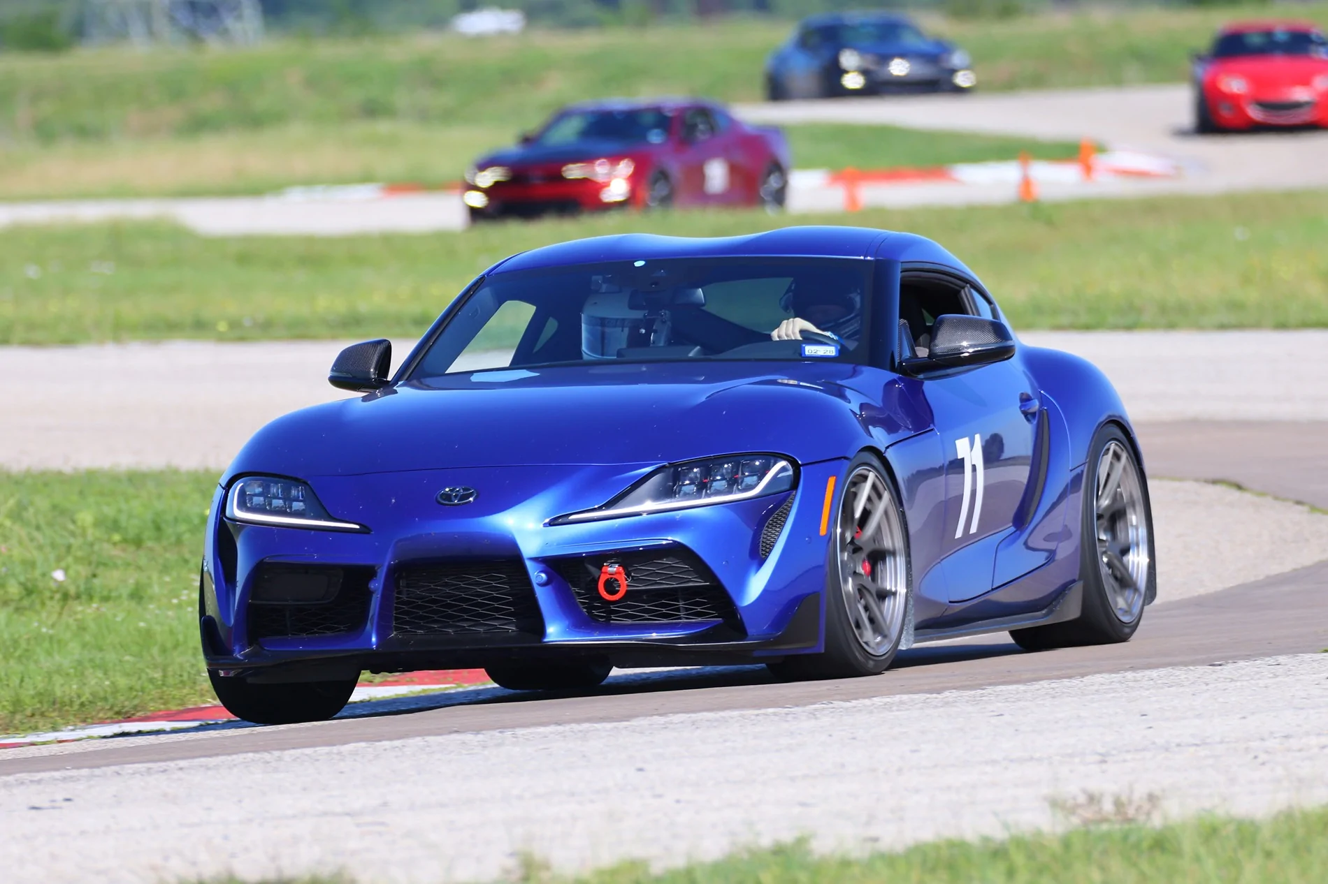

Some pics from last weekend. Ran the track in cw direction so I had to re-learn it since last time was ccw. Fastest time of the weekend was a 1:52.99. Plenty of room for improvement. I did take the traction/stability control fully off this weekend, far more enjoyable to drive with it fully off. Next event is a single day in June, not sure if I'll do this one, it'll likely be too hot.

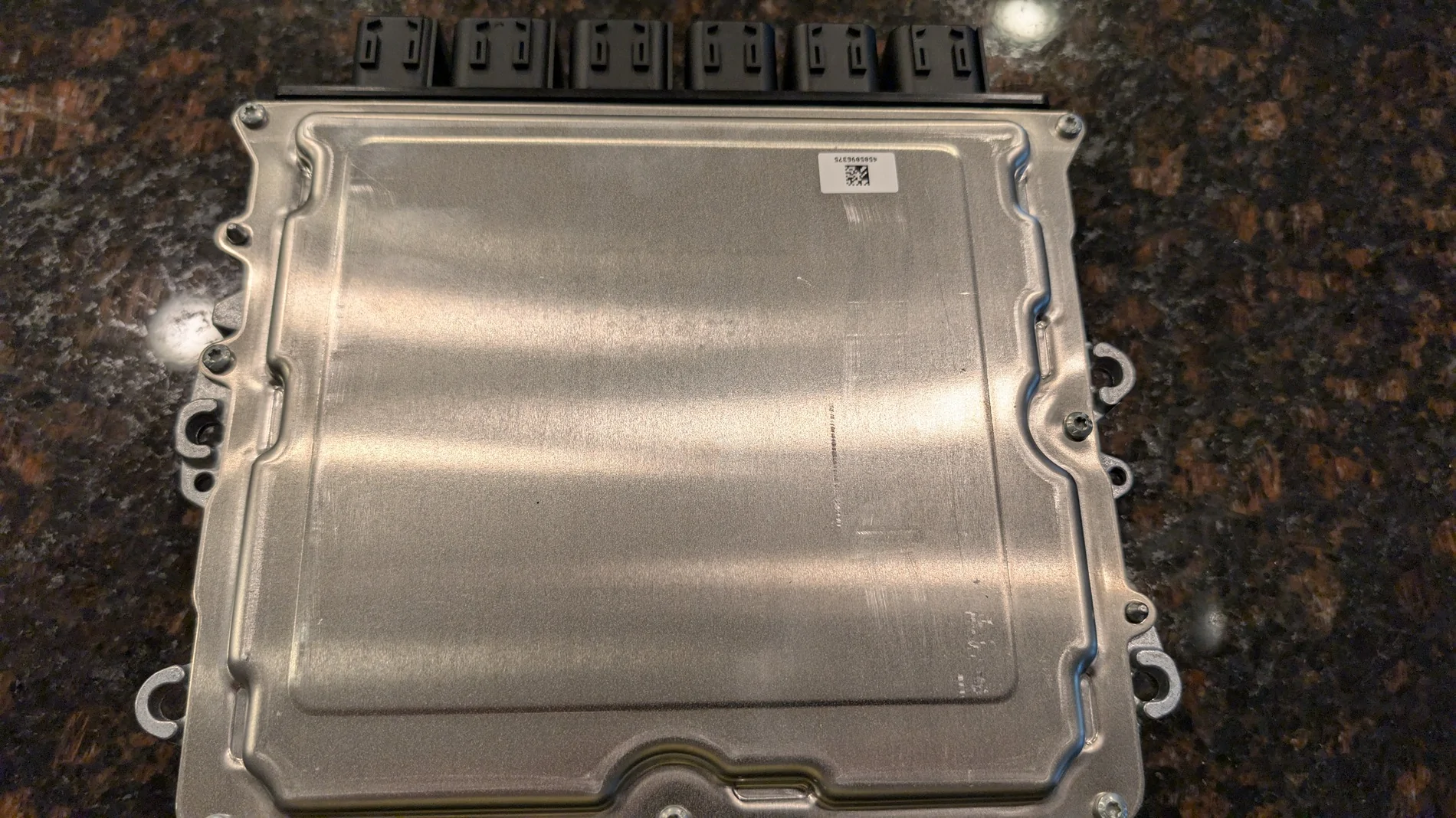

Next round of mods on order. Pulled the dme out last night and boxed it up for a femto unlock and bought a mhd flasher and license. Looking for a remote tuner if anyone has suggestions. Only care about a good track day 93 map.

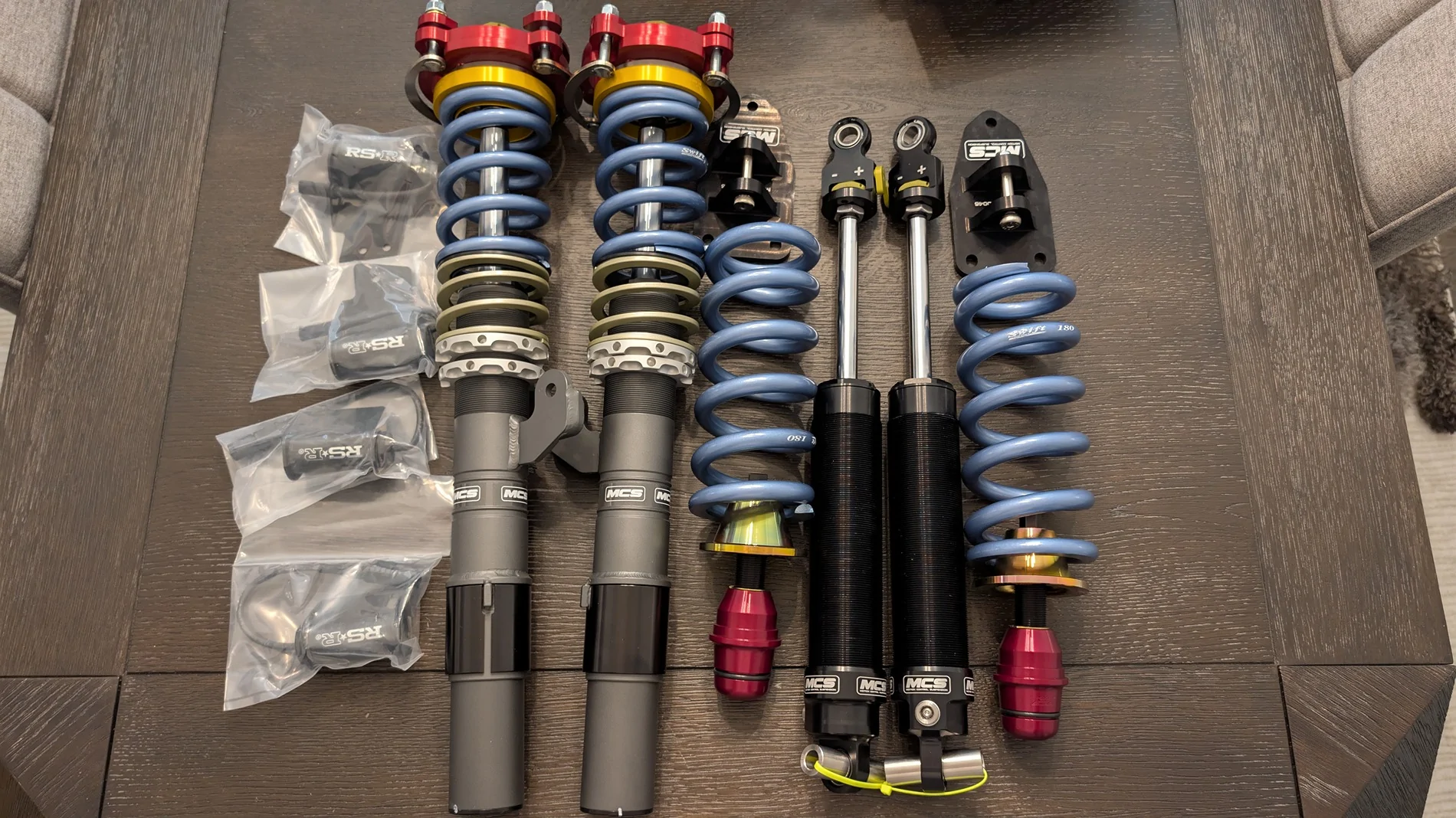

One other thing I'm trying to figure out is spring rates for the mcs coilovers. Vendor I'm likely going to order from is suggesting a 14k/18k divorced rear setup based on where I'm headed with the car. My only concern here is this may be a bit too high for street use. I'll need the ability to travel to other tracks around where I live which means 4-6 hour roadtrips.

MCS 2wnr coilovers showed up this week. Went with divorced rears to avoid swaybar clearance issues.

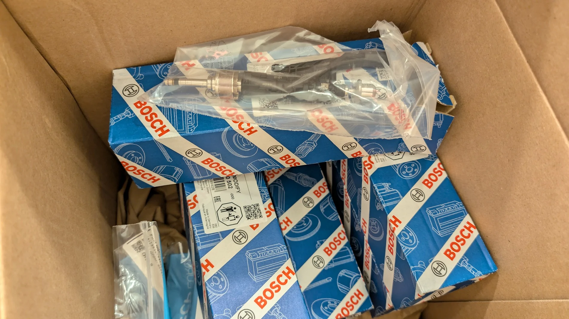

s58 injectors, will be doing a dorch ds25 hpfp and zeitronix eca with it for a flex fuel setup which have not shown up yet. Temptation to run e85 won out since I have a e85 station 5 minutes from my house. I should be able to head down to the track on a full tank of e85 and carry 2 5 gallon cans of it to maintain an e blend throughout the day.

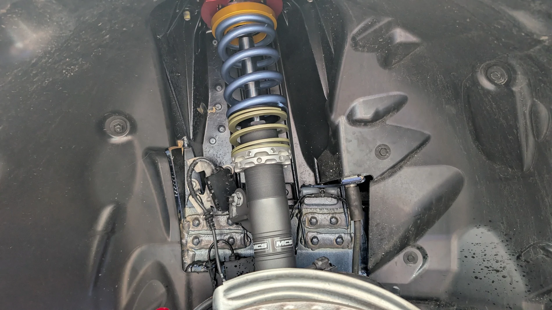

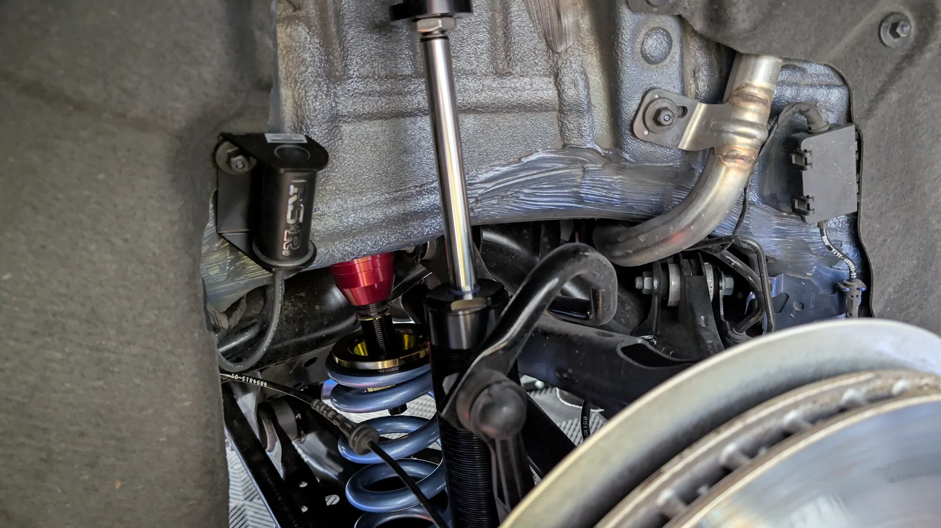

Back to wrenching. Coilovers went in this week. Overall the install is very easy however I took the non-easy path to start with.

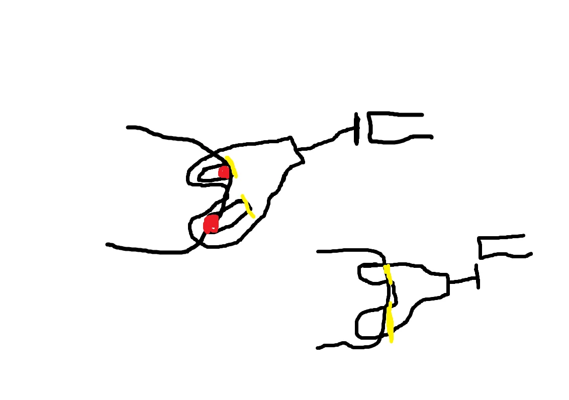

For the front, ignore anything that suggests keeping the strut bolted to the strut tower, using a pry bar between the pinch joint, then pushing down on the hub to get the front struts out of the knuckle. Its an exercise in frustration. I've actually never had to deal with struts mounted using a pinch joint. Get a knuckle spreader tool for $20 on amazon. Remove the four bolts on top of the strut tower to drop the strut. Loosen the lower control arm bolt at the subframe to get the strut low enough to clear the upper fender well and hang outside the fender. Use the knuckle spreader tool to loosen the pinch joint. Twist and pull the strut out, it should come out easily. Hopefully this helps someone looking to do this job.
Anyways, coilovers are in.
After 1 round of adjusting the ride height I'm happy with where it sits now. I haven't driven it yet, not sure if I will until next week, weather has been shit all week and I'll be busy this weekend. Expecting the springs to settle a bit then I'll check the ride height again.
HPFP, injectors, and ECA are up next.
