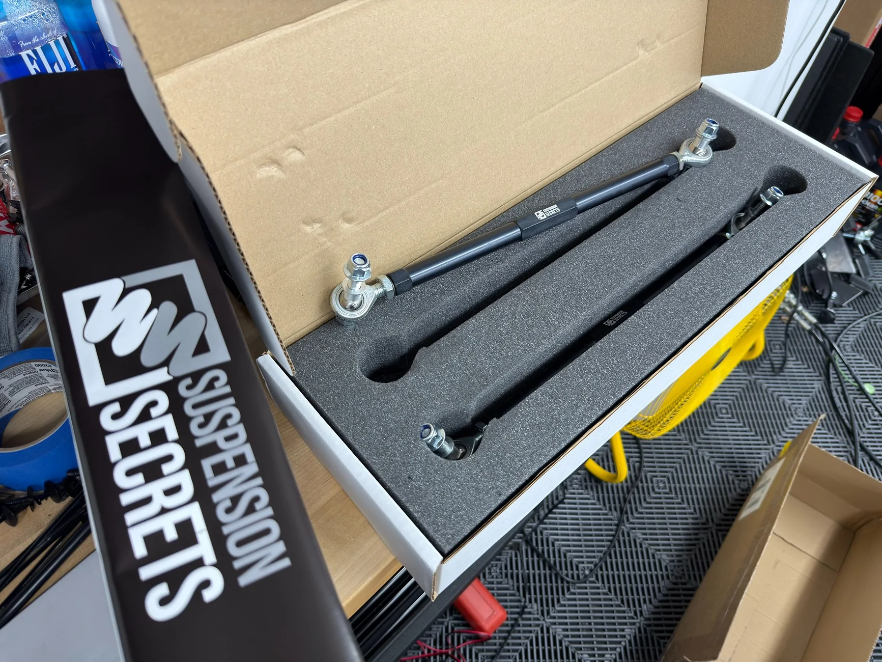

Verkline, Suspension Secrets, BBT
How well do the verkline suspension bits hold up in general? I have basically the full verkline suspension setup included in my buildout spreadsheet.
8,733
17,109
Much better than SPL for sure. The SPL bits I swapped for Verkline have had no issues. I can't say the same for the SPL bits.

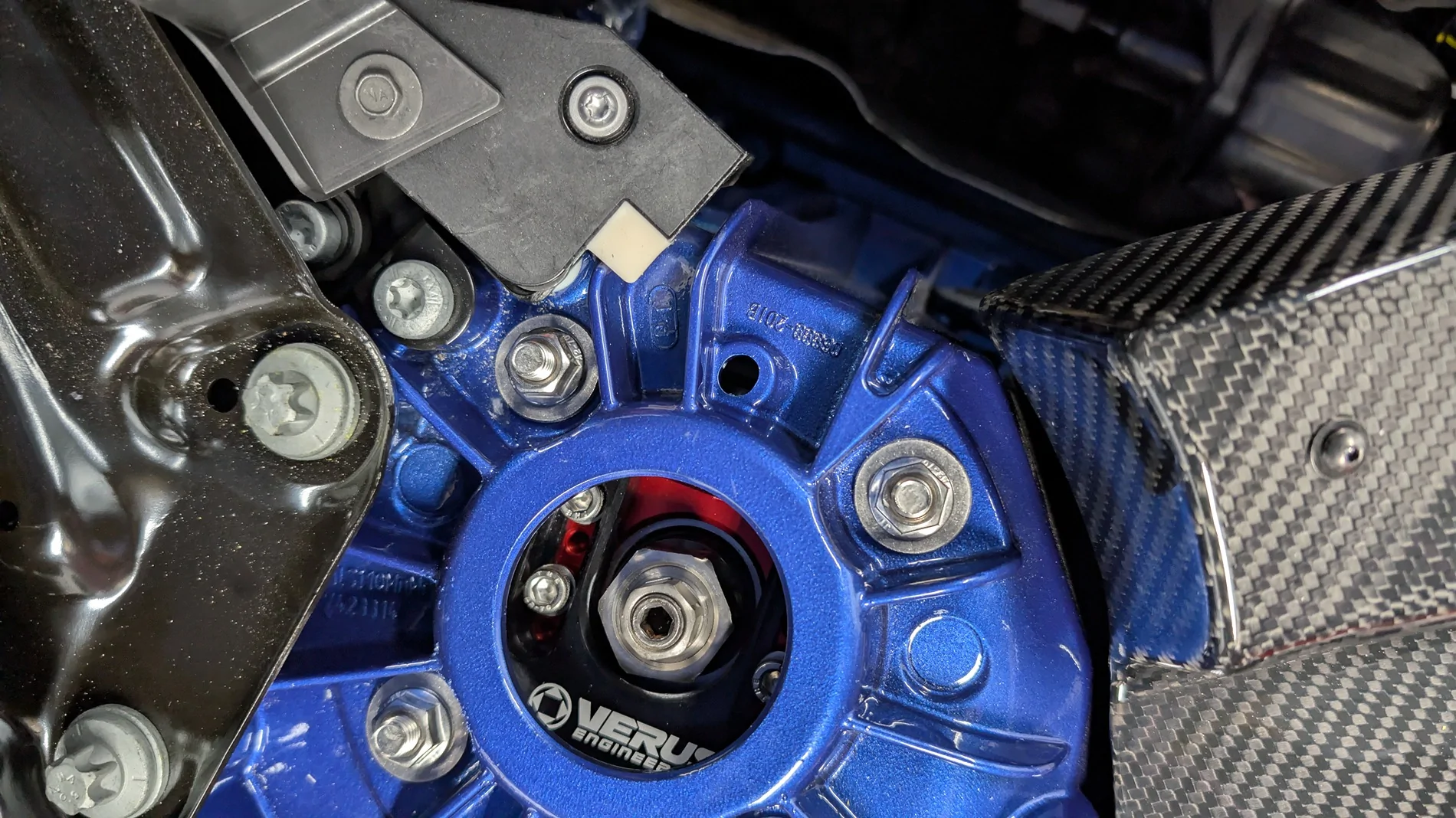

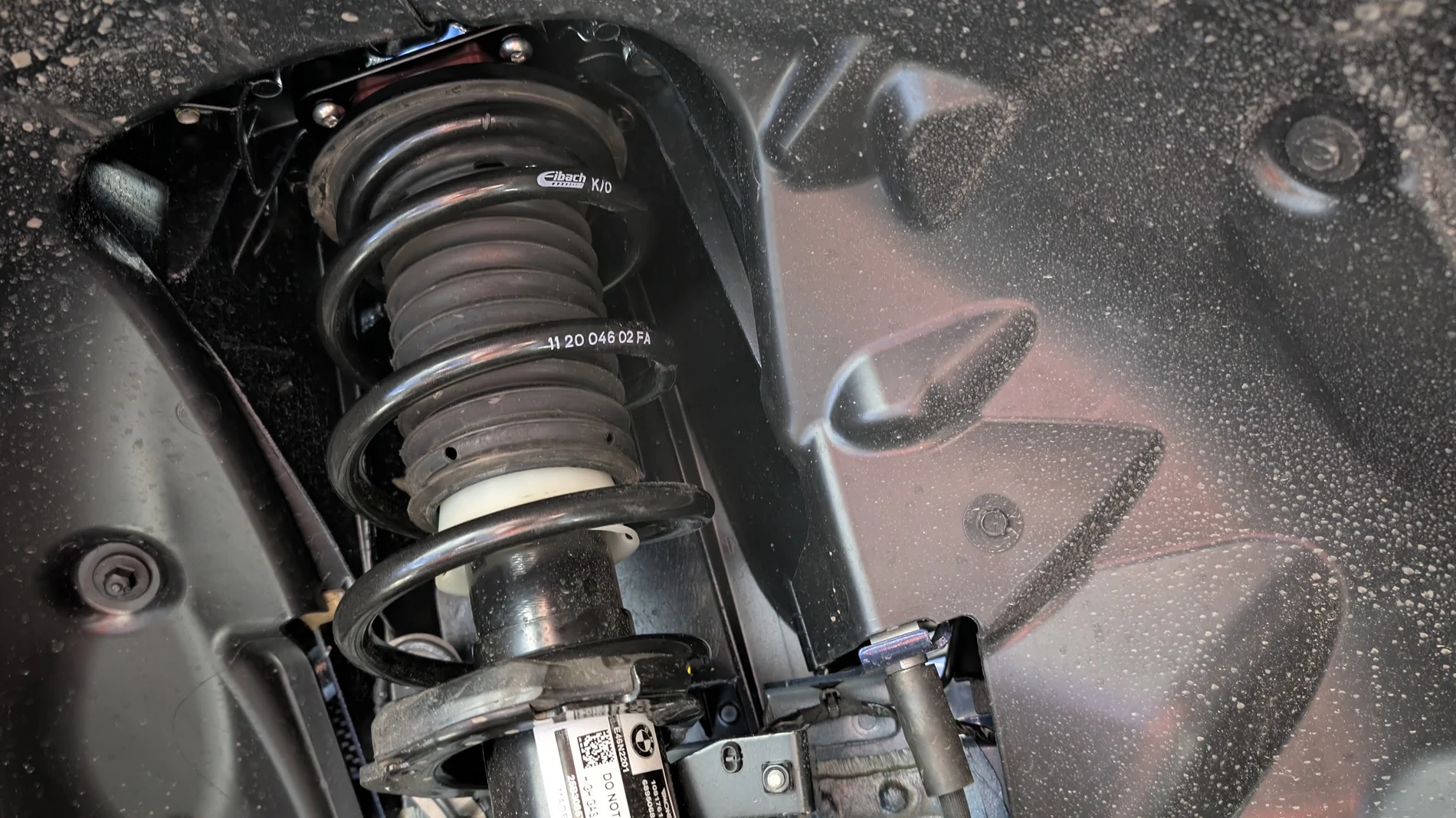

First up were the euro eibach springs and verus camber plates. Springs were easy but the plates were a frustration session until I decided to ignore their instructions and install them my way. I ended up splitting them in half and installed the lower piece of the camber plate onto the strut with the top piece mounted in the strut tower. 2 hours of frustration doing it per the instructions, 15 mins per side doing it my way. Highly recommend doing it that way. I set them about halfway in the plate after I took the pics. I noticed that you can't go much further with them since the oem plastic hat that is full of bearings will touch the strut tower. I'll probably get verkline lower control arms later on to help with more camber.
Plates and springs installed.

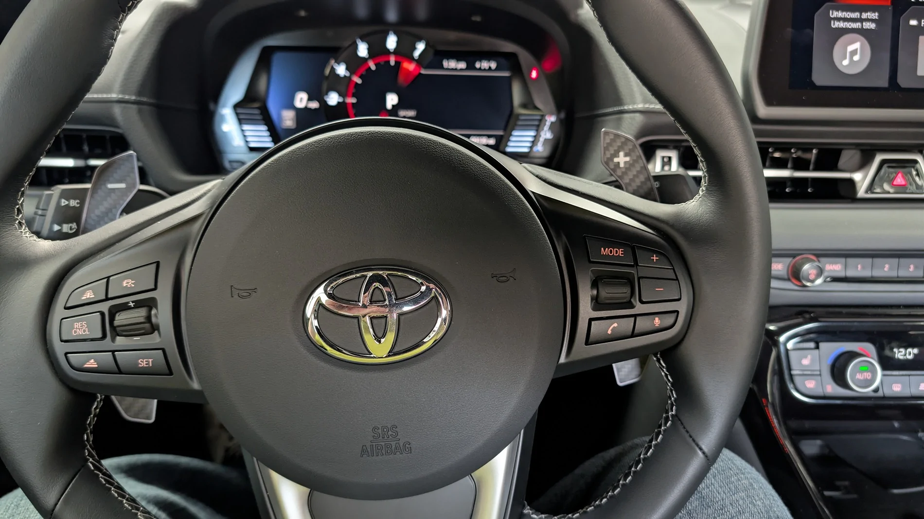

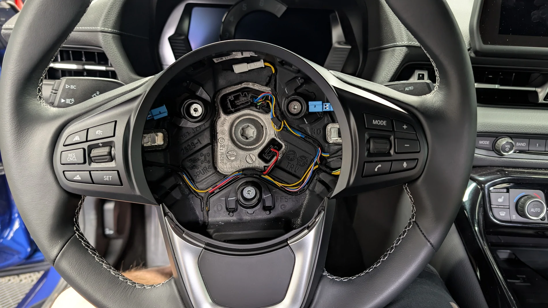

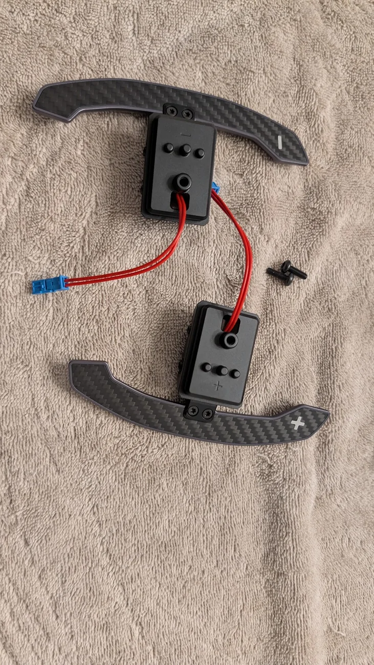

JQWerks magnetic paddle shifters next. Have these in my S4, absolutely love them since I drive in manual mode 99% of the time so I got them for the supra. Install took about an hour total, probably 20-30 mins to get the airbag off. You'll struggle with this if you haven't done it before. Trick is to push forward on the airbag with one hand while pushing the clock spring inside the wheel with the screw driver. Do the left side first, driver side second.
Paddles
Airbag and oem paddles out
New magnetic paddles in

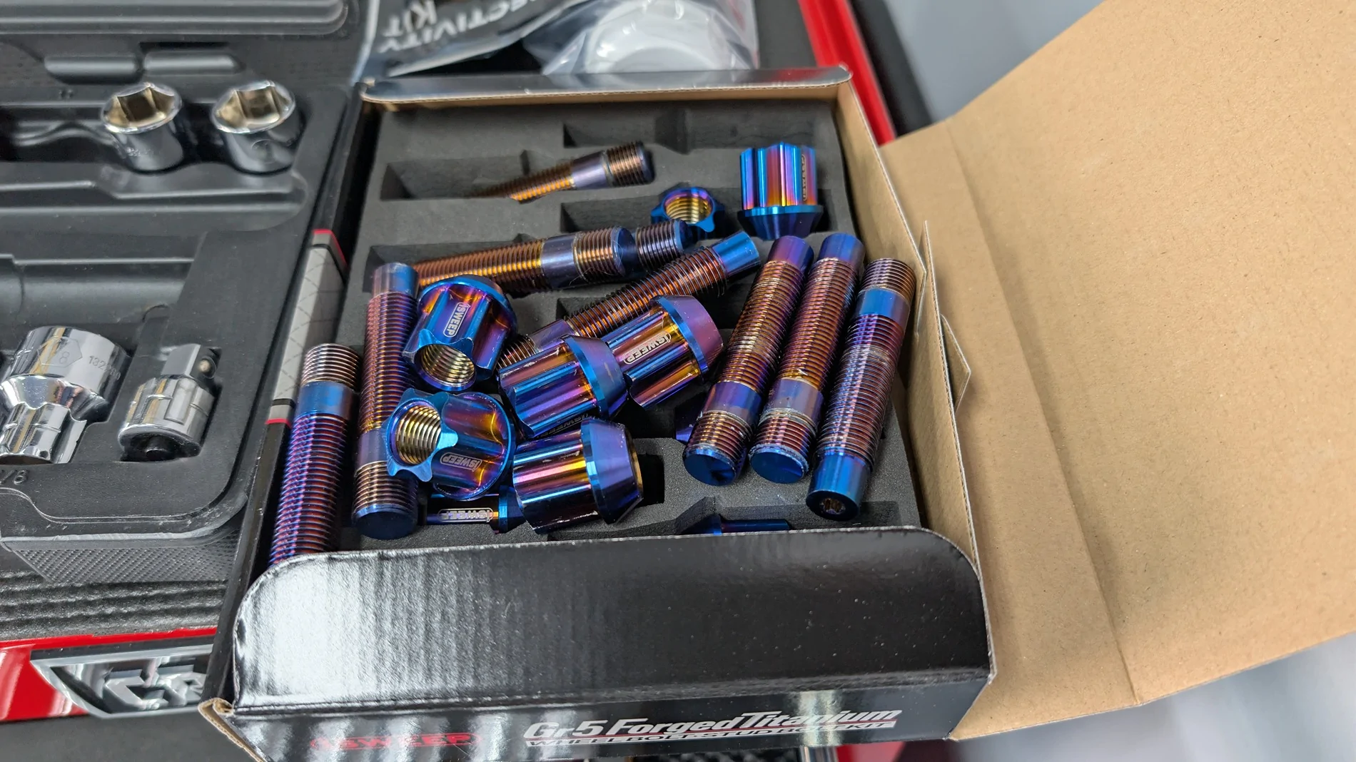

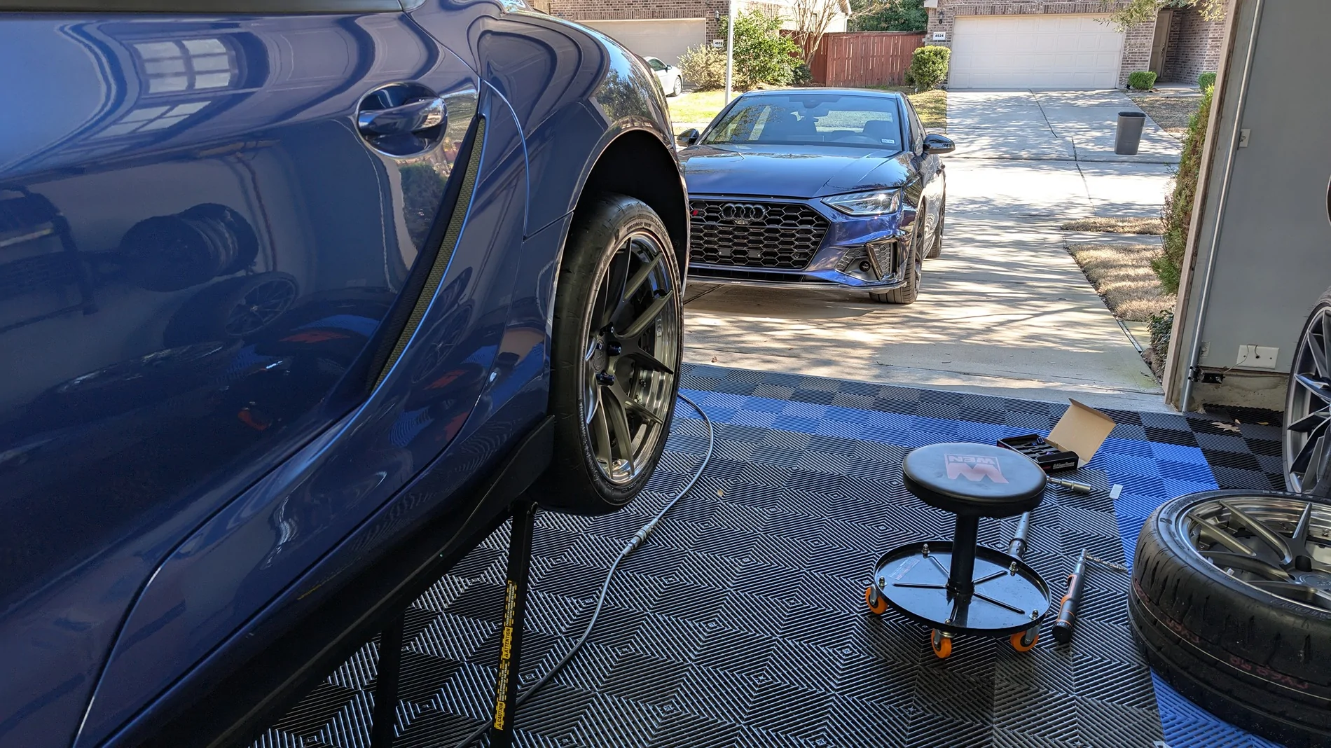

Wheels came in this week, had the tires mounted yesterday, and installed a titanium stud kit. Had issues with the studs being too wide for the wheels and had to pull it off. The clearances between the studs and the wheel bolt holes are extremely tight and these studs do not sit 100% stright once threaded in. They're ever so slightly off so that the wheel won't fit. The wheels will have to go to a machine shop to have the bolt holes widened a touch. I managed to get only one of the 3 wheels on with the stud kit. Will have to run oem lug bolts for now.
Stud kit after I pulled it
On the car

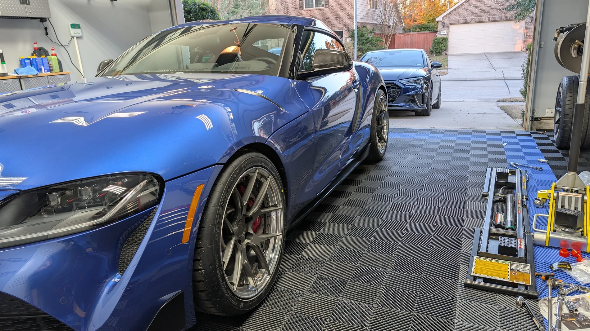

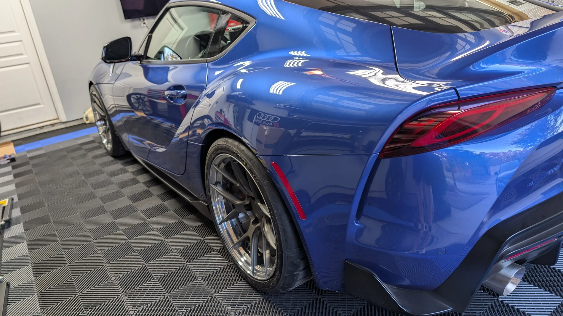

Wheels installed for the first time. Springs need to settle a bit I think. After some driving around I have 2 fingers gap front and rear. I would have liked to go lower but as you can see in the background my driveway sucks, its steep. Stock ride height has the lowest point of my front bumper with 2 inches of clearance at the bottom of the driveway when entering at an angle without me in the car. Didn't want to risk going lower than what the euro eibachs provide. This car will be on coilovers sometime next year so I can fine tune ride height later.
Few other things to mention. The tires are RE71rs 265/35 up front and 305/30 rear. There is probably a bit of rubbing going on in the rear over big bumps, I'll need more camber. The front seems to be ok but I think its touching the springs at full lock. Will have to check clearances later. Glad I didn't go with the 275 up front, its an inch wider tread than the 265 but about the same sidewall width. Pretty sure it would rub with the current suspension settings.
