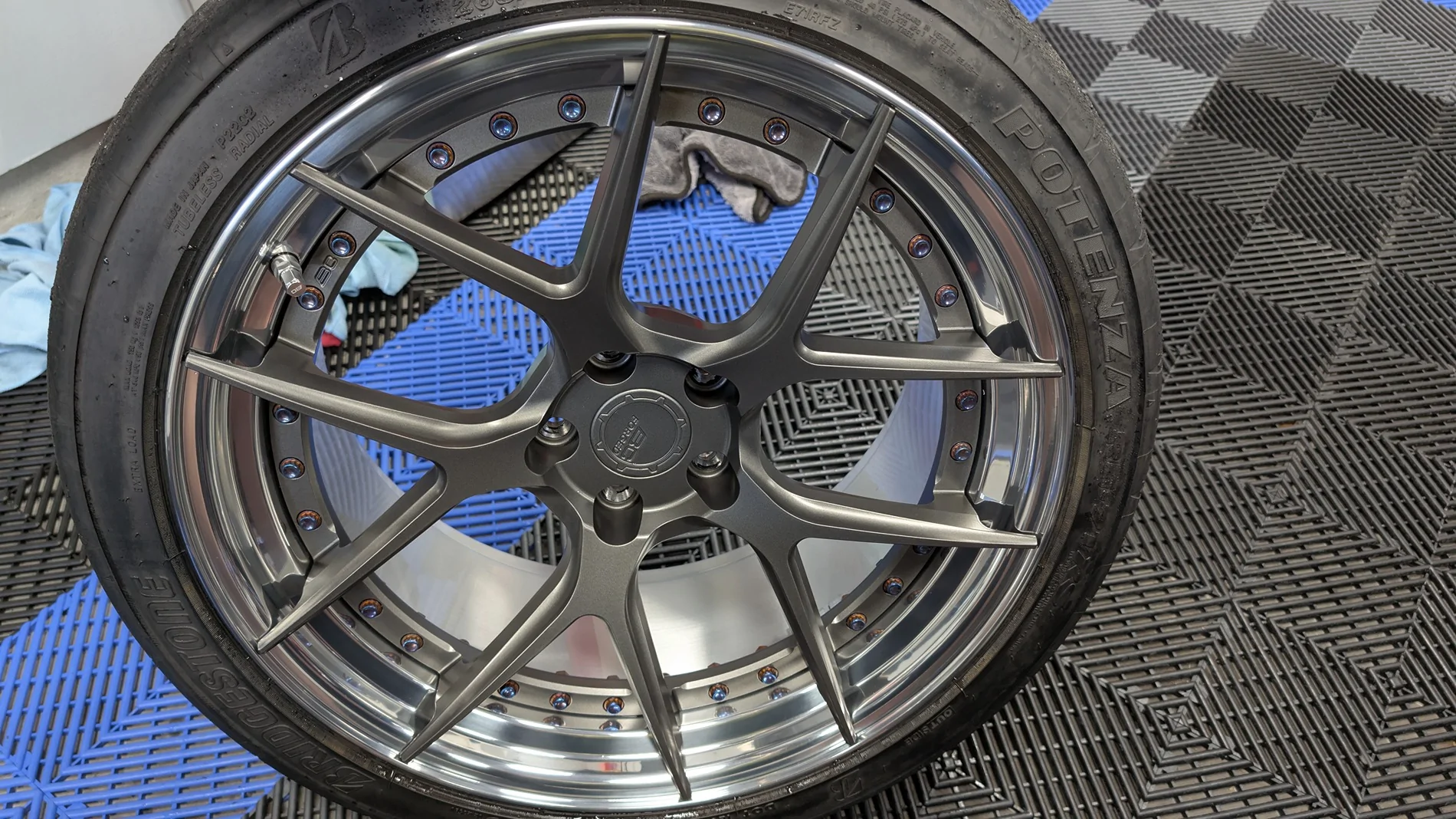

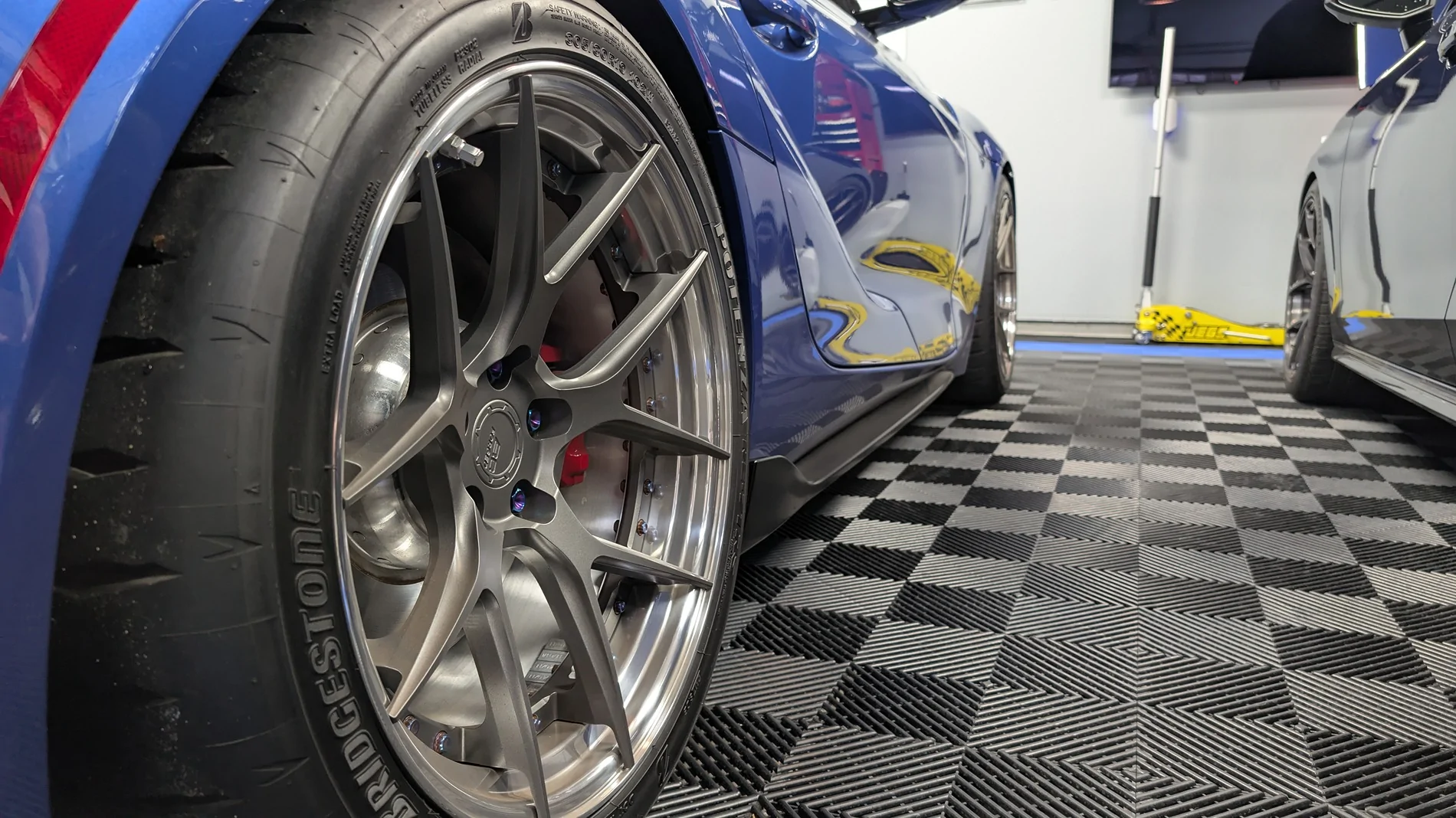

Put the Ti lug bolts on the car earlier in the week. Looks nice with the wheels, happy with this for now. I'll get to the studs eventually. Will not be running these at the track.

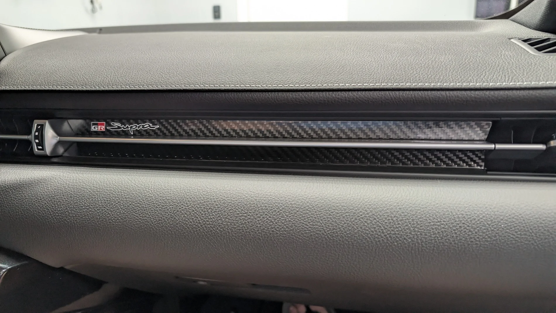

Had this interior carbon fiber sticker thing for the vent laying around for awhile I finally installed. Not really into modding the interior but this bmw interior is pretty bland. Looks nice and oem. Only other mod I'll do with the interior is a different steering wheel at some point, stock one is too skinny for my hands.

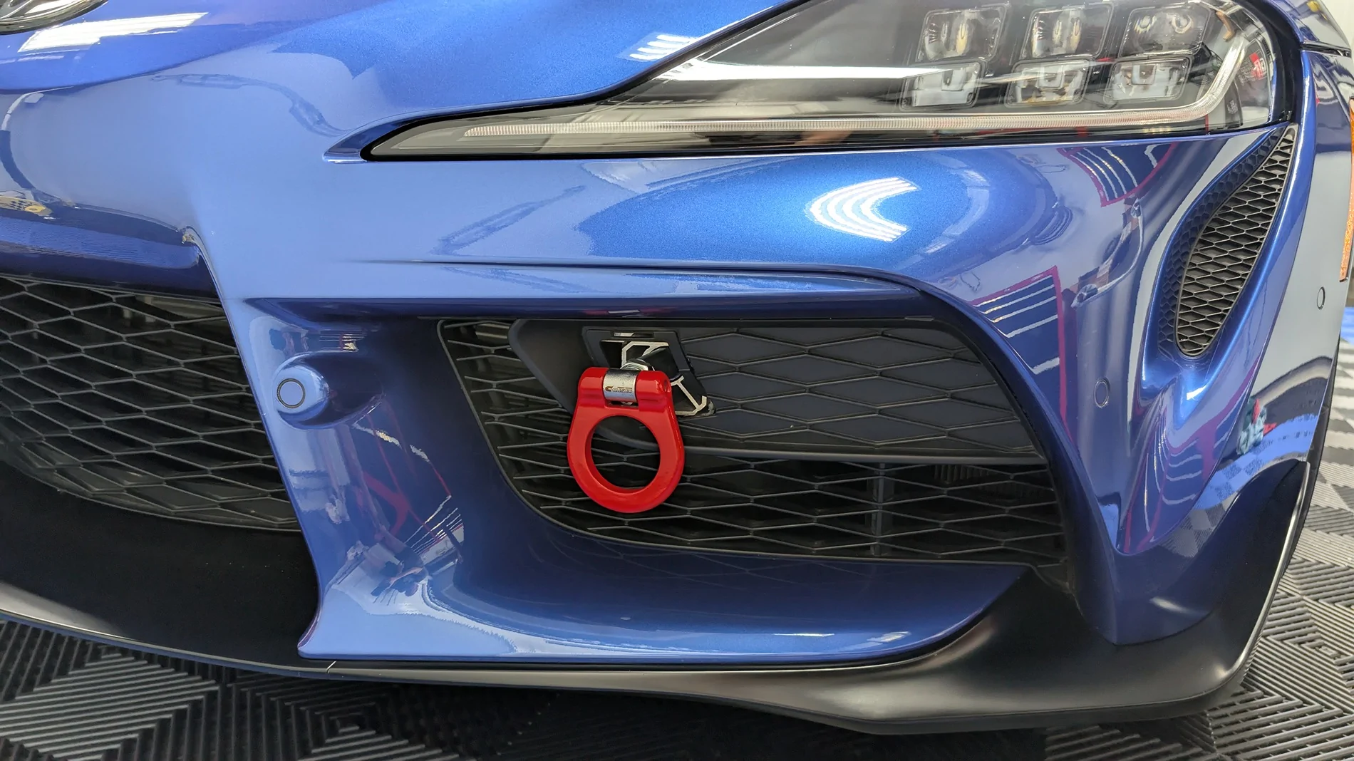

Bought a tow hook because it looks nice. Need to get one for the rear as well for track events.

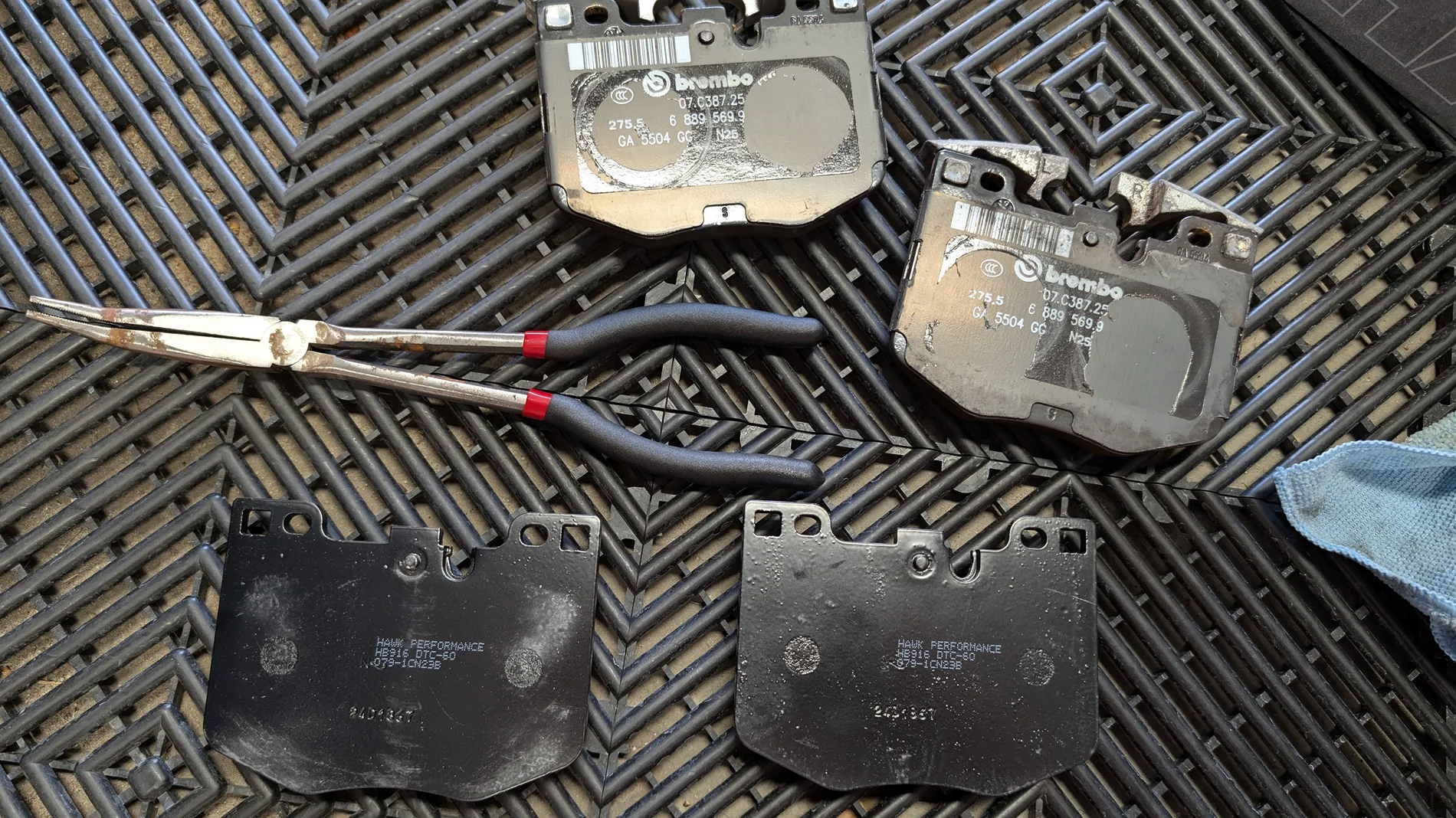

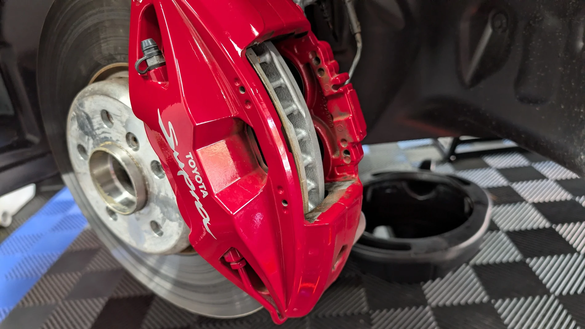

Out with the stock dust pads, new dusters going in. Pretty annoying that they're glued in there. I was able to get them free by using the hooked needle nose pliers under the metal tabs and prying upwards. Didn't take too much force to get them to break free. Really nice having 4 pot brembos again. Pad swaps are so easy when you don't have to pull the caliper. If anyone wants the stock pads let me know, 530 miles with 0 hard braking events.

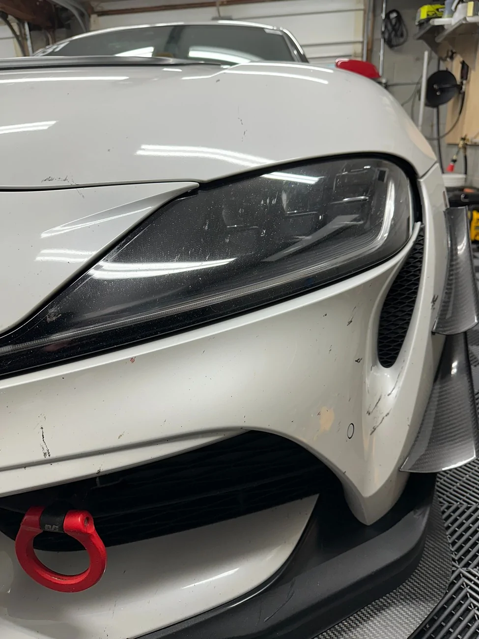

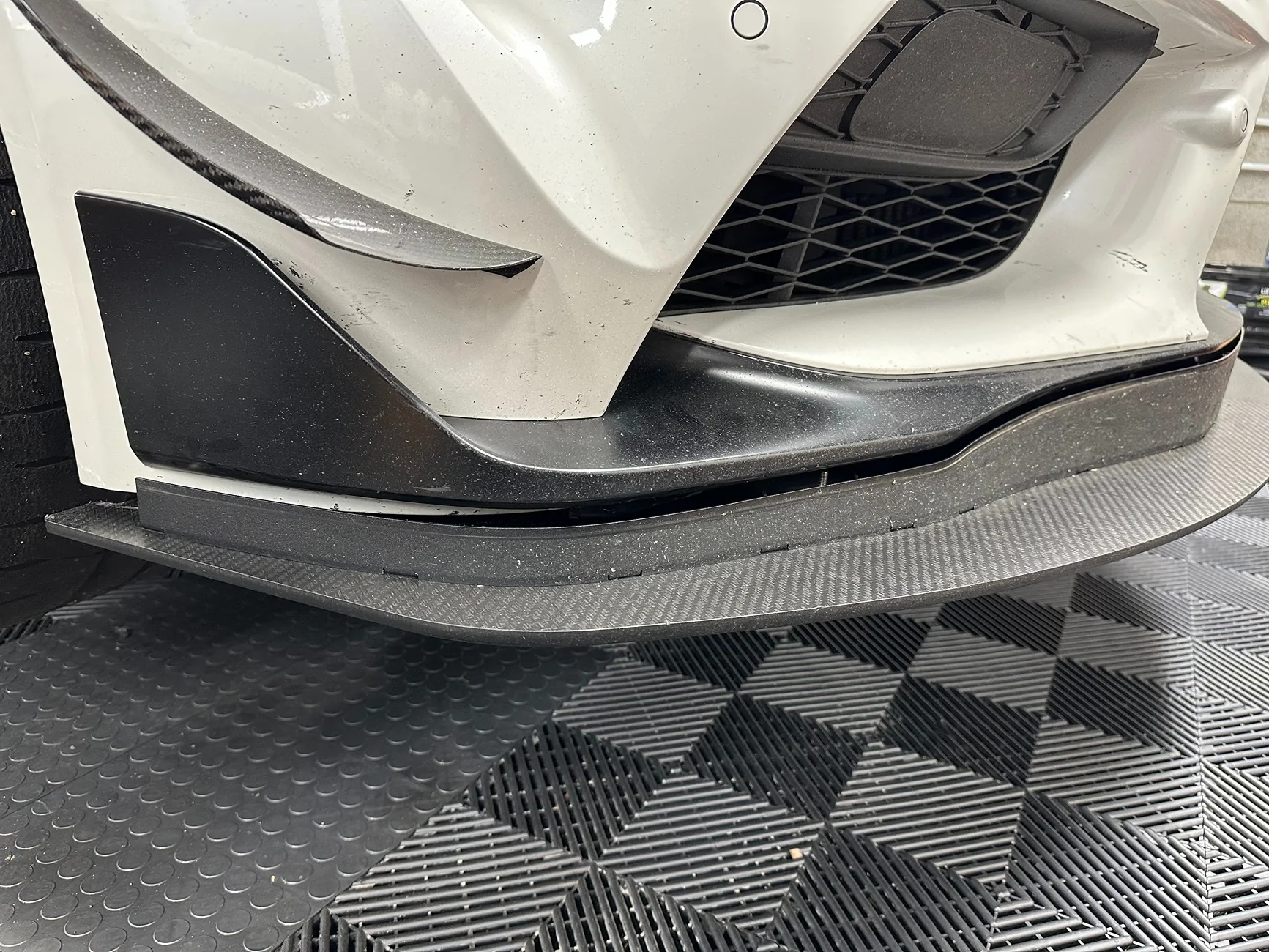

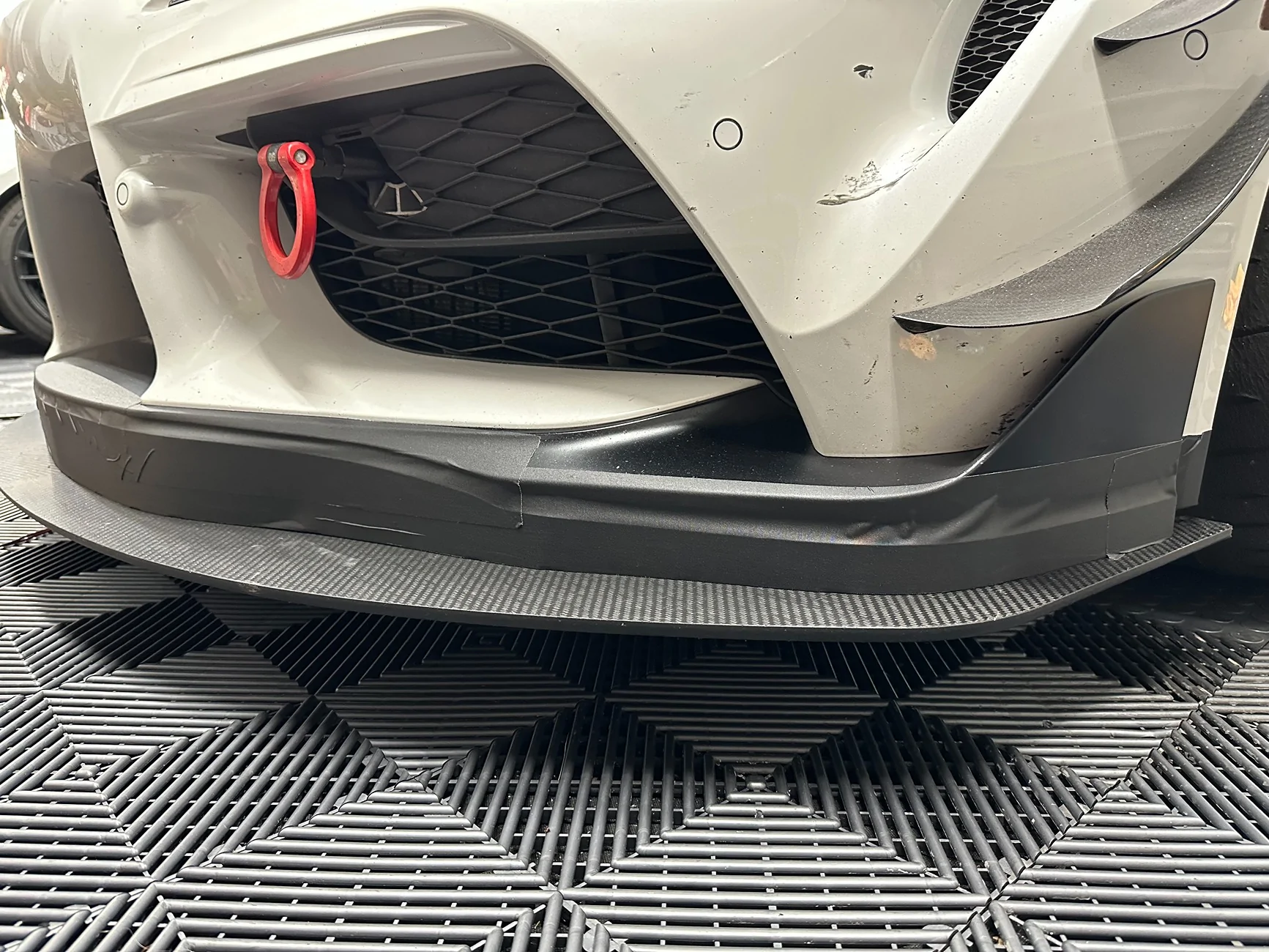

I remember when the front of my Supra looked nice and not annihilated. Now it has many track memories of being 2" off peoples rears at 120mph+. Enjoy it being pristine while it lasts, lol.

I remember when the front of my Supra looked nice and not annihilated. Now it has many track memories of being 2" of peoples rears at 120mph+. Enjoy it being pristine while it lasts, lol.
Yeah, it is what it is. Hopefully the ppf holds up for awhile. Right now its a shiny new thing and I like keeping my cars clean and in great condition as much as possible.

Yea... I'm way too far gone for that lol. To be honest, I bought the car to track with so I view it all as badges of honor now. ;)

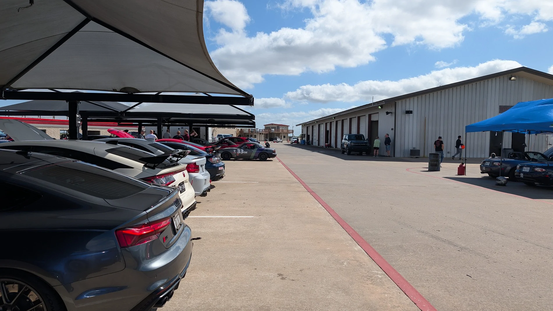

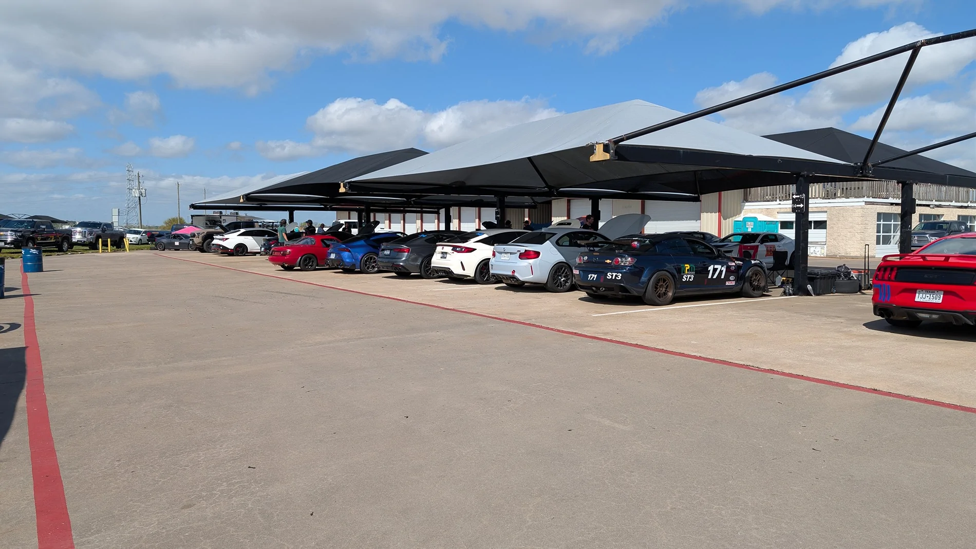

Pit area

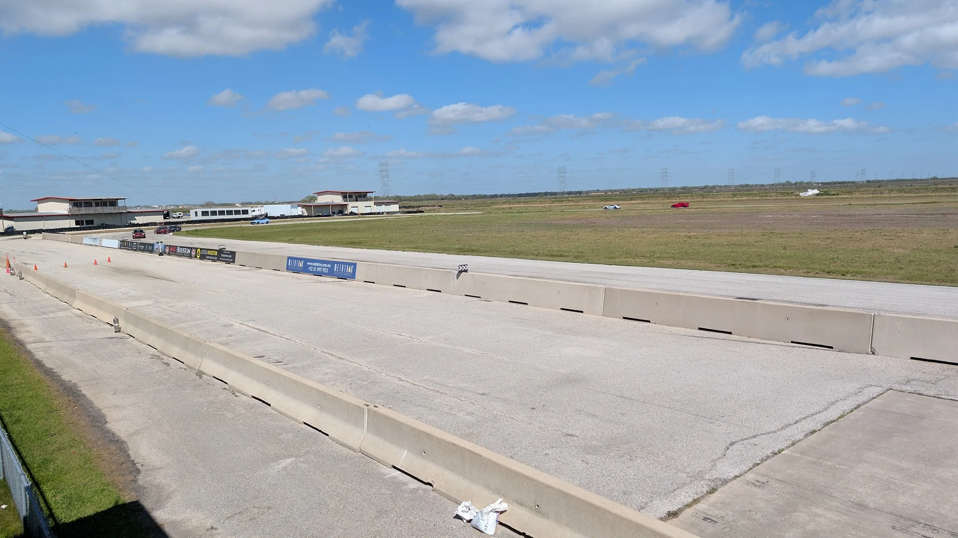

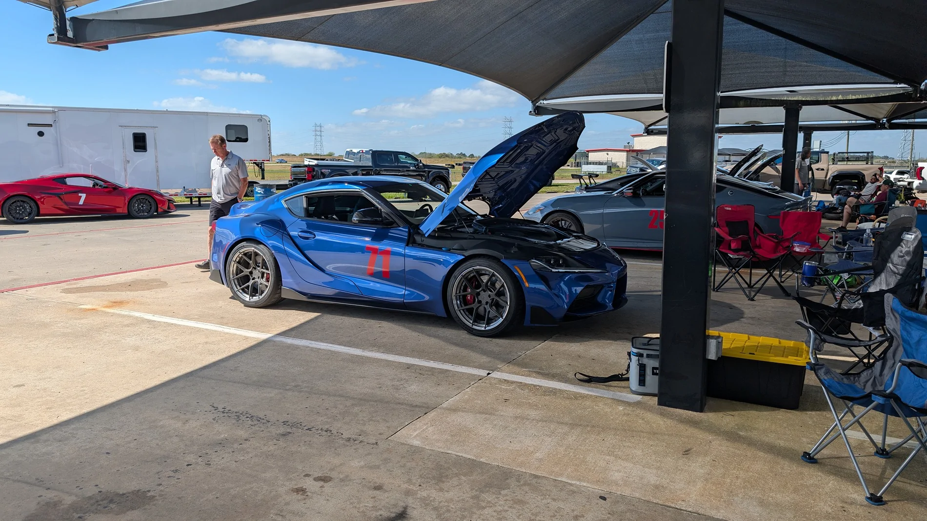

Track. Final turn into the pit straight.

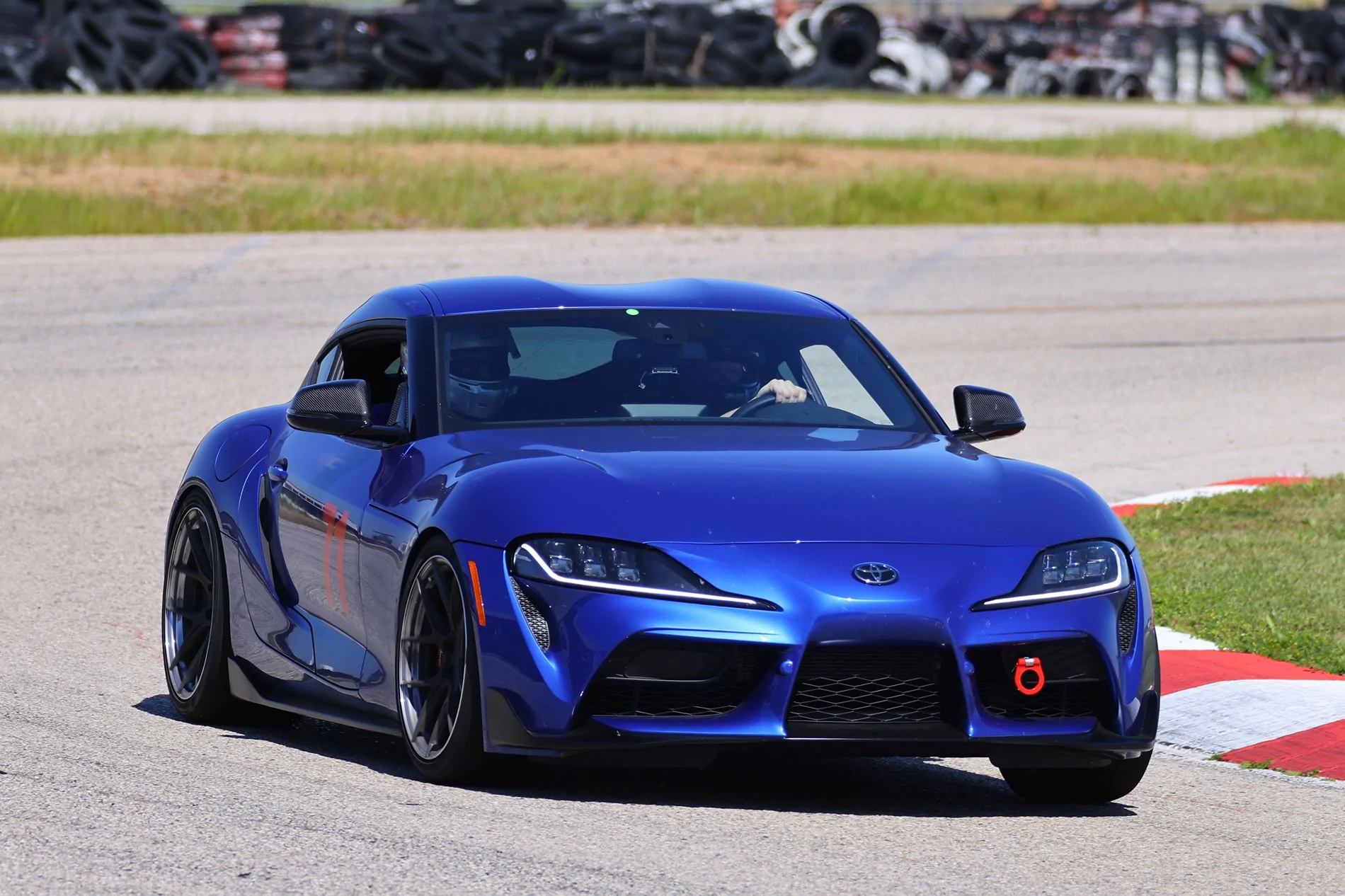

Only pic I have from the professional photos that were shot over the weekend. Will post a few more when they get delivered.

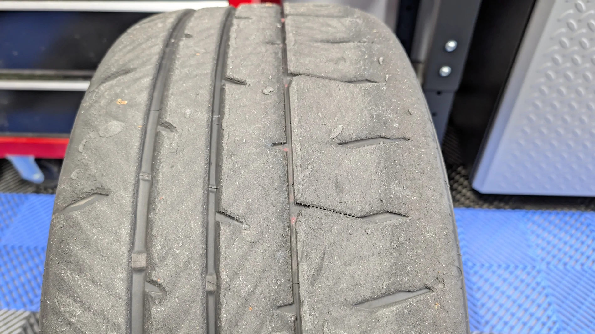

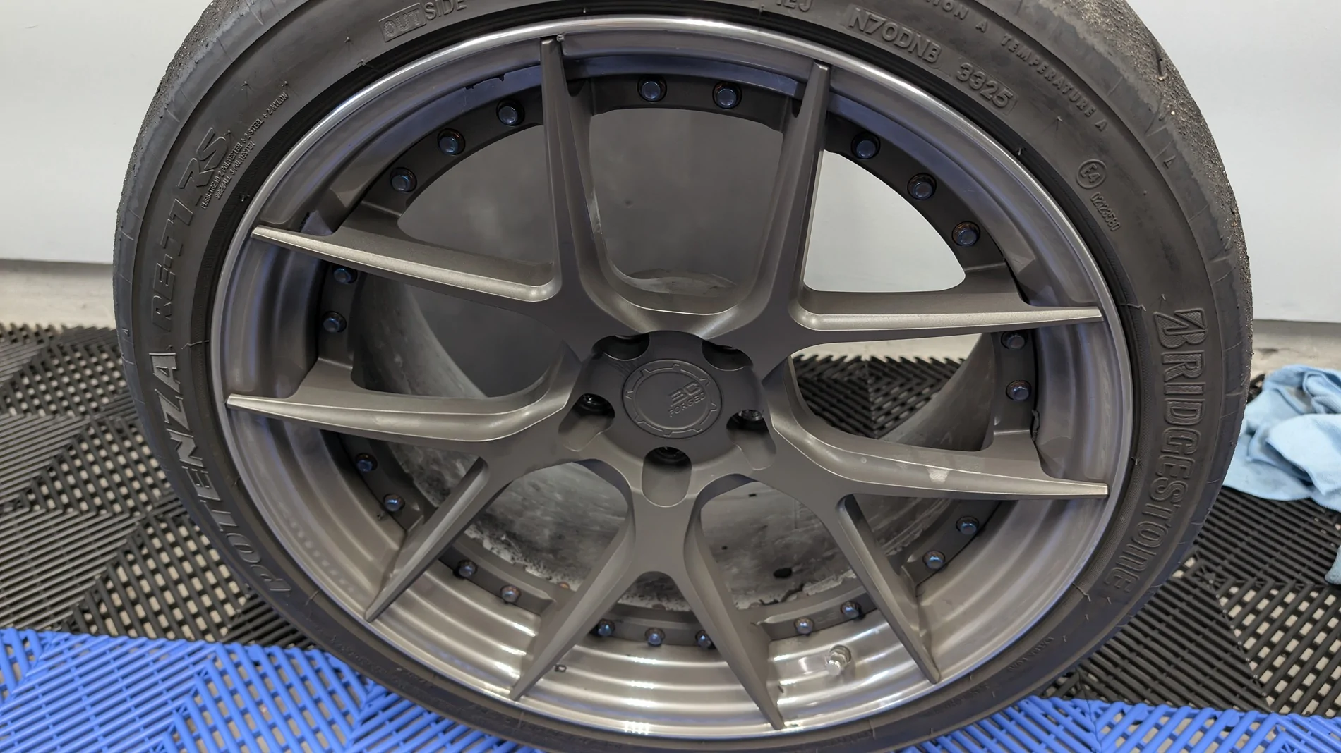

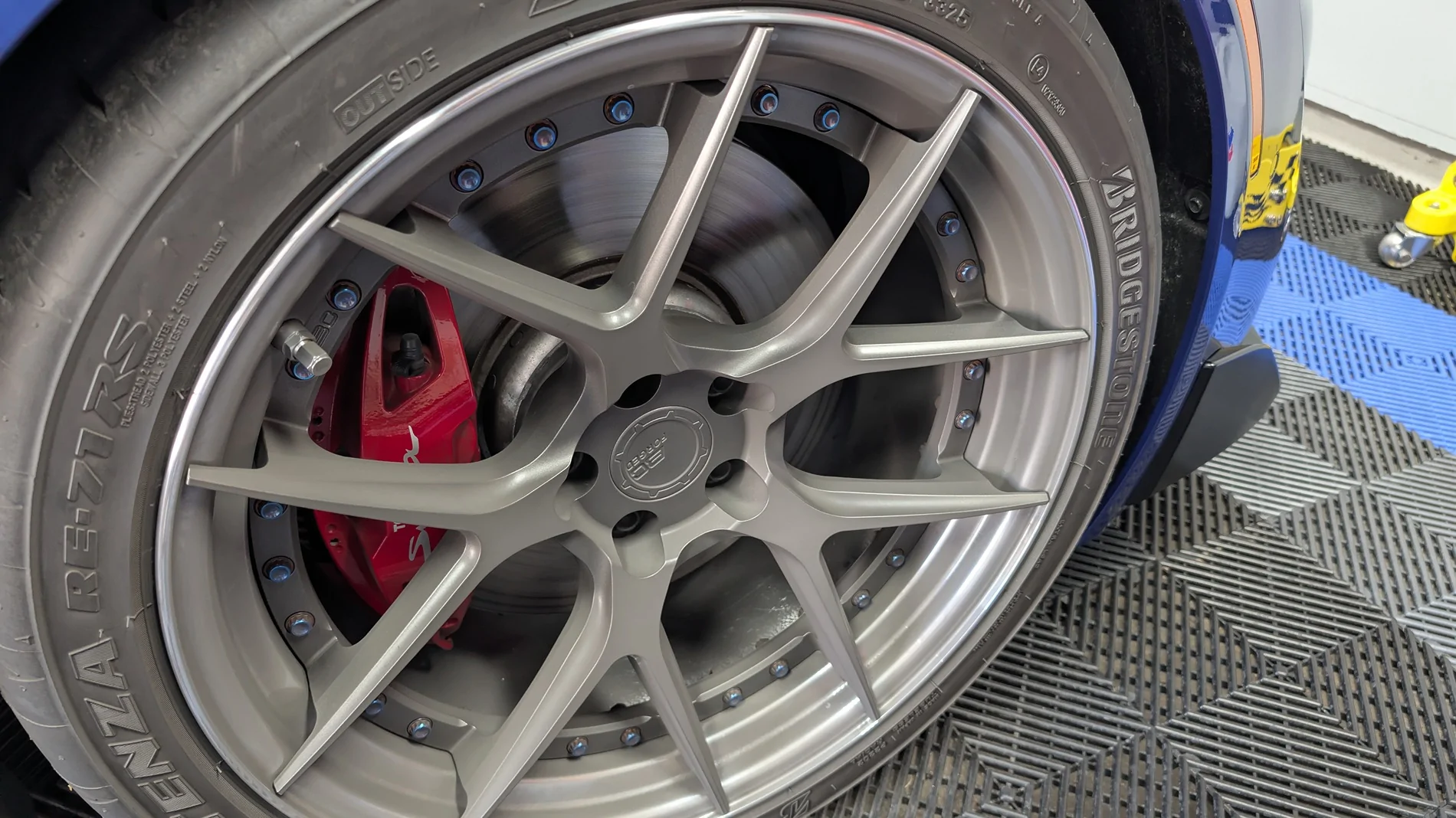

Tires after one weekend. I believe this is the passenger side front which took the most abuse.

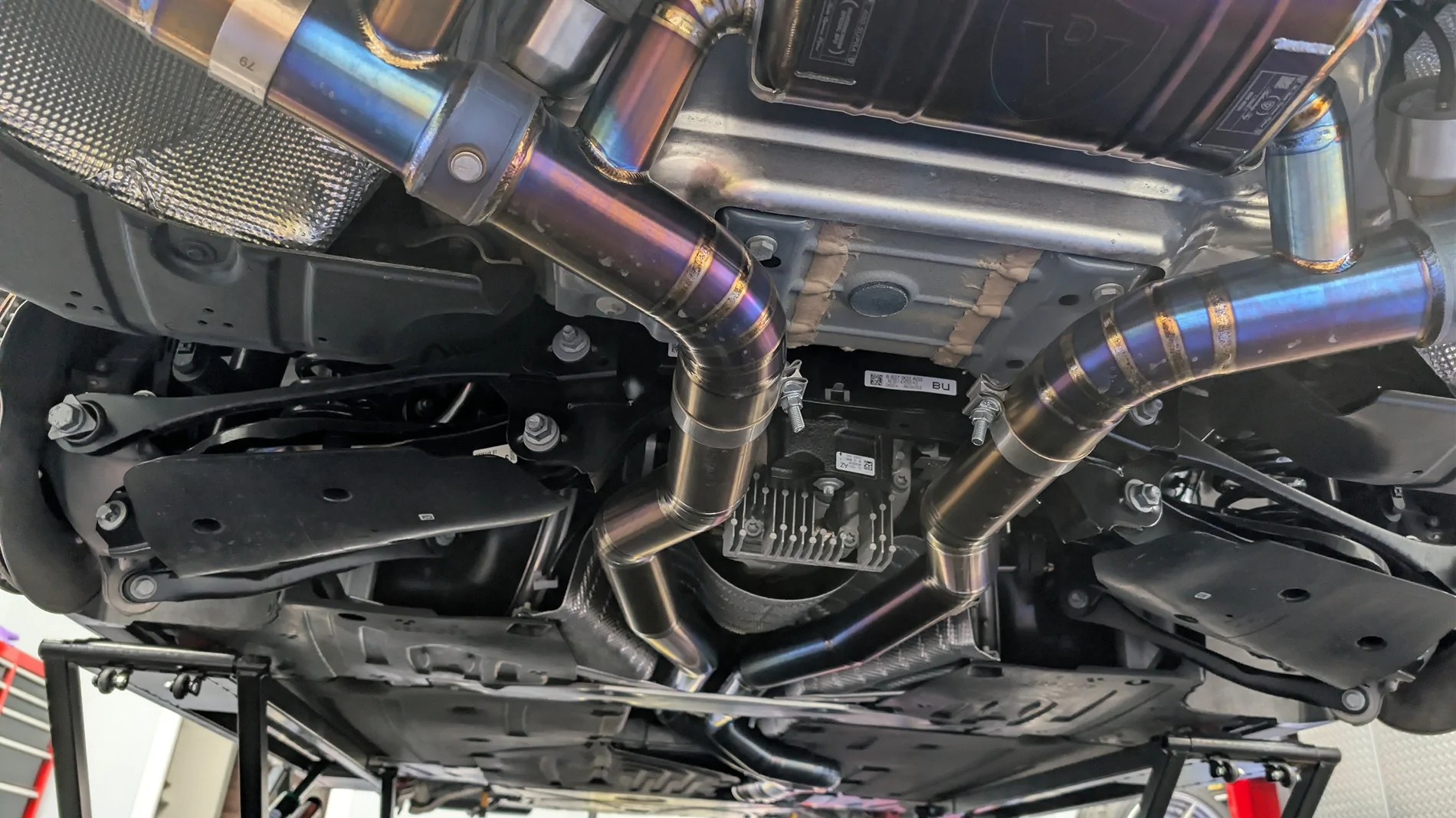

Exhaust re-colored itself from the heat. Neat.
Also, did you guys hear track day brake dust doesn't come off your wheels??? Me neither. 🤣🤣🤣

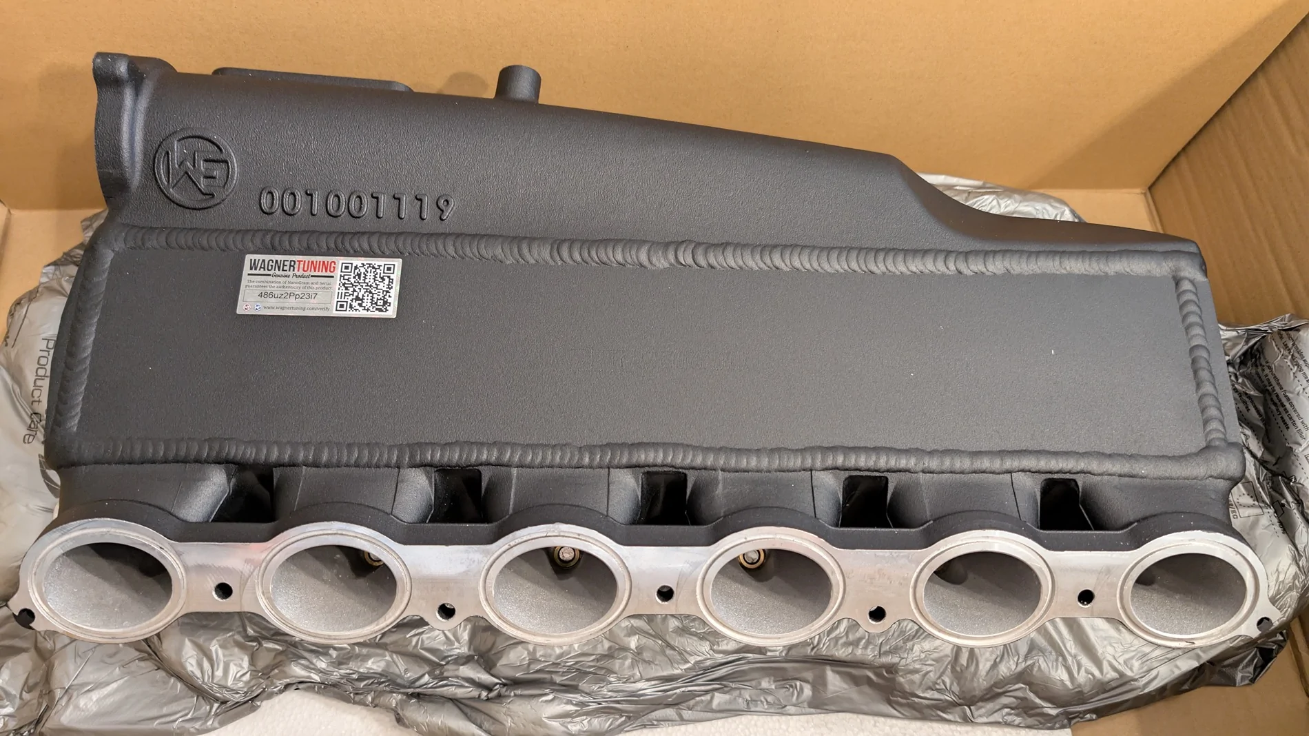

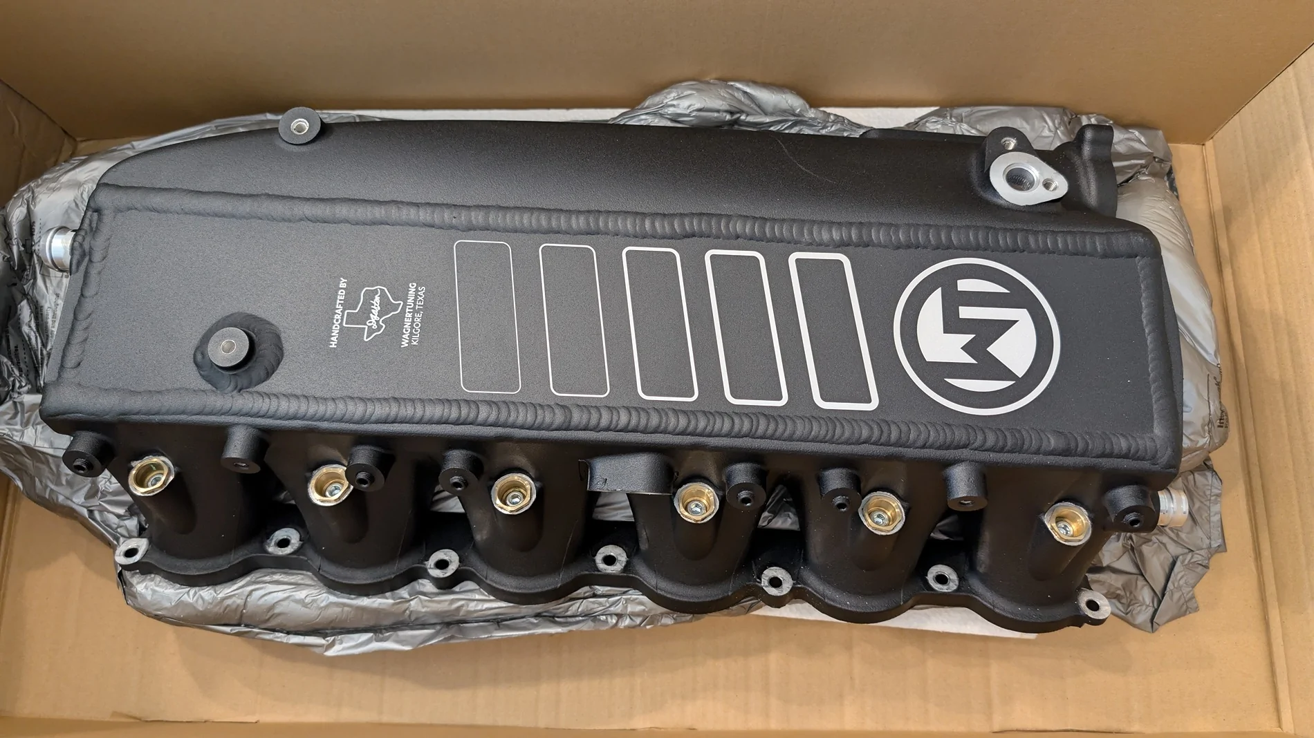

Wagner IM going in this weekend. About to get started with the install. Gaskets on the runners are annoying to get seated. Might be the worst part of this install.

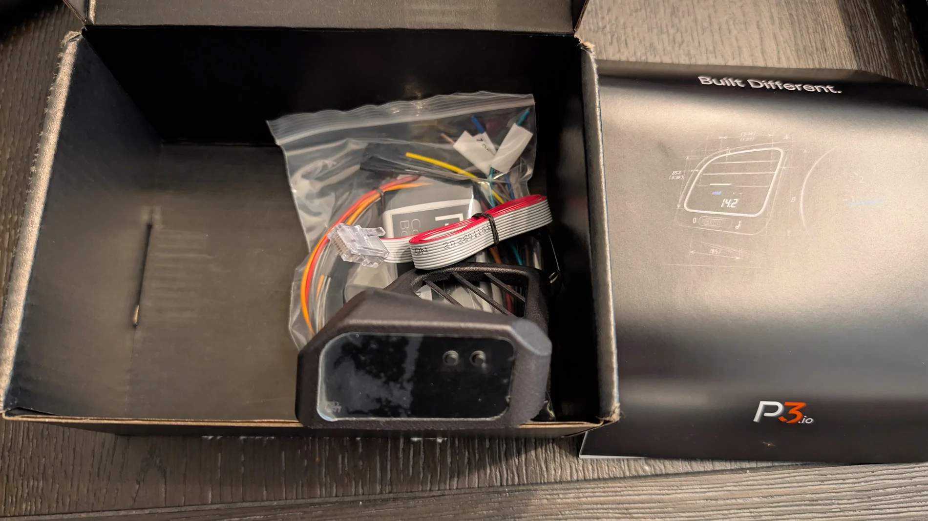

P3 vent gauge. Not sure if I'll get around to installing it this weekend or not.

Parts starting to pile up again. More on the way.
Yea that part sucks. I ended up using small little dabs of super glue to keep the gaskets seated and it's been fine for years now. :)
Just seated the gaskets, wasn't too bad, took about 10 minutes. Thin coating of silicone grease on the gaskets helps quite a bit. Now the question is will they stay in place when I go to seat the manifold onto the head. I can foresee quite a bit of cussing and the super glue coming out if they don't.

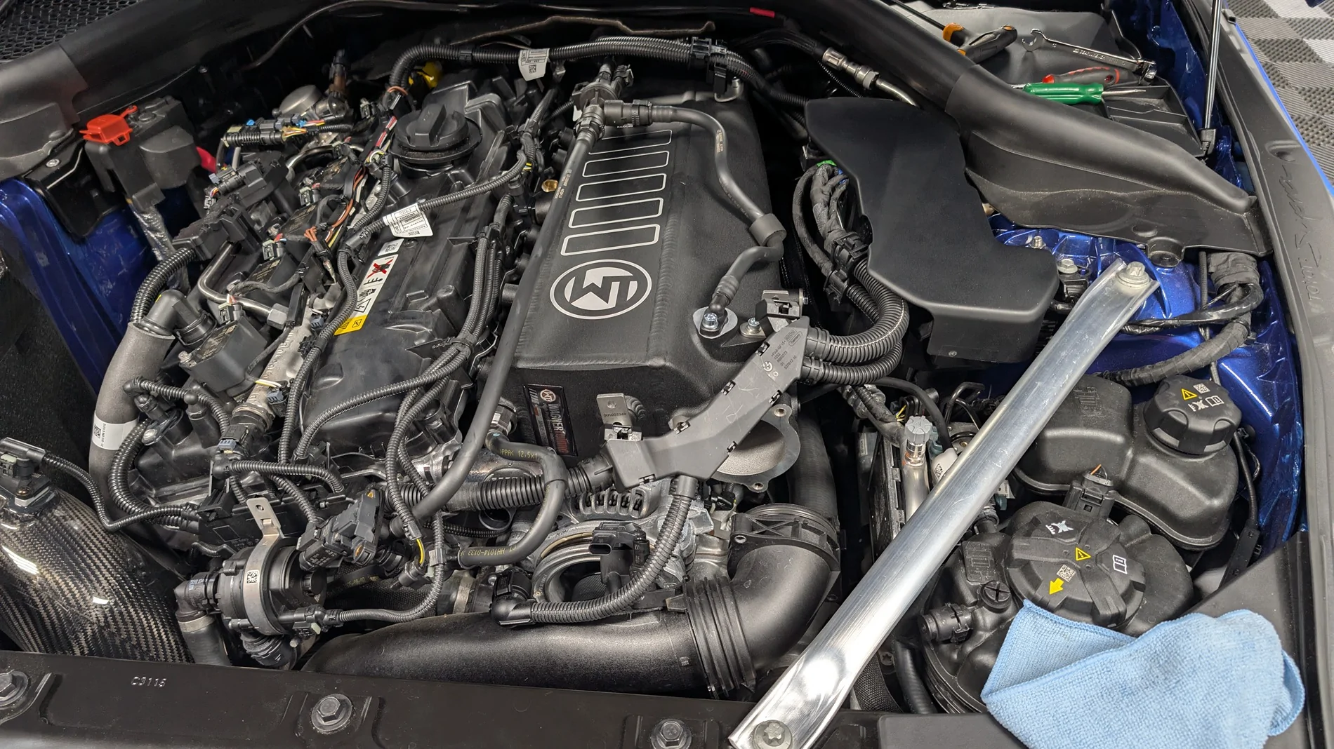

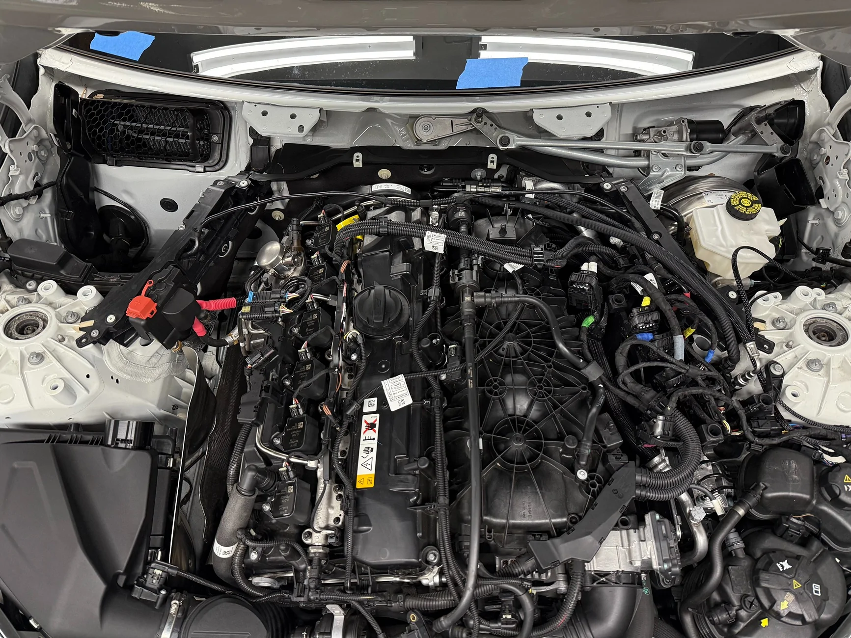

Manifold is in, hardest part were the water connections on the back near the firewall. Still need to do the throttle body and boost pipe and vac fill, will deal with that tomorrow morning. This is probably a 5-6 hour install and I was taking my time, not too bad. One thing I'll need to deal with is the plastic hose running across the front, its sitting on the front edge of the manifold which will rub and probably break eventually. I've also realized I don't have the ability to log since the car isn't tuned which is annoying.
You can log the car without a tune. Just pay for the MHD logging license.
Also, for others, taking out the cowl bits behind the manifold creates a TON more room to work those back coolant connections.
This is my M240i, but same same on the Supra

Finished up the install a little bit ago. Bleed procedure took a lot longer than I thought. I vac filled the system but that did not come close to getting the air out. I also ran the reservoir dry doing the bleed procedure the first time by not paying attention so that probably let a lot more air in.
Anyways, drove the car. All is good. No CELs, no weird behavior, no leaks, manifold is cool to the touch after driving. Feels like same temp as ambient.
