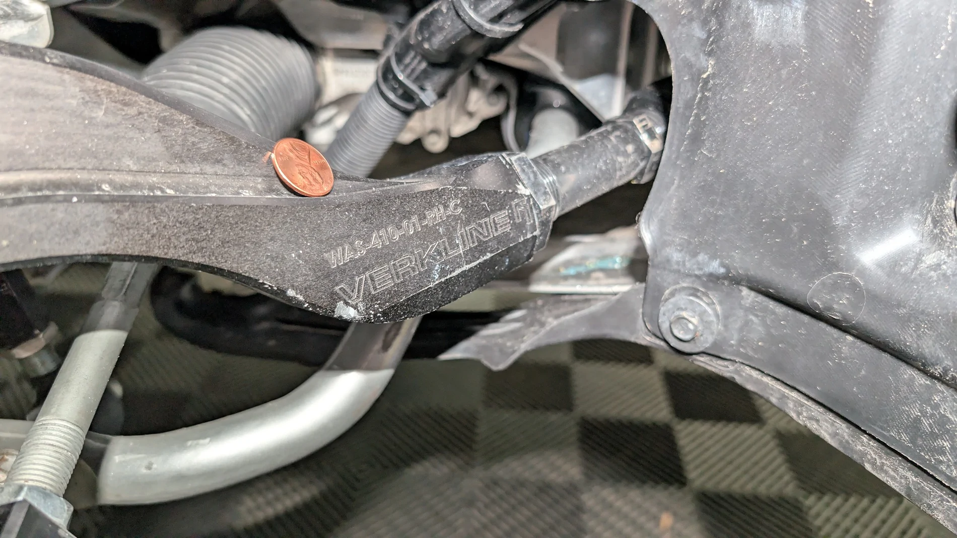

Small update, looks like Steve screwed up the oil cooler install too. The lines will have to be redone, they're rubbing coolant hoses, ac lines, electrical harnesses and they're twisted causing the connections at the block and cooler to come loose and leak. New shop is putting sleeves over the lines as a temp solution to get the car back to me quicker for upcoming track weekends. It'll have to go back and be permanently fixed later.
Fortunately no subframe damage and the suspension arms and bearings appear to be ok outside of the caster arm damage. There are multiple dust boots that need replacement in the rear, looks like they couldn't get them on and cut them open.

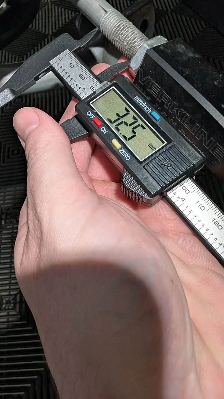

Suspension arms in the rear had to be reset to their factory lengths and will be locked in with another alignment. While the rear was technically aligned, they had some of the arms adjusted near the end of the adjustment threads so they never bothered to set the lengths to factory prior to install.
The ride height has to be set higher in the rear to fix the reverse rake. No corner balancing this time around.
The mismatch in tie rod lengths was caused by a the camber plate adjustment side to side not being even. This also caused a difference in the FLCA lengths I didn't catch. This means the off center steering was caused by a sloppy alignment.
I also made some updates to the wall of shame post on page 1 based on what has been found.
Oil cooler lines
