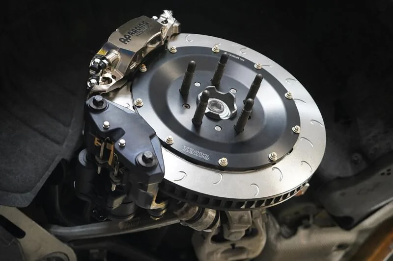

Also got a status update from Essex on the AP Racing rear brakes with the EPB. It's almost ready to go. I think they said it would be ready this month or next.
For those that don't know, this will have the EPB separate from the caliper:

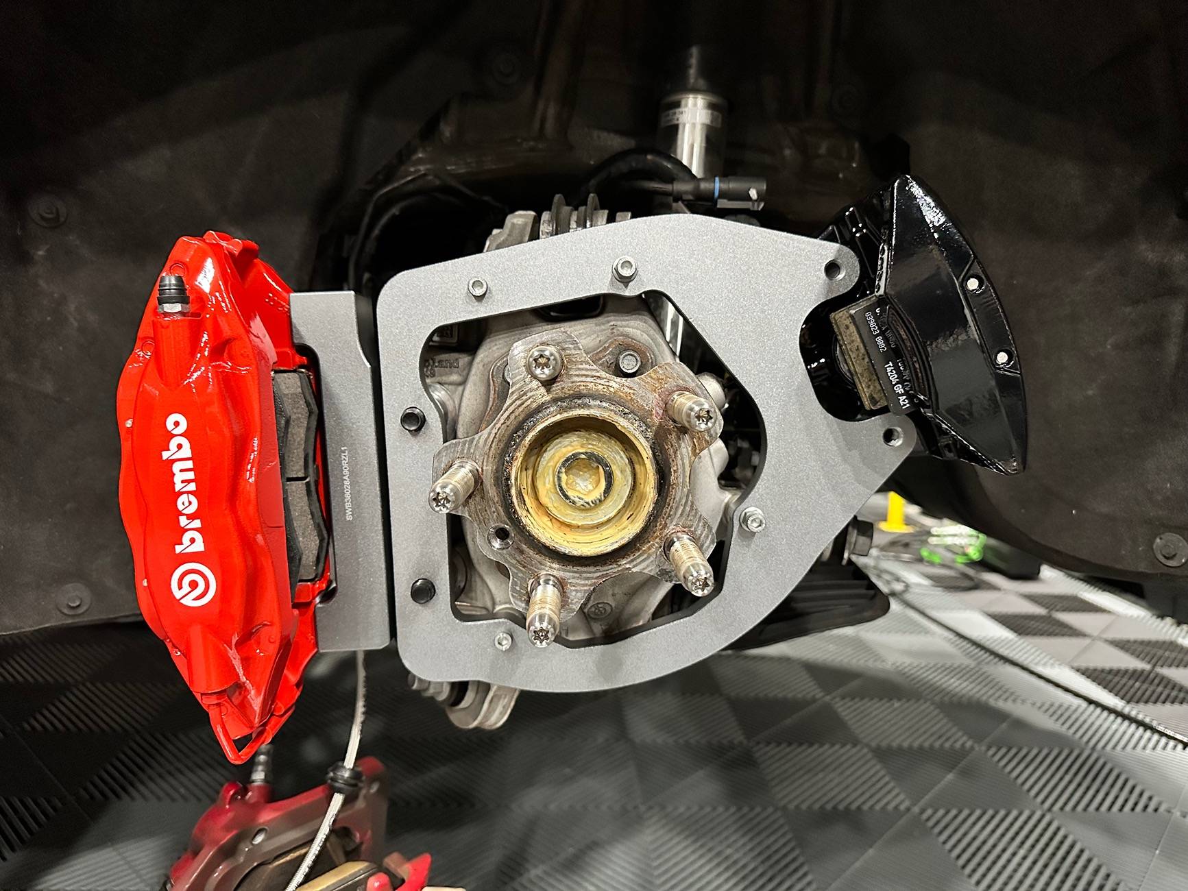

Hell yeah, you will love it.
Im also interested in the AP setup with the parking brake under the regular one. I think thats a better setup than what Signature Werks did and Im trying to find a local machine shop to make me a bracket for my SW setup so I can run them like this.

They are a killer deal, thats the primary win.
Positives:
- Price
- Fronts are simple and fit great
- Decent pad availability, once you find the right type
- Full sized rear caliper with an EPB
Negatives
- Rear fitment can be a pain. The bracket I got put the main caliper in front, and the EPB caliper 180 degrees opposite at the back. The issue I have is that the EPB motor and the KW DSS shock plug make contact under full compresion. SW has a new bracket that flips them supposedly.
- No instructions
- Terrible communication, meaning very little help from them if you run into issues. Ive emailed them 3 times to get the updated rear bracket and heard nothing.
I also had an issue during install where I somehow got air into the ABS cylinder, which required ISTA to cycle during bleeding. That was a pain and caused some pedal softness until I fixed it. The included pads suck balls, dont bother with them.
Overall Im happy with them, they look amazing, and perform great the few times Ive tracked them. Heres a pic of the rear (drivers side) so you can see the bracket system.
