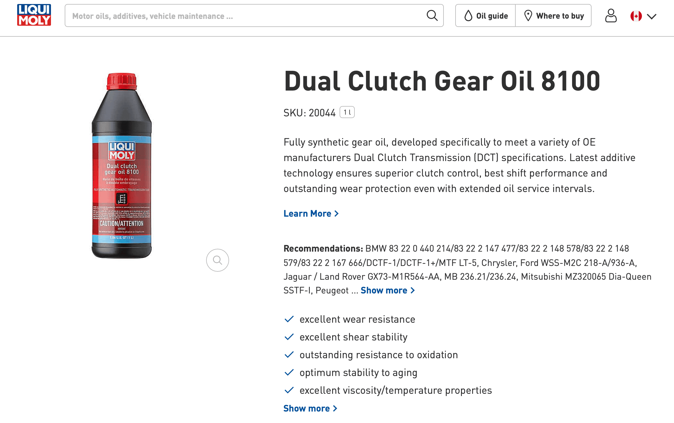

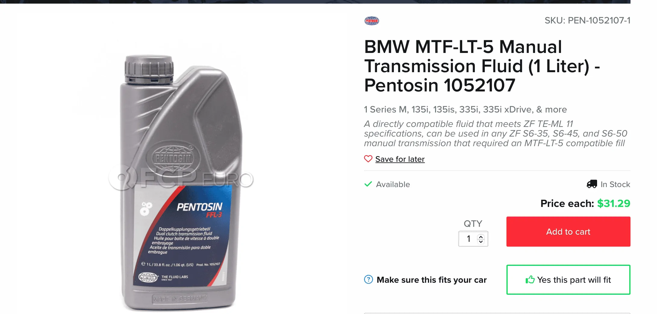

Thank you! I figured it would be 30k miles but I'll probably do mine sooner than that. I found some fluids that match the BMW MTF LT 5 spec. It's interesting that the Liquimoly DCT Oil meets this spec. I hope this helps MT owners in the future.
No surprise at all actually, because DCTs are nothing more than automated basic manual gearboxes with dual input shafts and twin dry clutches. A manual gearbox is a manual gearbox is a manual gearbox ?
