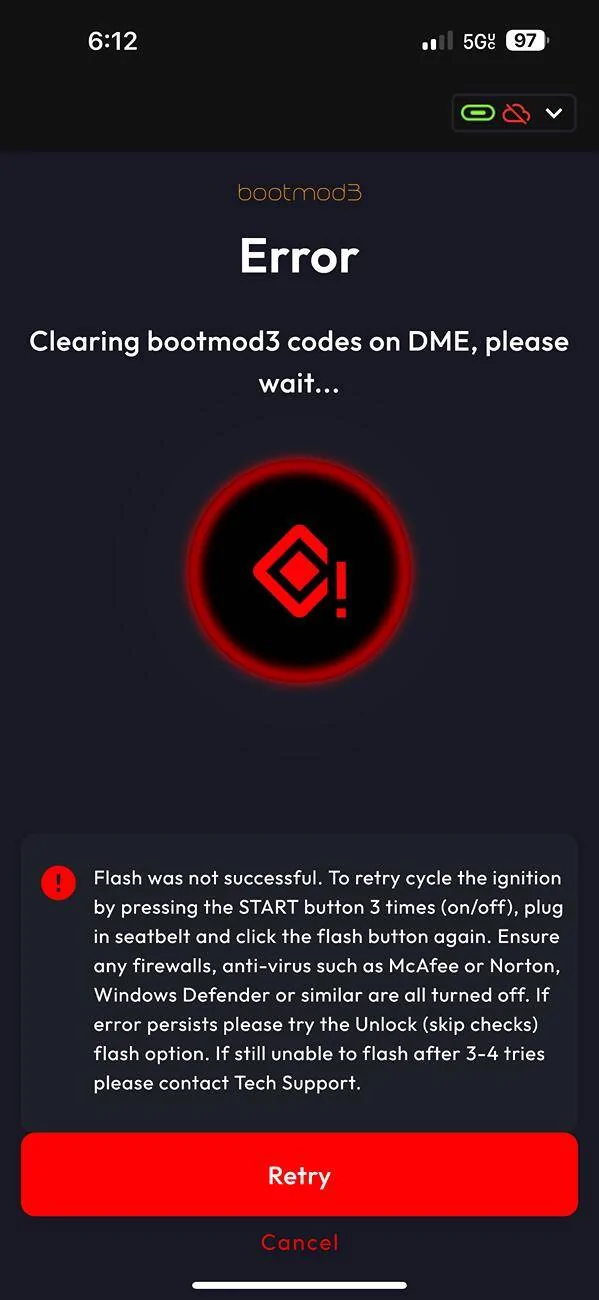

every time I try to flash any map it just says error flashing where it’s clearing bm3 codes on the ecu and stays at 0%. Tried with A90 shop and they were getting the same thing, even did a bench unlock and still the same error. Hoping someone can help out

My car starts up fine and drives just the same, not sure why it won’t let me flash

Did you try it with a hard connection and/or a laptop?
le.soupra
le.soupra
Jun 28, 2025
Launch Edition Supra
I tried both wired and wireless and still the same error, but I haven’t tried with a laptop yet, I’m still fairly new to bm3
8,845
17,339
Def try with a laptop, the mobile app is super frustrating.
SooopraSD
Ray
May 8, 2021
451
802
San Diego
BM3 app updated?
le.soupra
le.soupra
Jun 28, 2025
The app is updated, laptop side isn’t working
I didn’t personally reach out to protuningfreaks, but A90 shop did and they’re waiting for a response, was hoping I could get something here as well
8,845
17,339
Good luck with their tech support.

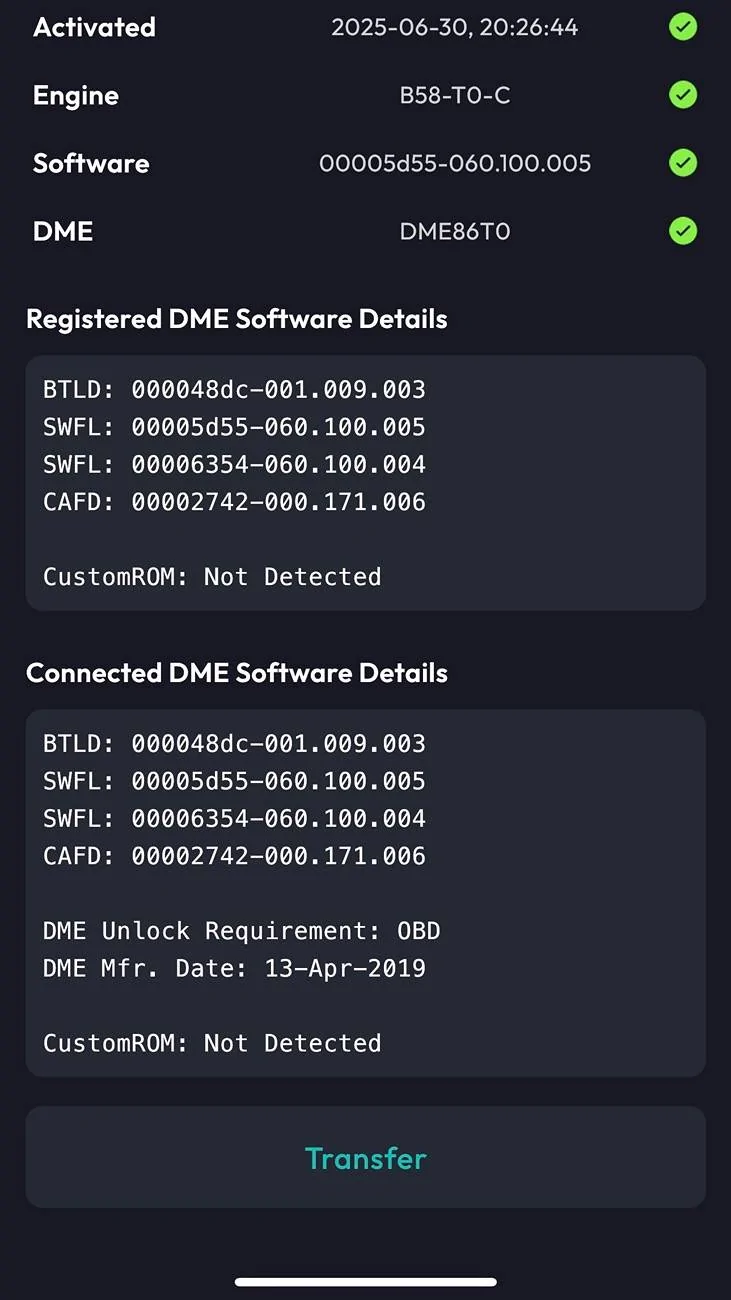

When you say you did a bench unlock, what system did you use? All of the unlocks can be different. Only some are compatible with BM3.
le.soupra
le.soupra
Jun 28, 2025
Not sure I let A90 shop do that whole thing and they only sell bm3 licenses from what I’ve seen on the site. I went to them since I’m local
But also I got curious and went to try map switching since I tried flashing a stage 2 multi, and it lets me switch between the maps and my burbles are different. I set aggression to max with duration on 2 sec for map 2. So idk if it partially flashed or if it actually flashed the ecu. I tried antilag but that didn’t seem to work unless I did it wrong
