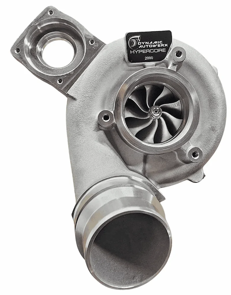

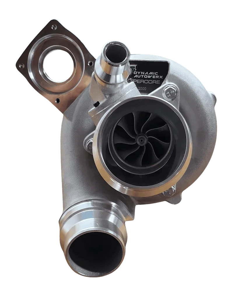

THE ALL NEW DAW HYPERCORE NOW AVAILABLE.
https://1fastsupra.com/products/bmw-supra-b58tu-gen-2-hypercore-turbocharger
With up to an additional 17% flow and size for only $1575.00 This is a no brainer! Very easy install as it drops right in where your stock turbo did without having to remove the manifold. This fits all B58 gen2 and all SUPRAS 2 ports and 6 ports.
Shoot me a DM if you have any questions.
Before you ask, yes we wont have an issue running these with JB4 or any tuning platform.
Truly is the nicest Supercore upgrade on the market With the highest overall quality guaranteed.

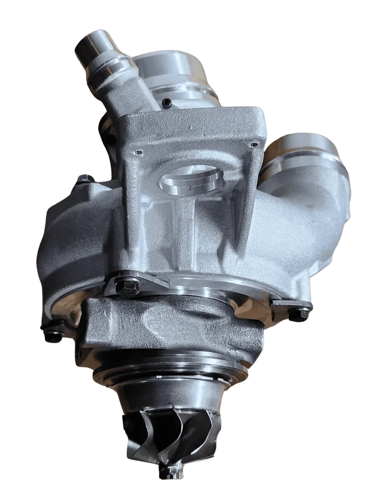

Wait, so you don’t have to completely remove the entire turbo system out of the car to install these?
If so, am I just losing it and thinking of something else or did people just remove the entire system for better access the stuff once off the car?
This is a larger core for the stock turbo. Very slightly larger. It's called a "stuffed turbo" because you're stuffing larger internals into the same turbo. The back half of the turbo stays bolted to the car, and you remove+replace the front half and the spinny bits. The spinny bits are called the cartridge. It's a slightly larger cartridge on the hot/exhaust side, which lets it flow more air. Nowhere near as much as a full turbo replacement with larger inlet and outlet, but it's something.
I get all that, I was just trying to clarify the install process because I’ve seen them done both ways (on the car vs off the car).
It sounds like everything is accessible to swap once you get the intake and charge pipe out of the way and unmount the EWG off the stock housing? All while leaving everything else on the car. Sounds simple enough tbh if that’s the case.
These also sound like a decent, economical solution for people who just want a 520ish whp 93 octane to 550ish whp E30/E40 street car and not have to worry about doing all of the other inevitable necessities (trans upgrade, cooling, port injection, etc) that come with getting the most out of a full turbo system.
Yes for this particular turbo it is that easy to install.
For other turbo setups they come with the manifold and you replace your oem one. Along with new turbo housings on the hot and cold side.
