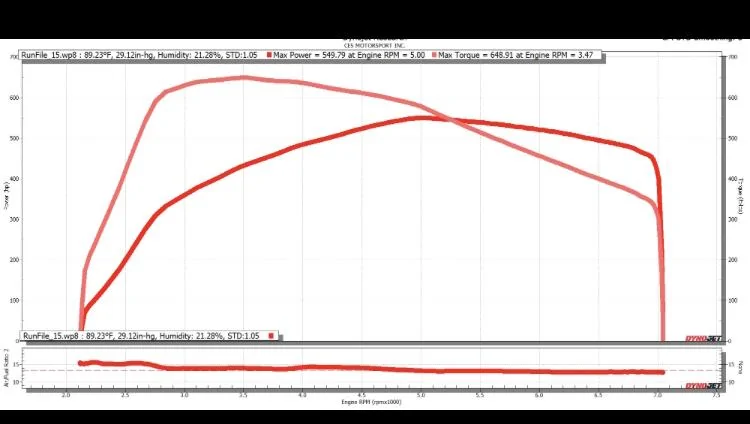

I have never seen a stock turbo reach 560whp. Could you send some examples? Max I've seen is 530whp with meth FBO.
My tuner tuned a supra on e50 and meth, no port injection and it made 559whp. here;s the link to the Instagram post:
