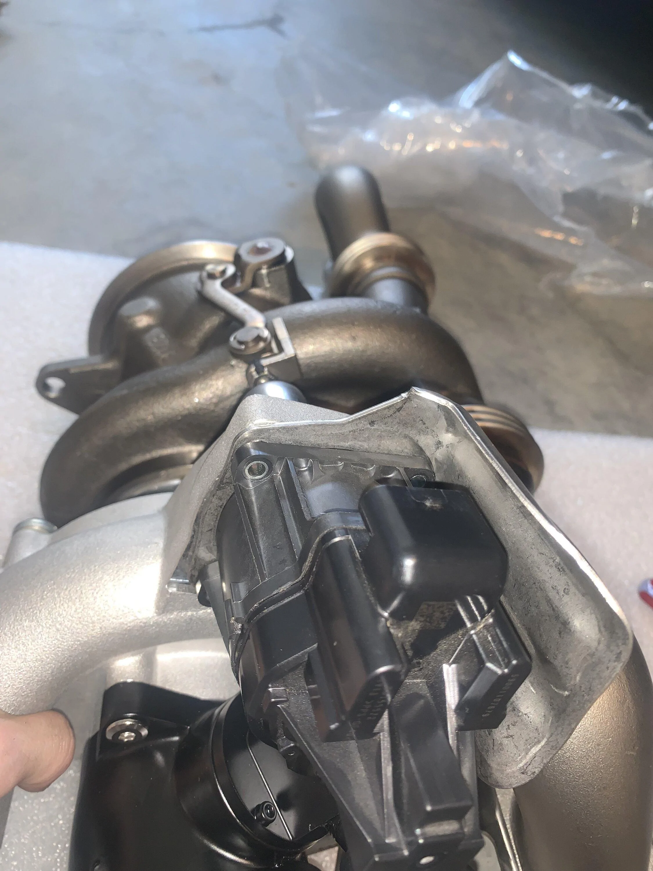

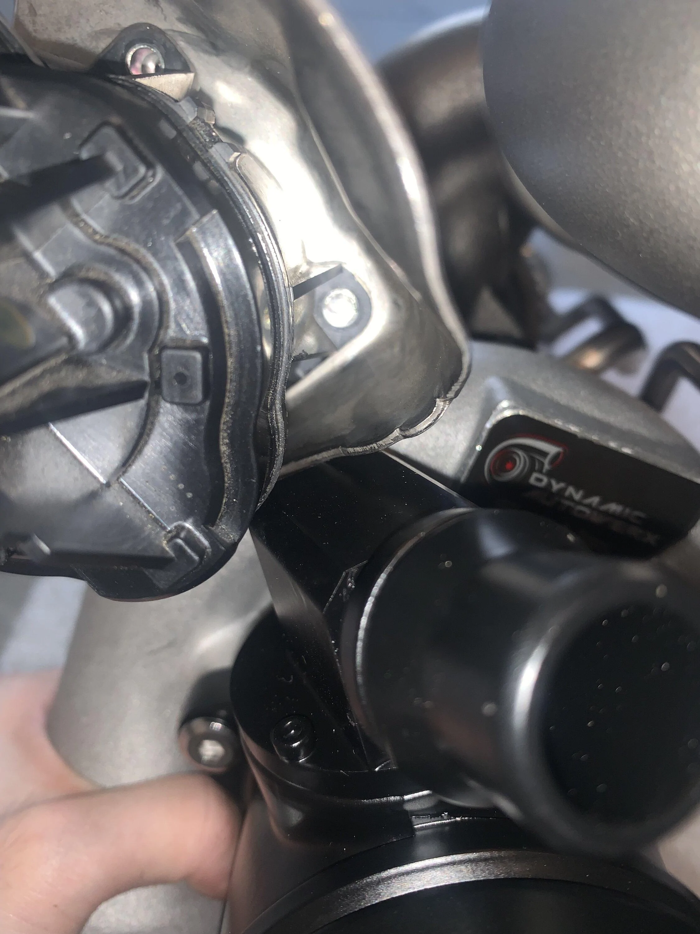

Would anyone mind putting me in the right direction? For the wastegate heat shield I cannot line it up without hitting this hose. Even if I line it up correctly, the hose does not line up. Anyone mind sharing pictures/advice? Thanks!

Most people just leave it off. Especially considering all 2020s didn't even come with one. I had a couple guys notch the shield as well to get it to go on.
Ultra flow Rs accommodate for it and fit.

So it would be best to take the heat shield off and just use the blanket that goes around it?

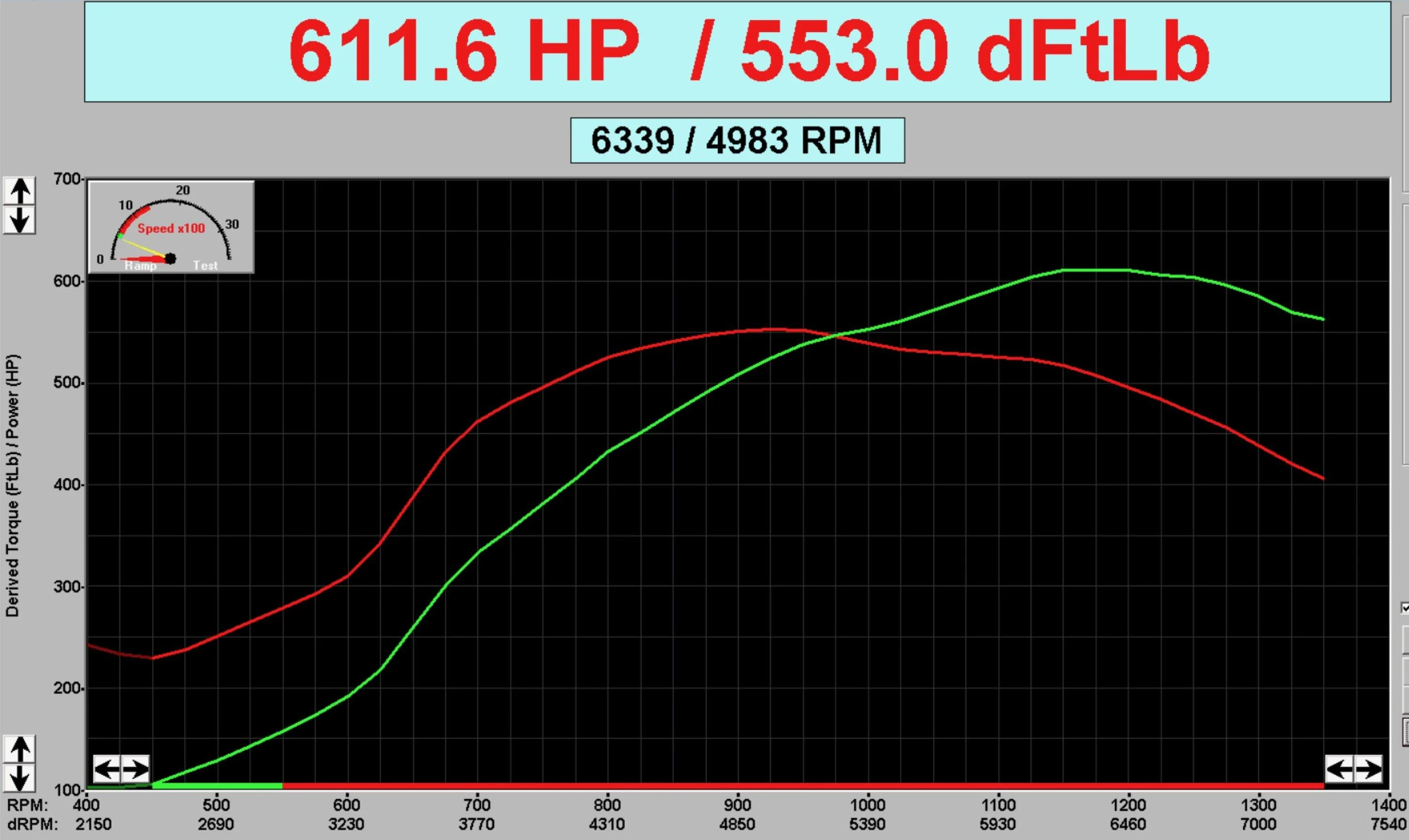

Hey Kyle, any update? Curious to see where the numbers are coming out... really want to see the curves too.
Just bought this same turbo and getting it installed soon.
I'm going with a upgraded hpfp cause have no plans to go over 650whp.
AMS said this is the most they can get out of it. 611hp on their hub dyno.
32.7psi
tune seems a bit unstable below 4k rpm. If you lift and try to get back on it below 4k it gets super jerky. Might try another tuner.
32.7psi

Was that on 93 or an E blend?
MS109. So about 104 octane. Probably similar results vs e85.
I do think that timing advance could be more aggressive than it currently is and boost could be reduced a bit to reduce possible surge.

What fueling mods? PI and lpfp?
Yes, AMS IM + 1050 injectors and CSG/Titan fuel system + surge tank.
Fueling isn’t getting taxed too hard though. Was making 570whp on DI
Definitely not fuel limited. If you’re looking for another tuner look up Bend Calibration. They do more circuit driven cars so they know how important throttle mapping is.
