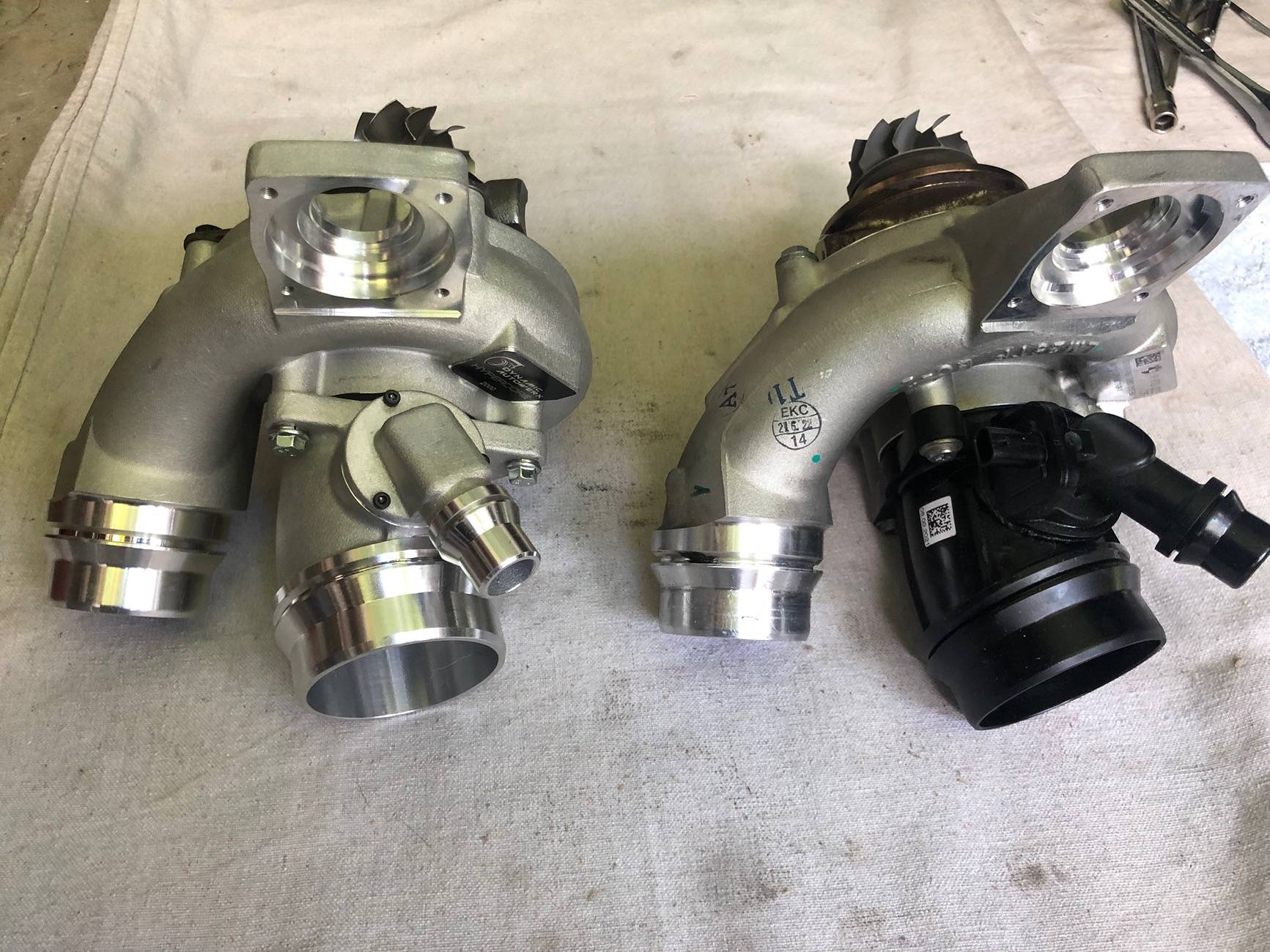

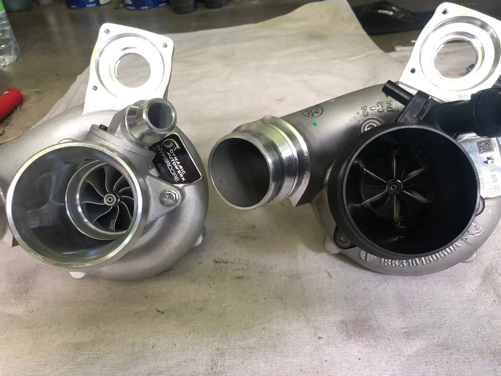

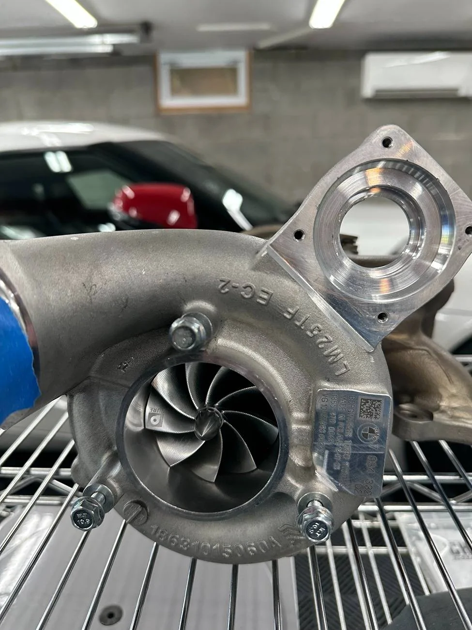

So here is a good visual on what changes with the hybrid turbos. The biggest change is boring out that "step" in the compressor housing to accomodate a larger turbo. The actual bore itself also gets machined a bit depending on how much larger a compressor wheel they put in. You can see, even with my "small" Pure 700, the step is gone and the whole inlet is bored out a little more.
OEM:
Pure700:
Bug2th

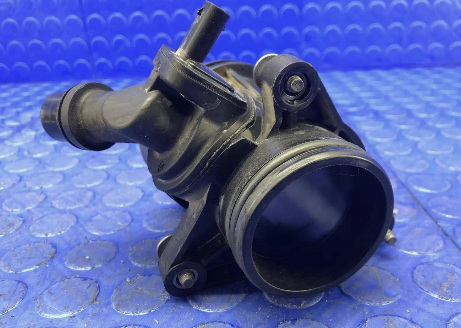

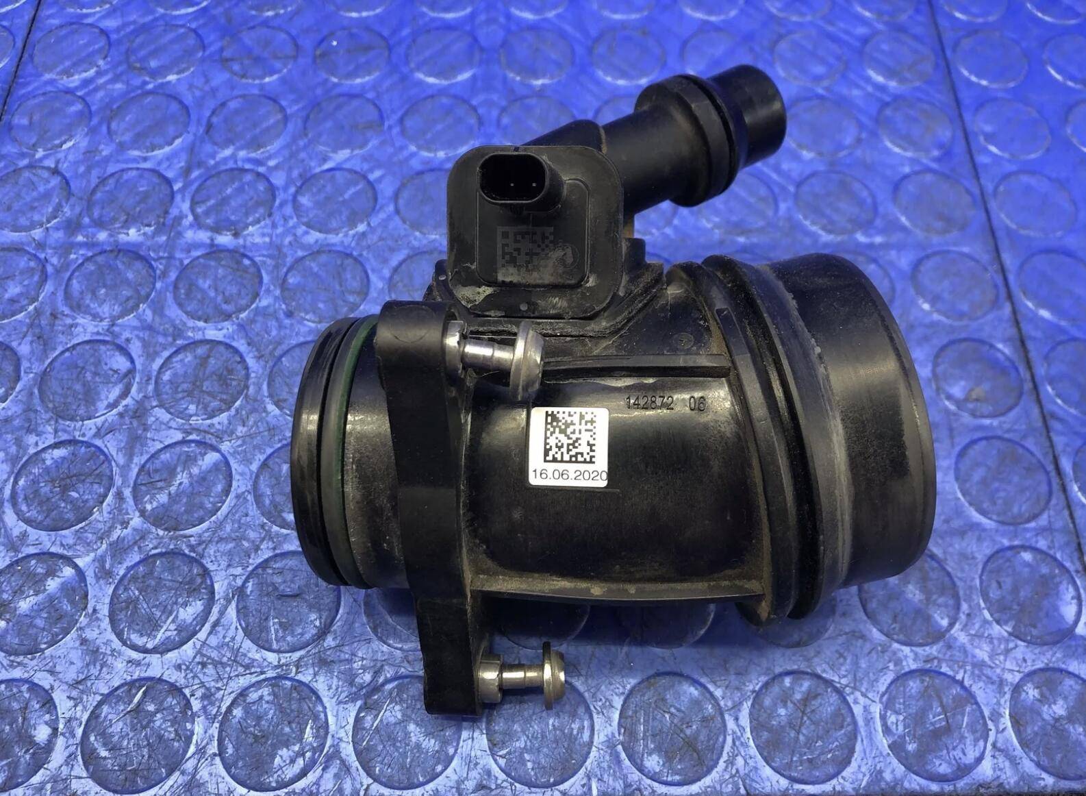

No, it's the heater, not the breather.
The crankcase heater is molded into the OEM inlet. You could MAYBE cut it out and figure out how to add it to an aftermarket inlet, but why? If you are upgrading your turbo, you should unlock your DME to actually take advantage of it and tune it properly anyway.

Sorry I meant can this piece be bored out to fit hybrid turbos?
8,698
17,044
You would need a way to seal it. On OEM compressor housing the green o-ring seals against the bore. Bored out hybrid turbos have a larger bore. If you also look, there is a slight step on the bolt flange. It's also probably deep enough that it could interfere with the larger compressor wheel.
Again, a lot of work for something that you should be tuning properly with an unlocked DME.
