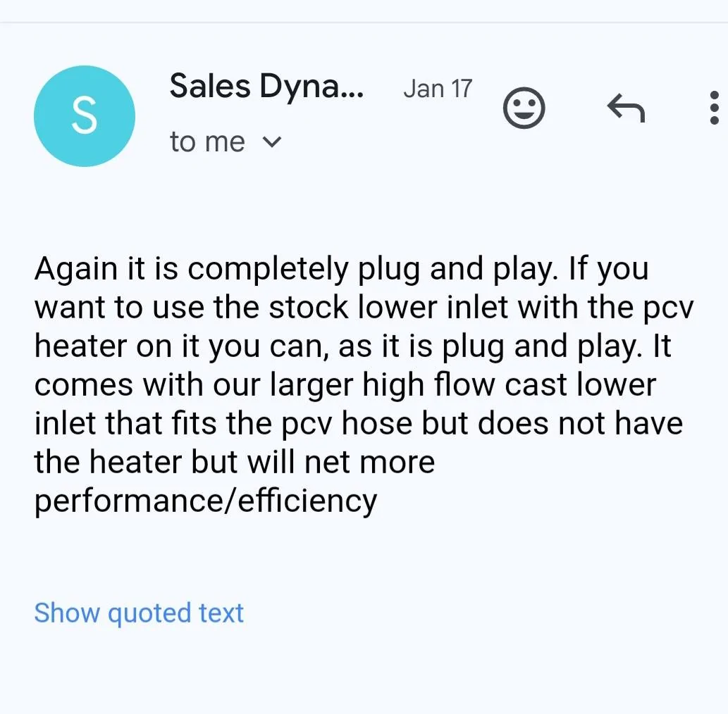

For what it's worth, I emailed DAW regarding the oem inlet since their website states: "......installs exactly like Oem, while retaining all Oem hardware". DAW response below.
It may not seem like a big deal to some but for those of us that live in a state and county requiring emissions inspections it would be helpful to be able to swap to oem inlet and set all emissions monitors without setting codes and pass testing then swap back.
I'm femto unlocked with MHD and I swap back to 93 oct, swap to oem downpipe, and flash to mhd ots stage 0 and select "oem downpipe" on checkbox. This will run the all the monitors and pass emissions, at least pass in the state of Missouri, by my personal experience. Or, if you have jb4 you can swap to oem inlet and not set codes.
Maybe someone who owns a daw hypercore can confirm that DAW is correct.
That’s what bugged me too. If one of the sensors no longer fits it is definitely NOT a direct oem plug and play.
Technically it would bolt on just fine, it just wouldn't seal and it would very much choke the flow. I would also worry about sucking in the o-ring with any boost since it is no longer sealing against the bore.
