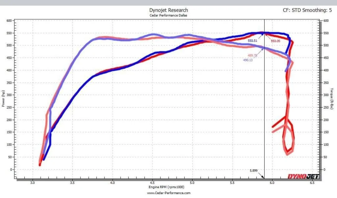

I emailed DAW and asked this exact question for the Flow Max and they sent over the chart below.
You can expect about 550 whp with a good custom tune, catless dp and stock fueling with 93 on a dynojet. With the previous version this was only possible on E30.
