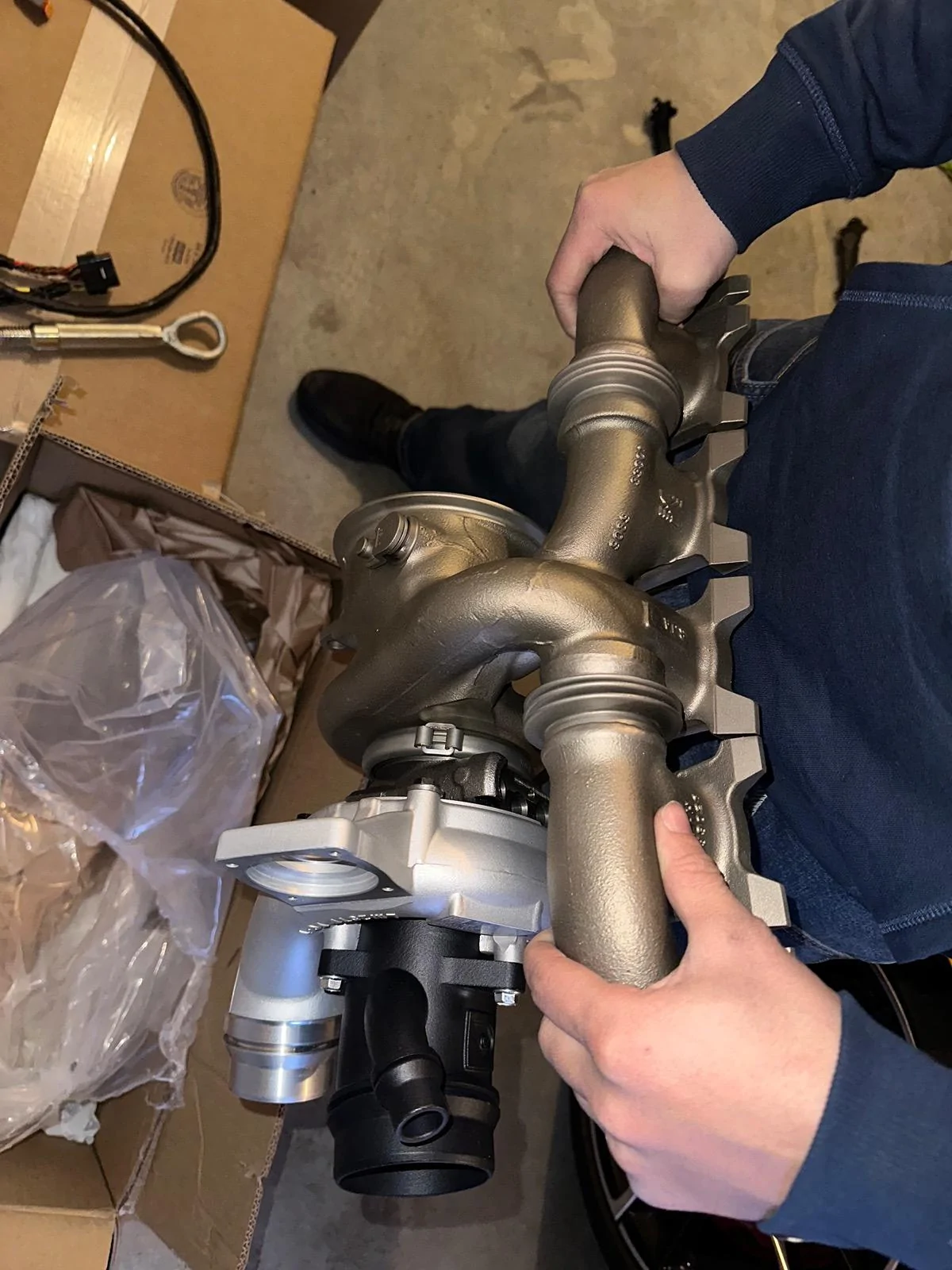

Will be installing the Pure 650 Friday and dynoing on Saturday. As the car sits I currently ran 10.5 @127 last season. I now have DSS axles and will have this turbo. Will update once I have a dyno sheet. Currently just downpipe and e50 tune on ecutek.

What's your 1/4 goal this season?
If this gets me into the 9s without fueling that would be awesome, but I might be asking too much.
Let’s us know asap on the 650!!! You’re the real hero this weekend bro!! ?
Did not dyno, beginning a street tune. Will post 60-130 when we finish the tune and upload a dyno sheet when we get there, may next weekend

Jrob, any performance feedback on the turbo?
Spool down low feels very comparable stock, after 5k and 100mph the car pulls a lot stronger. We're still dialing in the tune, and only on e30 at the moment. When I get the e50 tune done will post 60-130 and a dyno sheet.
