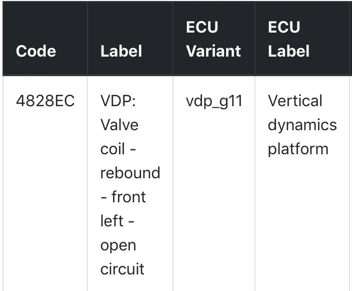

update on this... so was able to read the code. seems like one of the front left sensors:
nothing seems disconnected, so I guess somehow damaged.

Did you install the cancellation kit?
Following - We had this message with the install of the KW Suspension. We installed the KW Electonic dampening Cancelation kit and have had ZERO issues since - Wheels are coming soon, I would assume if you have the correct TPMS Sensor nothing would be an issue.

Hi Everyone,
We experienced this on our MKV's.
If you have different wheels and tires you can simply re calibrate through iDrive.
You will be able to select your new wheel size. Here you will see the option "Other".
Select "Other" and drive the car around per the instructions via iDrive till the car re-learns.
It will also re-learn tire pressure so make sure you have that corrected to your desired tire pressure as well.
Our MKV with the KW V3's and EDC kit had no issues at all.
Hope this helps as it did resolve the dash lights we had with our springs/ wheels and tires!
