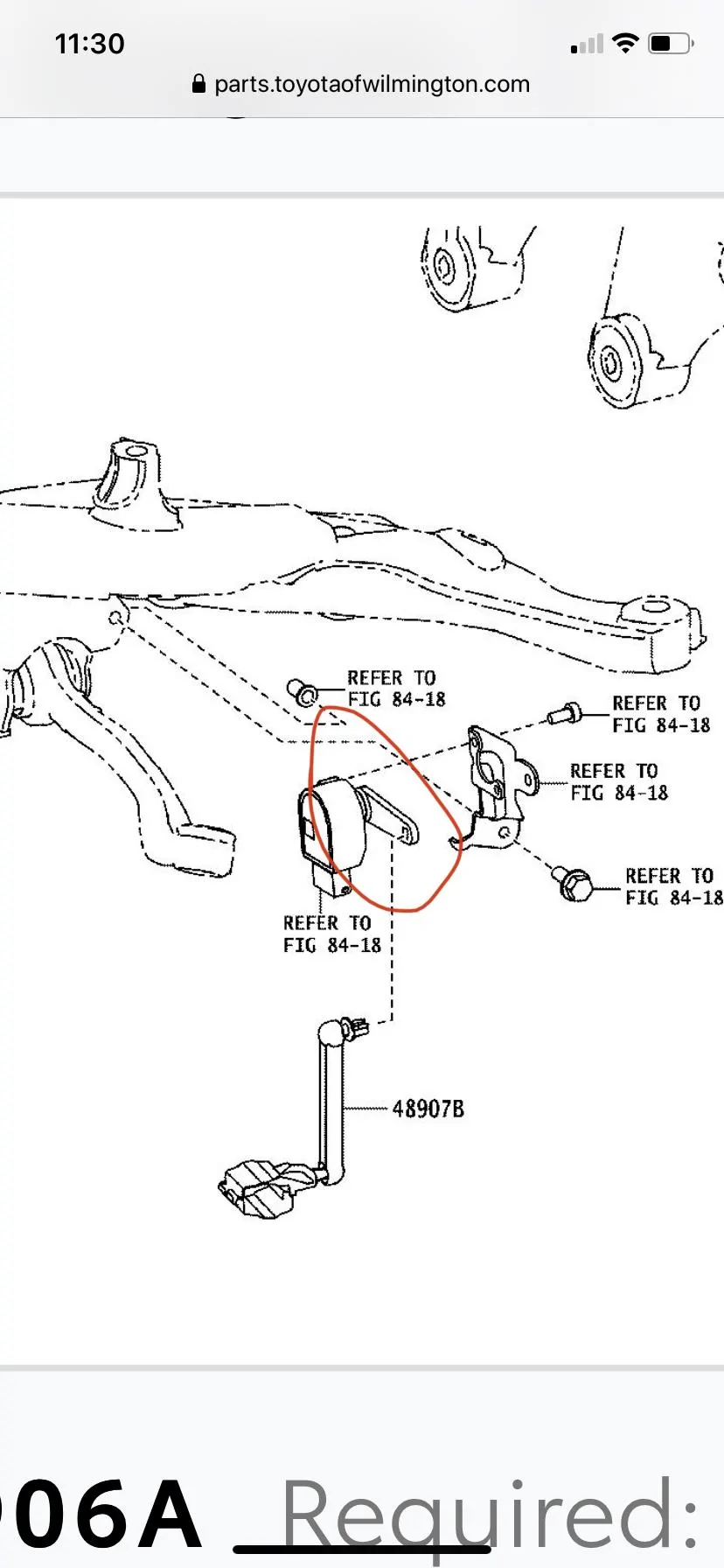

Hey everyone, first post on the forum, but been following for a while... not sure if this has been discussed, but when installing 20” wheels/tires and lowering springs, the A90 pops up tire size and chassis messages. I’m sure the guys at Titan and Induction have seen it. Is this some we can clear/set ourselves? Any input is very appreciated!

Are you still having this problem ? I had the same problem. I know exactly what it might be. My mechanic fixed it for free. But the dealer will charge you an arm and a leg to fix it. And it’s a super easy fix.

Hey, there has been a few things that cause this... some have had damaged wheel acceleration sensors, or level sensors. In my case, it was a damaged dampener harness. Are you able to read the codes?

No I didn’t read the code. My mechanic took a look under the car and saw that the leveling sensor was misaligned when the car was lowered or when it went down from the lift

that’ll do it! i think this is the most common reason for the error after a spring install
