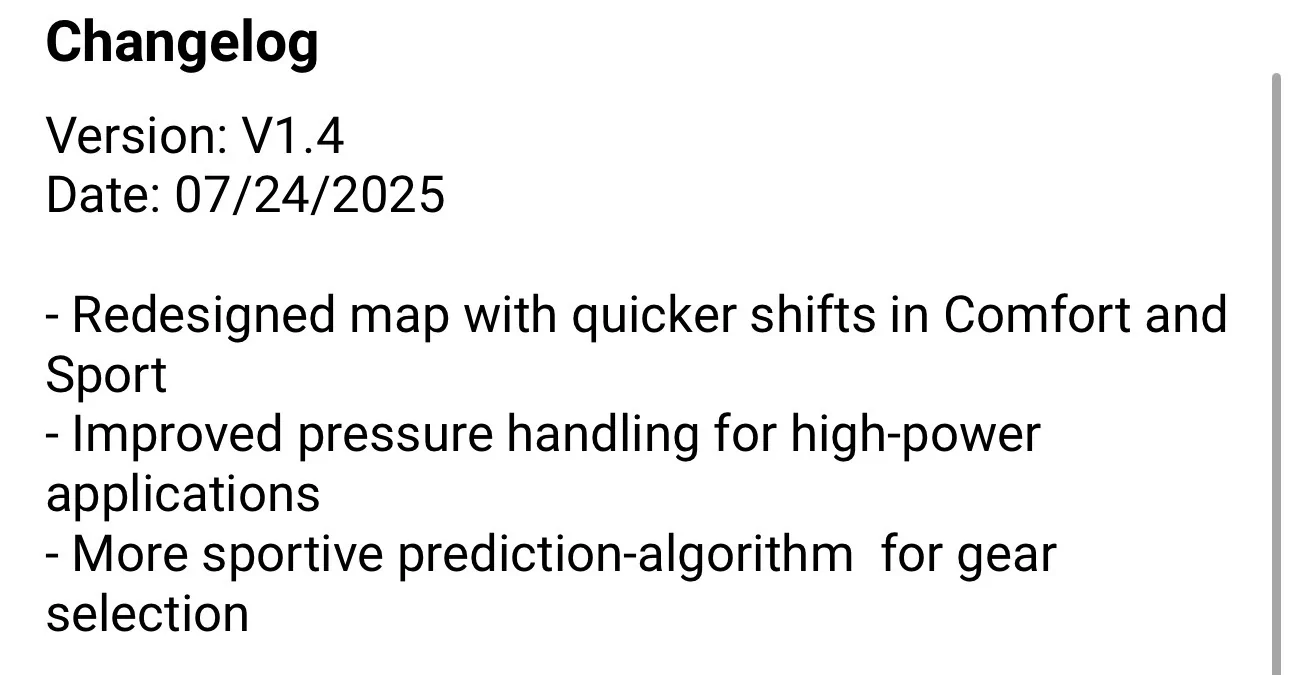

new XHP stage 3 update

After having the new update on for a couple days I can also confirm the 1.4 map is definitely spicier in sport, even when you aren't at WOT. In both auto and manual mode the upshifts are more aggressive. I noticed a difference in normal/comfort shifts as well, also seems to let the rpms go a bit higher than before when driving normally before upshifting.

I installed the update about 2 weeks ago and decided to try stage 3 and actually like that better over stage 2 for daily in non sport mode. Sport mode when you get on it definitely shifts at higher rpm’s (like at 7k) and downshifts faster during braking. I don’t feel like it shifts too hard though - just quick and positive.
