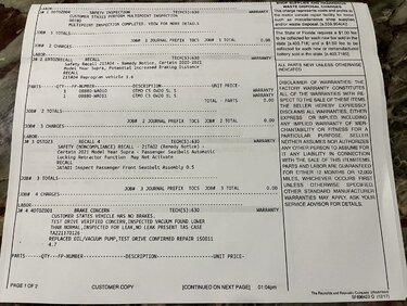

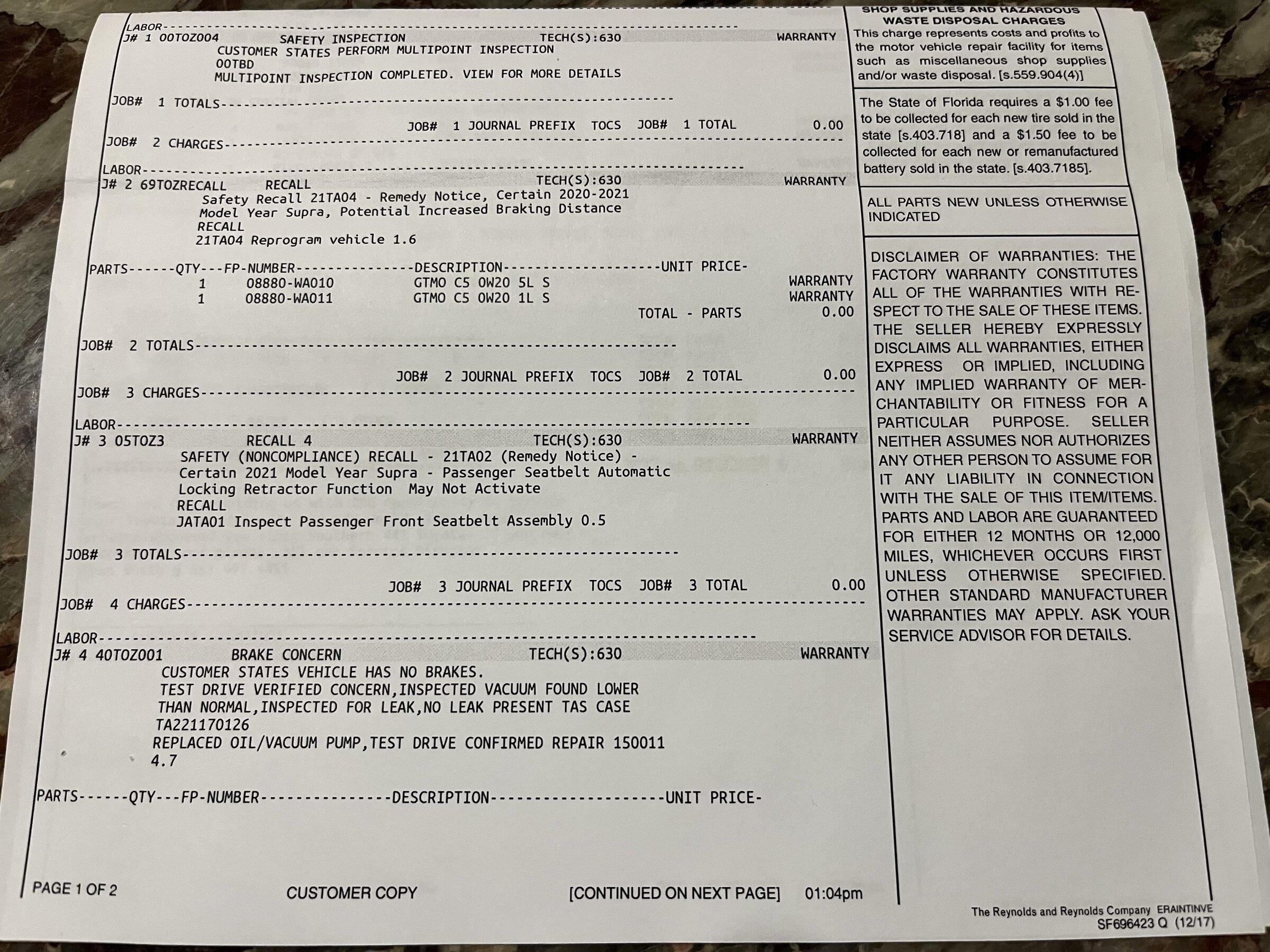

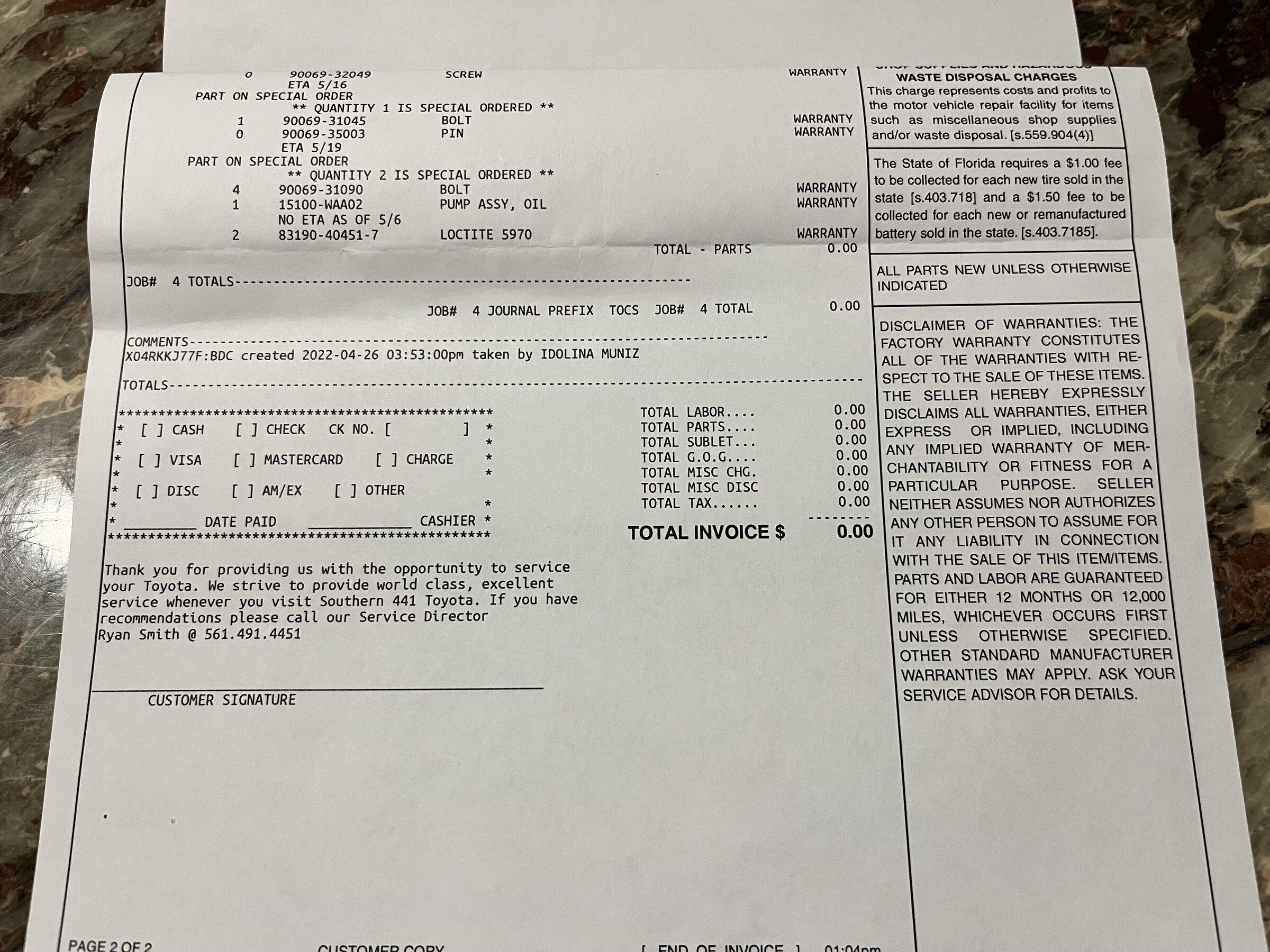

Got the car back the other day, took them a little of 3 weeks to get it repaired.
Part was sourced from another dealer and was send over the slowest way possible to West Palm Beach... Imagine if the part needed to come from overseas...
All is well, car brakes again lol, update went great and full Apple CarPlay, OEM navigation works too.
Had to redo all Bimmercode and set presets.
