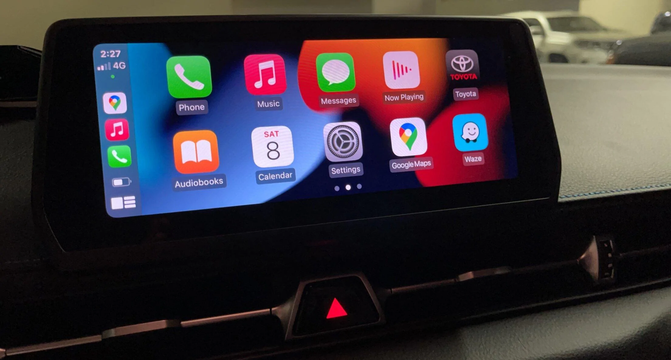

I had the recall done yesterday at dealership .
I-level S18T-21-07-519
After the recall the navigation stop working
also we don’t have here CarPlay from factory, I enable it with a code I bought from a site ,
I have now full screen CarPlay and it fixed my navigation somehow
