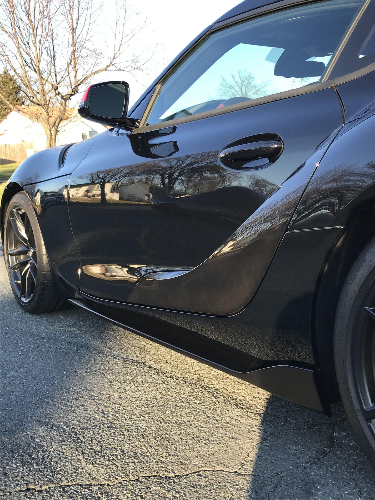

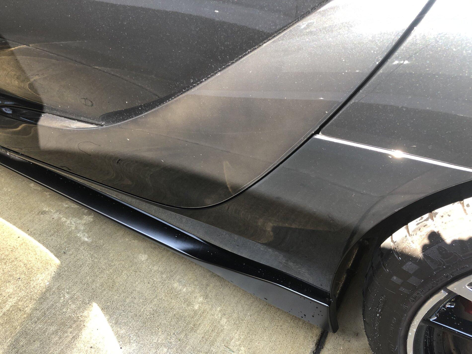

Finally got around doing a single step polish in the car months after. Since Toyota said my paint defect is “Normal”
Now it sticks out like a sore thumb. This is definitely not normal at all
Quick question? How did the dealership sell that to you without noticing it? It's clear as hell in the light.
Why would the dealership care? If it's manufacturer's defect then after the sale it's the manufacturer's problem not theirs.
They'd sell you a car even if they dented/scratch it while parking.. they'd just park it close to a wall so you can't see it.. (true story from a long time ago).

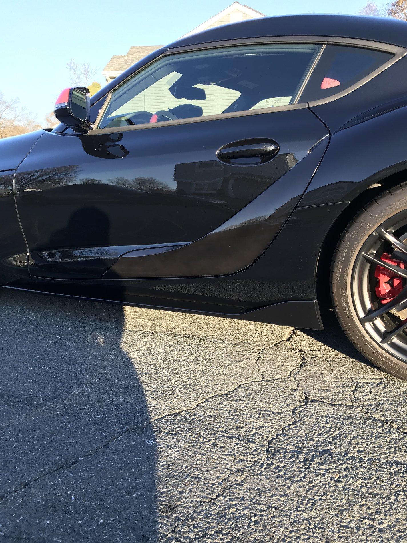

UPDATE:
This is for anyone looking at this thread related to the paint issue on your door garnish pieces or rockers on Nocturnal Paint. I am writing this post because I have been getting some questions from fellow forum members. Please read below.
If you noticed the paint issue on your car like the pictures in this thread, you cam to the right place. The very first step for you to do is to make an appointment at your local Toyota dealership. With any issue related to your car, you will need to address that at your Service Appointment first to get the process started. The dealer will probably tell you that a Field Engineer will need to take a look at your vehicle. From what I have been told, there is only 1 Field Engineer per Region. So you will most likely have to make another appointment to drop off your car on the day the Field Engineer comes out. Here is where it could either be easy or hard. It will depend on your Field Engineer's decision. If he is good at his job, he will see the paint issue and grant the warranty work to get it right. If he deems the issue "Normal" then unfortunately it will drag out the process. Toyota should be aware of this issue by now, but who knows. If you are in the situation where Toyota deemed the issue "Normal" then send me a PM please. I will help you with getting the issue resolved. But hopefully you don't have to go through the process I did.

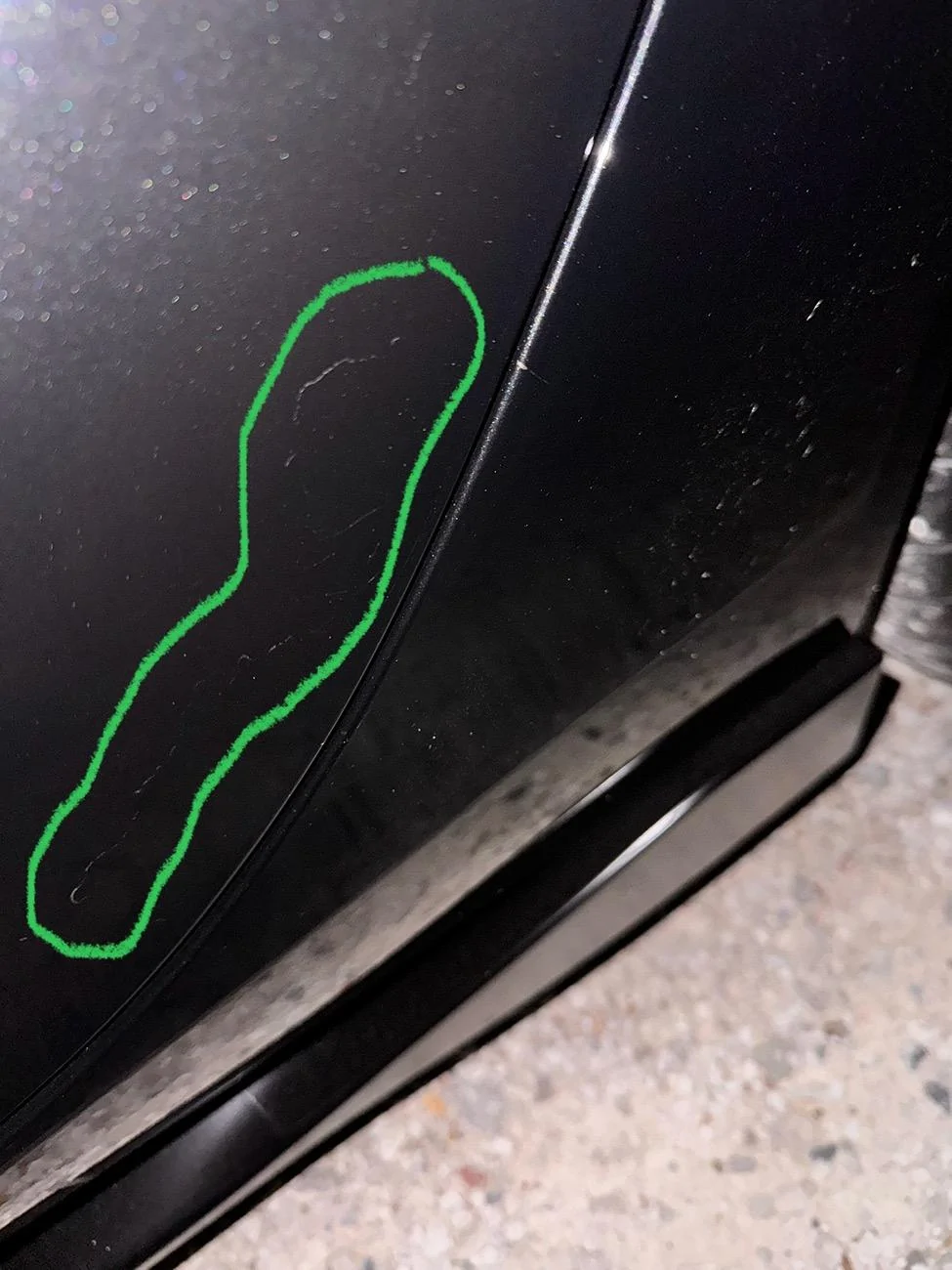

I discovered this yesterday after doing my first proper detail, hard to snap pictures at night. While it’s not the same issue the OP described, it’s on the same door trim piece, seems years later they still suck at painting it. Does this look like a paint / clearcoat issue? Not really sure how to describe it but it doesn’t wipe off with gentle or even moderate pressure

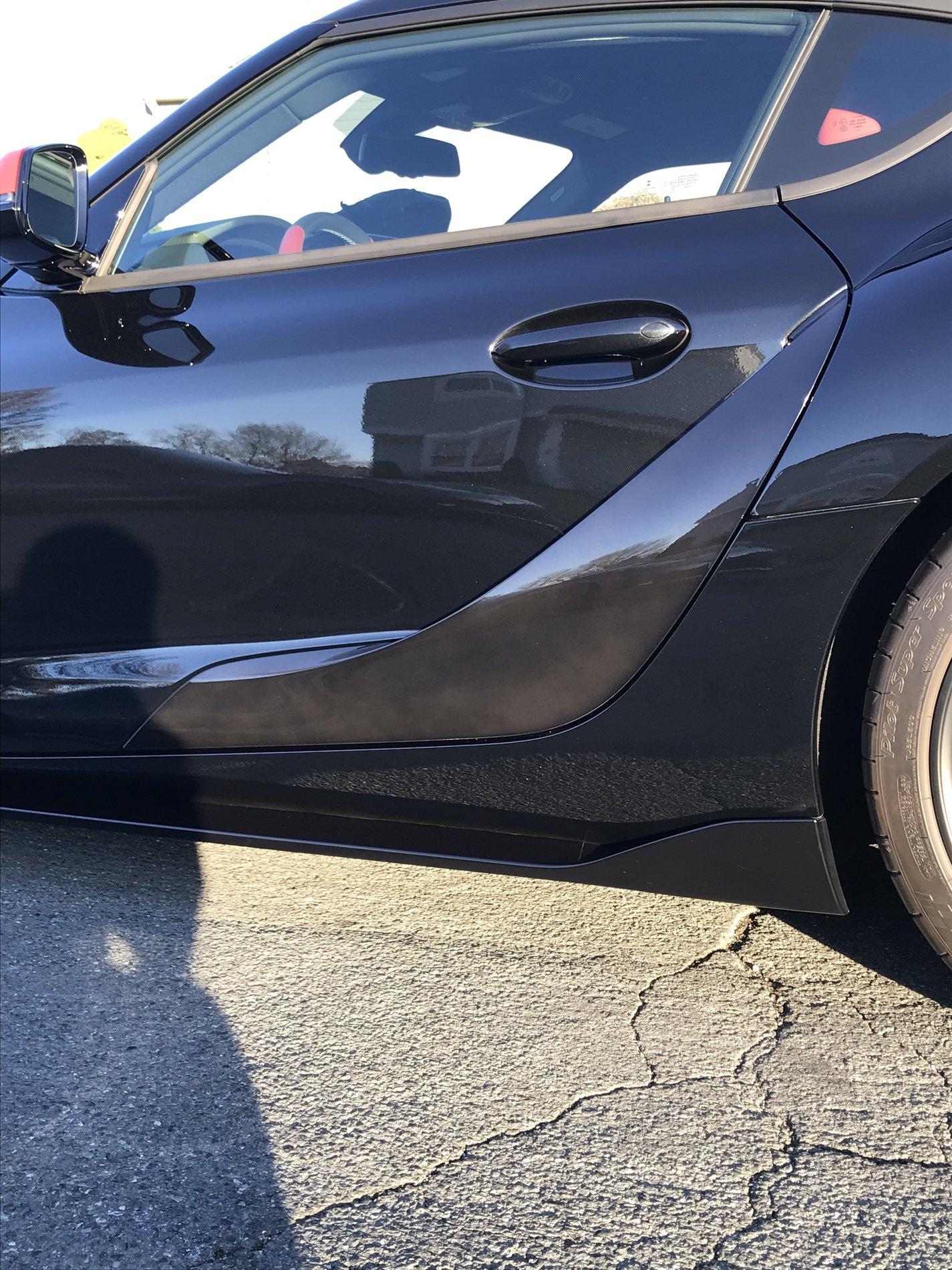

I noticed the paint coverage on my door garnish isn’t great when I was using an LED light while applying my ceramic coating last year. It’s definitely light in some areas of the garnish, like it didn’t get sprayed fully and has a fade effect to it. Only noticeable with an LED light at certain angles but I can’t notice it in direct sunlight from any angles. It bothered me at first but I eventually forgot about it. Then I saw this thread pop up again and it reminded me. Dang it. Haha
