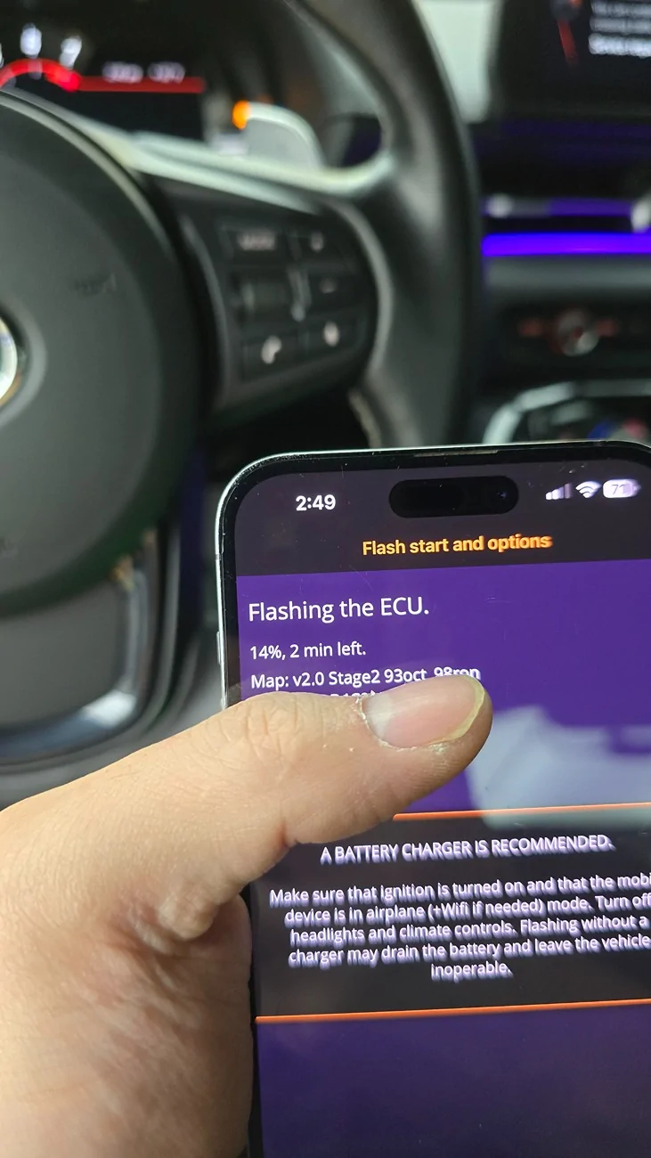

Remote start in stock tune with cold start
Remote start after flashing MHD tune & XHP tune
Few issues
- features of MHD+ like multimaps switching isn't there and you can't do any live adjustments either.
- exhaust flap stays open all the time. its supposed to stay closed in normal mode which is default.

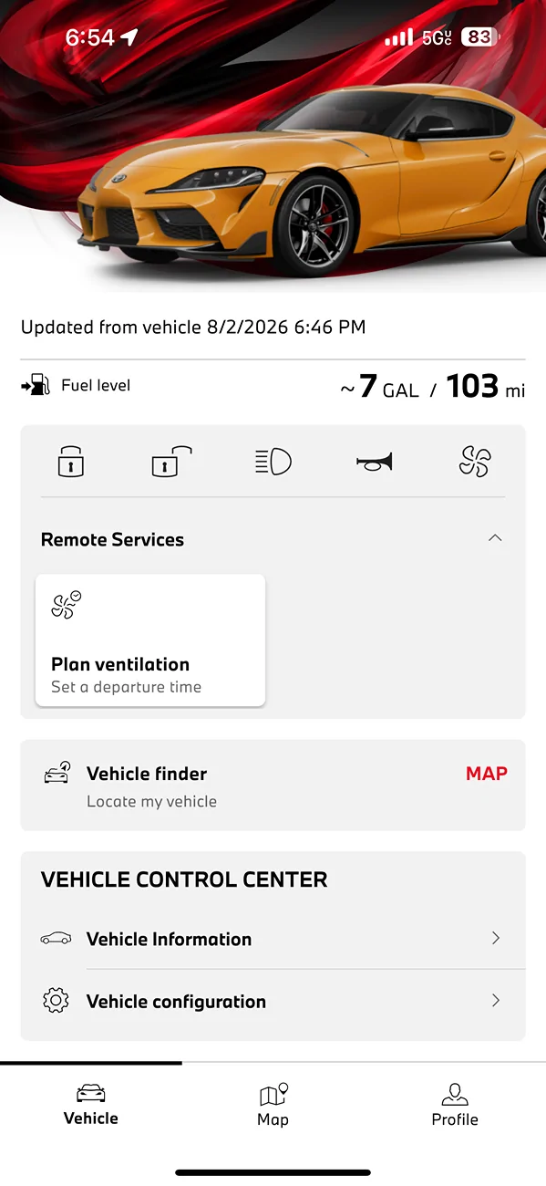

-The remote start option doesn't show up on the supra app.
- Car sounds a tad louder than before in sport mode, during upshifting/downshifting.

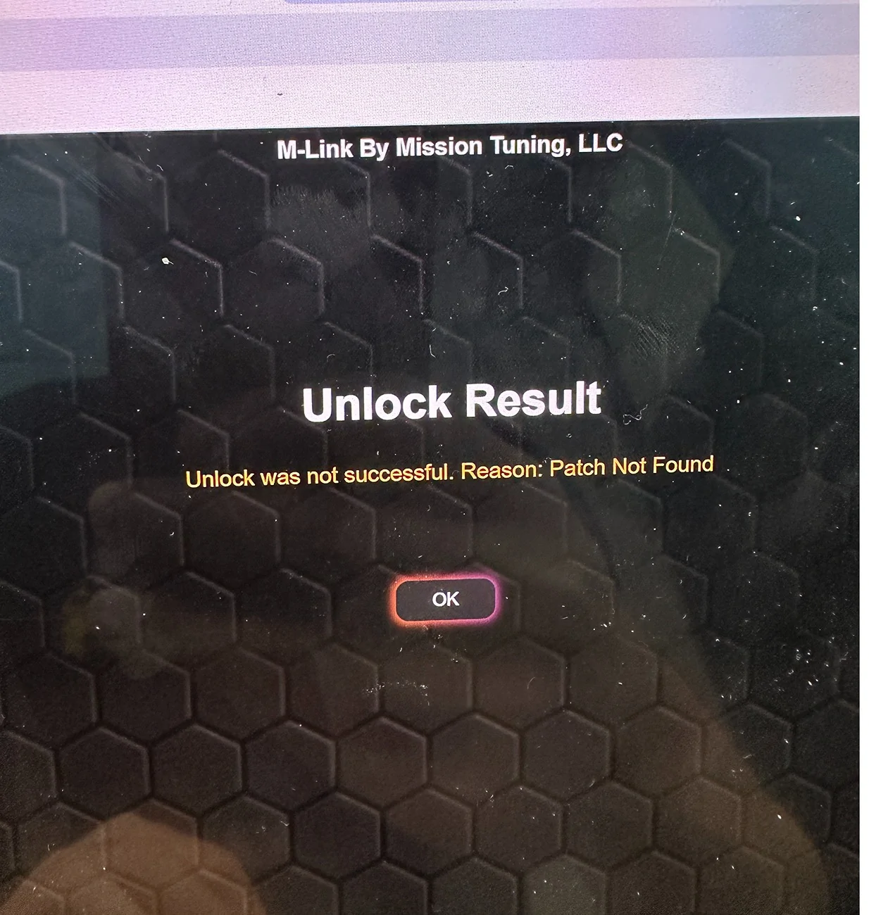

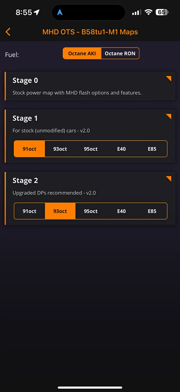

I tried to unlock with mission tuning tool and it was unsuccessful so I thought maybe I didn't lose my unlock after the remote start coding so I proceed to flash MHD and it flashed the OTS 93 map successfully.
I don't know if using an mhd unlocker will fix the issues I have. They told me to contact MHD about this but I highly doubt they want to deal with it lol.
I'm thinking of flashing my backup DME into the car

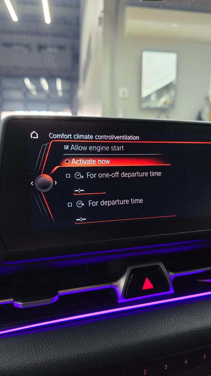

As for the app - you just use ventilate option. That behaves as remote start.
Few issues
- multimaps switching isn't there and you can't do any live adjustments either.
Thanks for sharing your experience. I am still trying to get my hands on the MHD Unlocker tool. I will also report back if I have any better luck.

Gotcha, I will play around with the ventilation options in the supra app. I reached out to MHD so I will hear what they will say.
