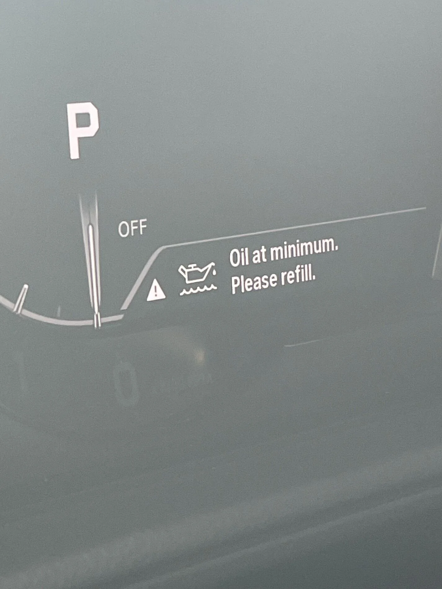

Got a late 2020 built. oem oil 0w20.
At 2700 km i had my first oil change. after about 10,000 km / 6200 miles i had my first message to refill 1 liter.
now after about 3000 km / 1850 miles my oil was full. today there was about 200 km / 125 miles and around an hour full throttle on the german autobahn with almost continuous 250kmh / 155 mph.
now the bar is half filled... i don't know how to rate this. is it ok if it consumes oil at such high speeds or not? i also don't know how much of a statement a half bar has. because maybe the other half will last much longer.

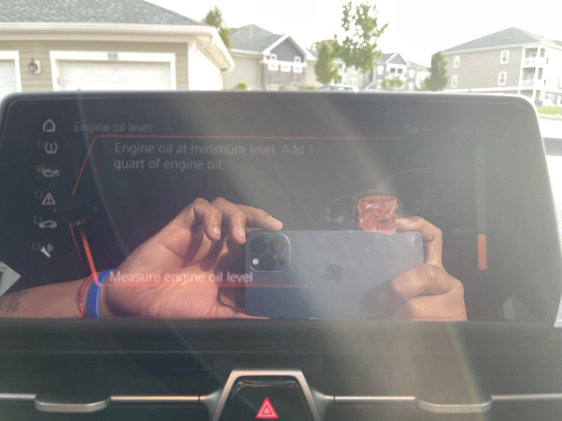

This what happen after 14 days first oil change was at 3,090 miles currently have 4317 driven 1227 miles called the dealership bringing it in tmm. Hope i dont have anything major will keep you guys posted

Just got back from the dealership stated that it was just a quart low did not find anything toped it off and they said to come back in 1k miles to inspect again and see where the oil sits

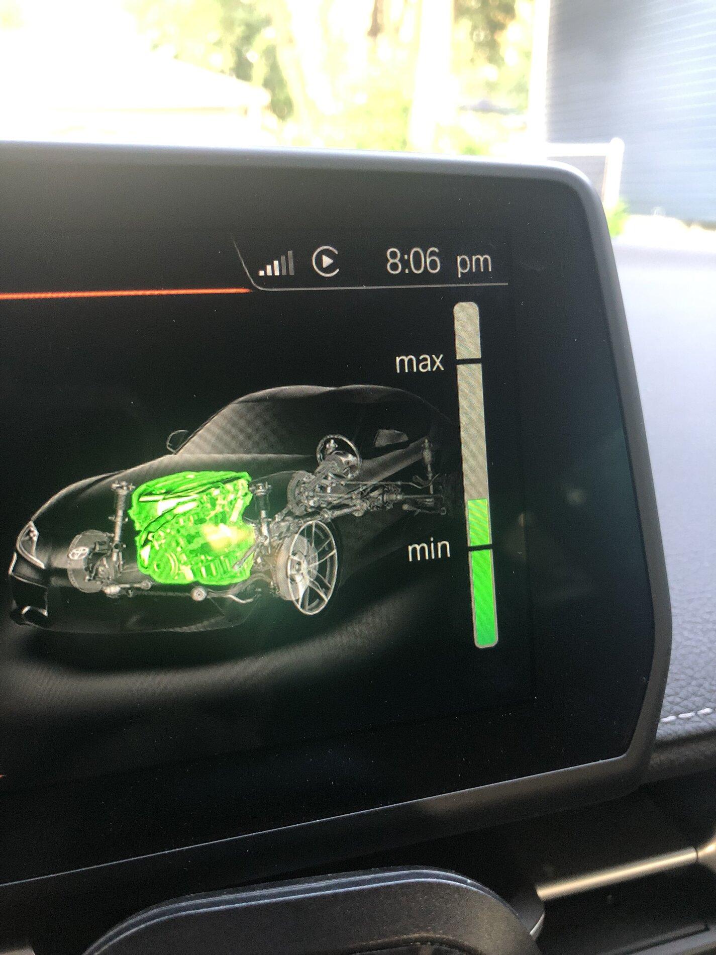

Guess I’m not out of the woods yet. Though it was all going well after my last oil change.
1500 miles later and I get this. Dropped to halfway.

125 miles @155mph ? ? Yes you will consume oil. I would say your case is perfectly normal if not exceptional under that load.
-RJM
Don Alex
Aug 19, 2020
78
56
Germany
Supra 3.0 Premium
-RJM
Phew, sounds good! Yes it was a lot of fun, german autobahn makes it possible. :bow: After that ride I was totally tired.
The first time was the message after 9000 miles, I think so far it fits.
Thank you very much for your reply!
